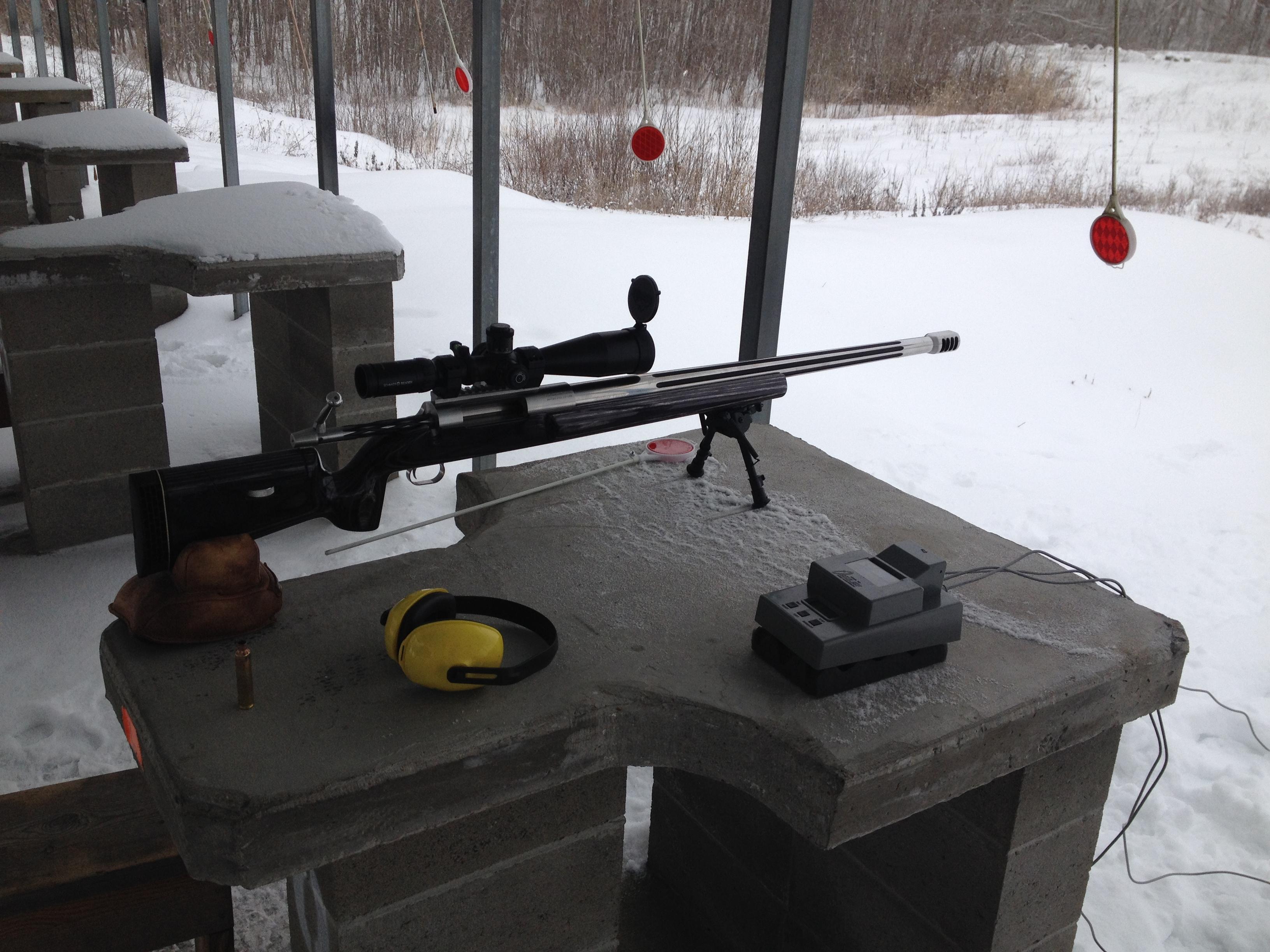

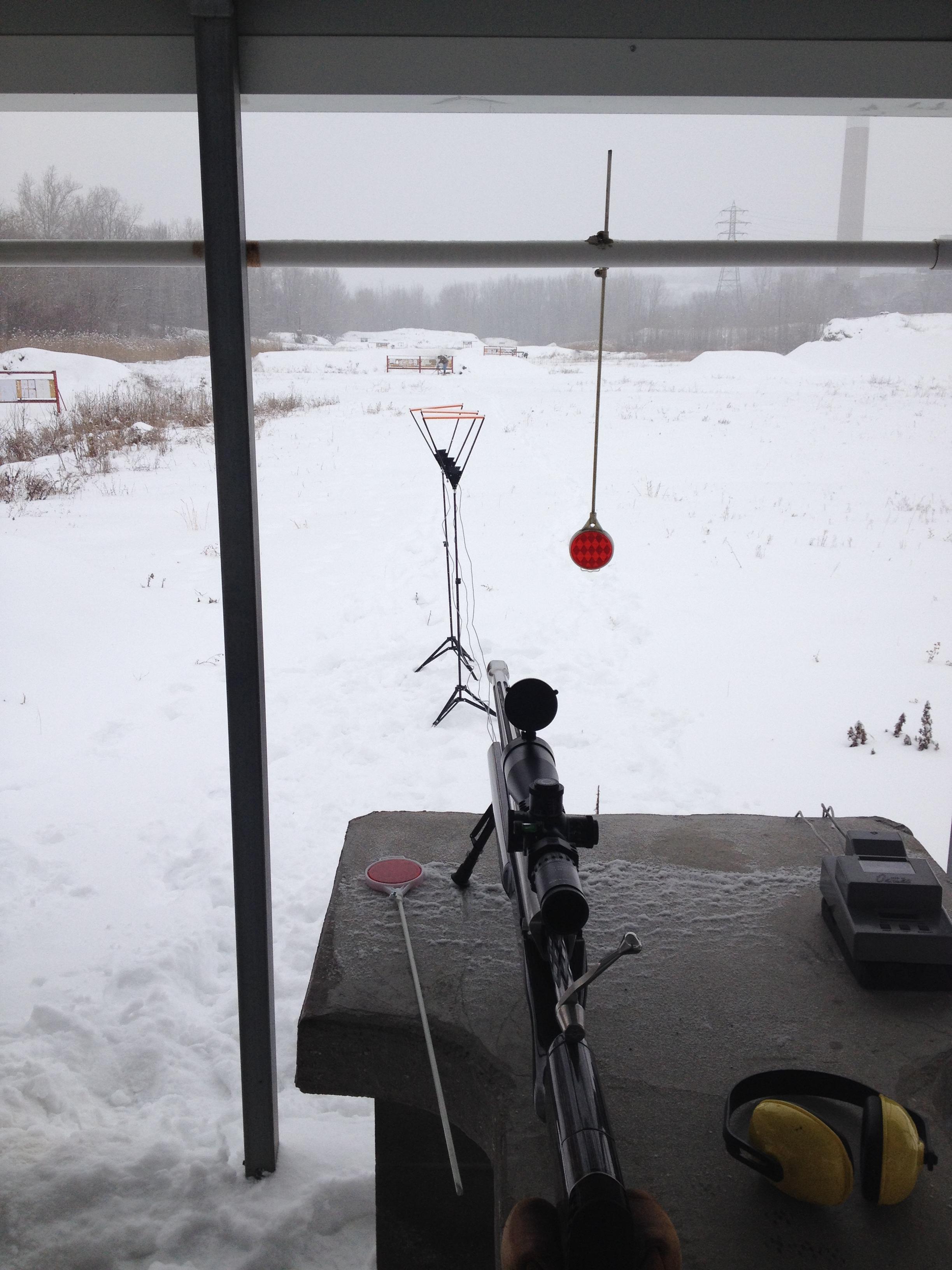

Did some testing of a solid today... @ 1k.
"Would there be any use in running these through a 1:9.4 (conventional rifling) in the mid 3000... as far as gaining useful information?"...
John, yes there would! Email me information on the loading that you have in mind.

Lowlight, Did you set the sensitivity on the MagnetoSpeed for solids. And.........................You really need a wireless cam set up. I can't afford the gas running back and forth at a mile.
Great testing.
The solids were fine over the magnetoSpeed, I didn't need to adjust anything. They are not the brass based like ones that cause an issue. Lots of copper to read. My load was just conservative. Which with more ammo I can push it harder.
I have a target camera, just didn't bring it, but will use it moving forward. Plus I just left my diesel running it gets 700 miles to a tank, and burns practically nothing at idle.

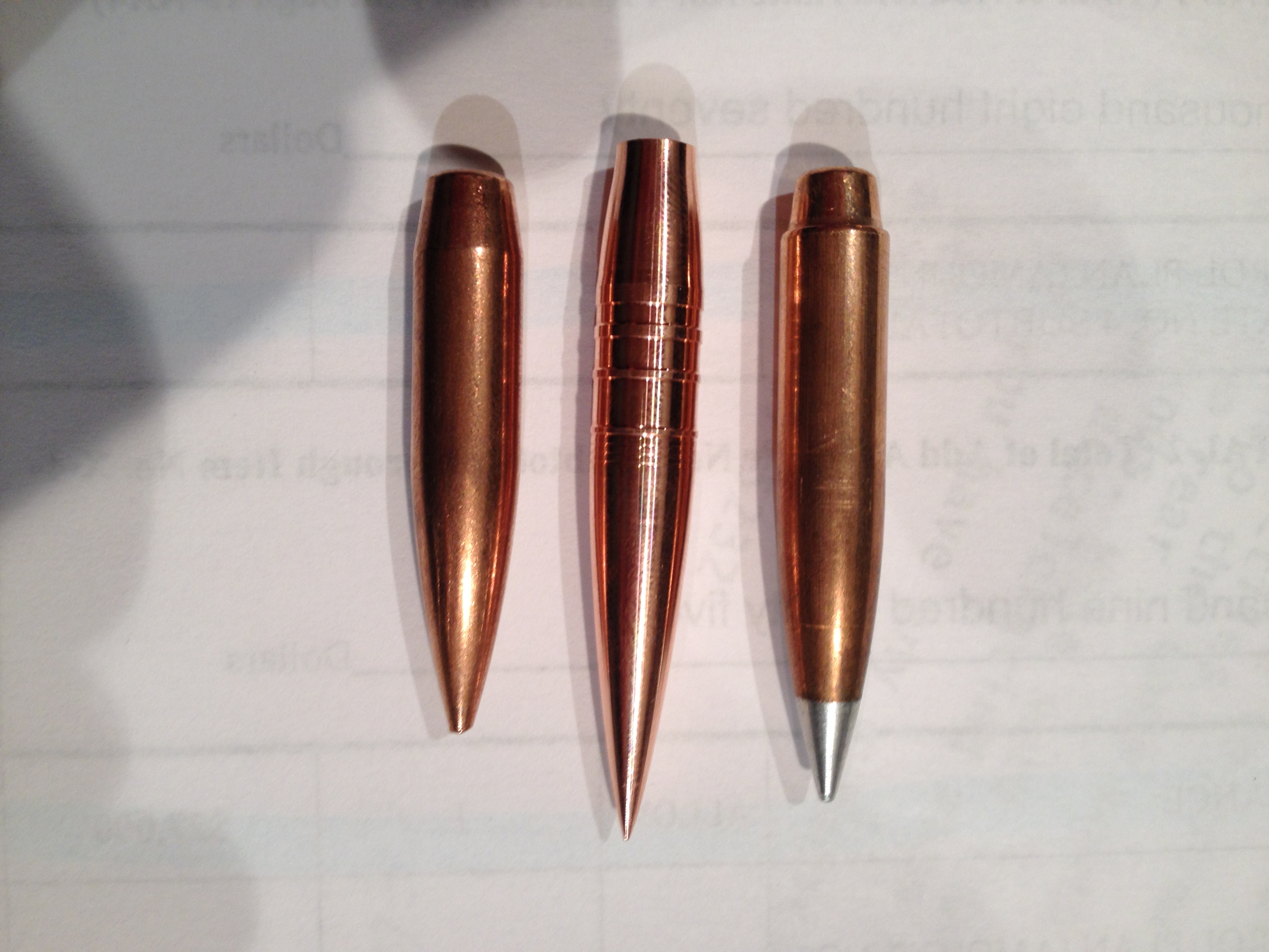

Beginning today, ZA will take orders on an initial production run of 338 barrels designed soley for use with the ZA338/6.4-M projectile.
Specifications ZA Barrel :
- 416R
- Eighteen-groove proprietary variable geometry
- Left-hand twist
- 30" finish length
- Single-point cut rifled
- Guaranteed sub-half MOA
Specifications Projectile ZA338/6.4-M :
- 295 grains
- G1 0.90 @ 2,700 fps
- Add ~150 fps MV to ZA as compared to 300 grain jacketed-projectile loaded at equivalent chamber pressure
- Available in hollow-point

Some notifications are in order; It is potentially dangerous to fire a conventional projectile through this barrel's rifling geometry, as the high rpm creates a distinct possibility of copper-jacketed projectile disintegration in the muzzle brake. To partially guard against hazardous experimentation, the bore diameter of the ZA 338 is exactly 0.338" (rather than .330"). This will impart little, or no, spin to a conventional bullet. All ZA barrels will be installed by designated smiths, with the ZA logo engraved on the finished contour, and all necessary warnings against inappropriate use. Existing muzzle brakes are compatible with the ZA system. I will be in Las Vegas through Saturday, the 18th, if you are attending SHOT and would like to meet for any reason. Prior to that it will be difficult to communicate except by email, or PMs, which I will answer in the evenings.
I should also amend Frank's earlier photo post by saying that the projectile being made available for sale is not the one pictured. That is a two-year old design which was optimized for conventional rifling. If close attention is given to his photos, a white residue is visible on the case neck, and projectile ogive. This is trace of a ceramic lubricant formulated to protect the throat from heat-erosion. In the Bradley mounted 25mm chain-gun, the lubricant extended barrel life by a factor of 50. I do not know what the ZA barrel life will be when cartridges are consistently seated utilizing the ZA bore lube, but it should be a significant improvement over the typical 2,000 rounds of accurate life. There is also a side benefit of low, single digit, ES.
Best,
Noel Carlson
Great to see another option for ELR on the table! just a little confused by this section though, it seems to contradict itself. Can you please elaborate?
how can it impart little to no spin on a conventional bullet and also spin them fast enough to disintegrate?
Buster B,
"how can it impart little to no spin on a conventional bullet and also spin them fast enough to disintegrate?"...
The redimensioning will keep major brand bullet manufacturers safe, but there are a handful of custom bullet makers that might decide to chase the bore/groove dimensions with experimental dies... I want to make an unlikely problem still less probable.

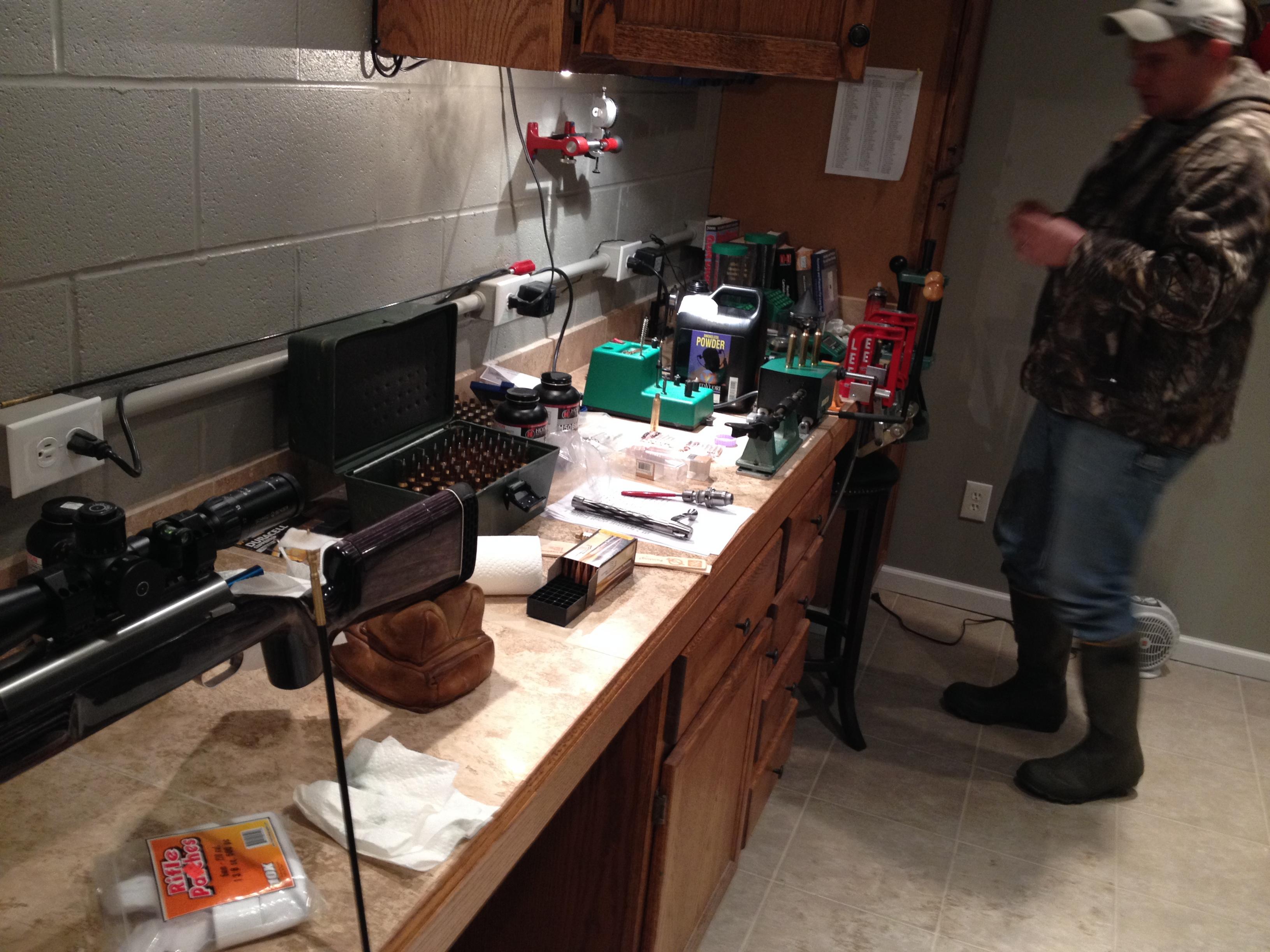

Noel has asked me to post a video showing the paste being applied to the driving bands.
So here is a short little loading video I did yesterday. I am looking for a max load and 92.0gr is a compressed load but I will try it to see what the velocity is, however it's hot so don't repeat it.

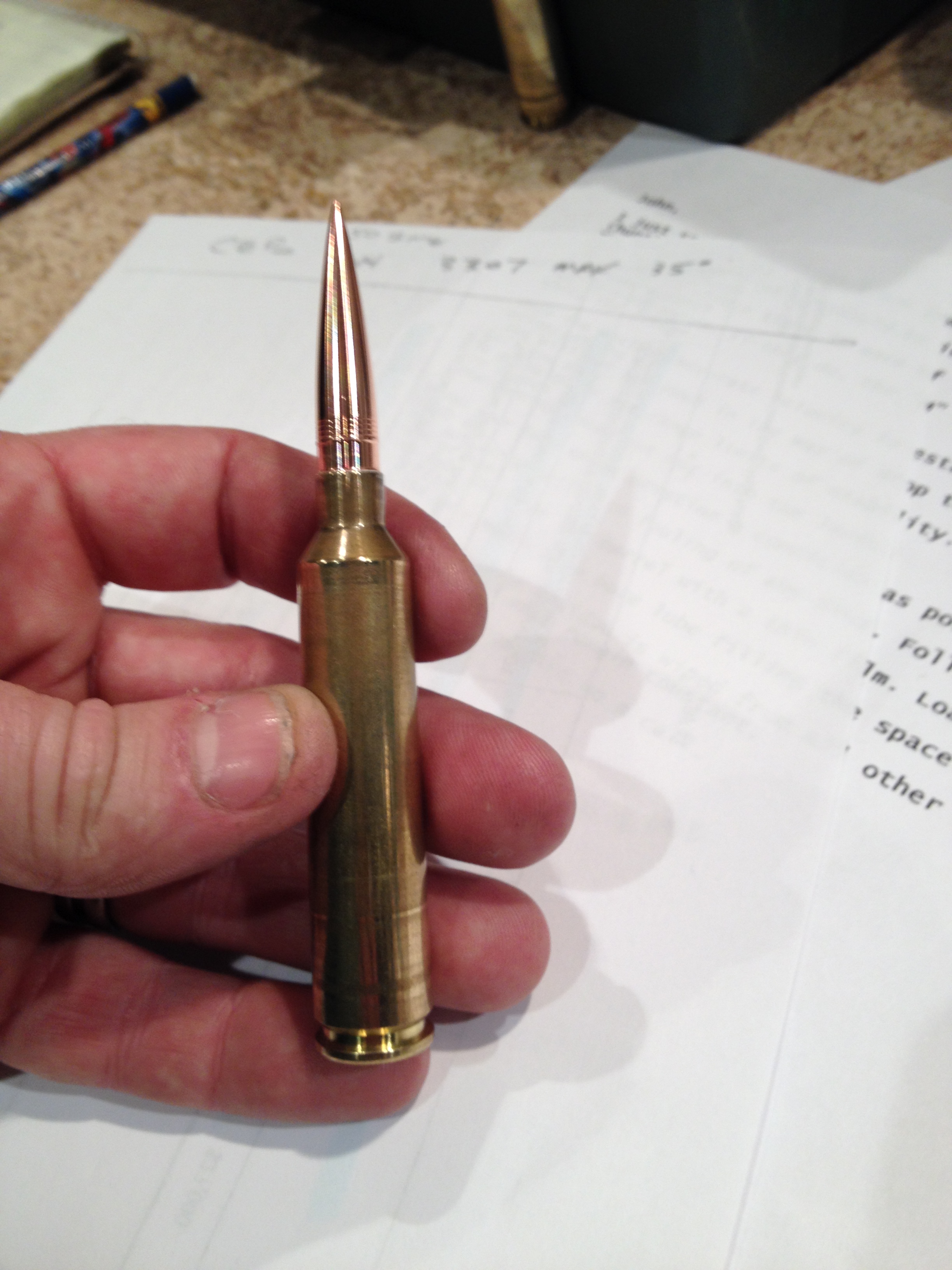

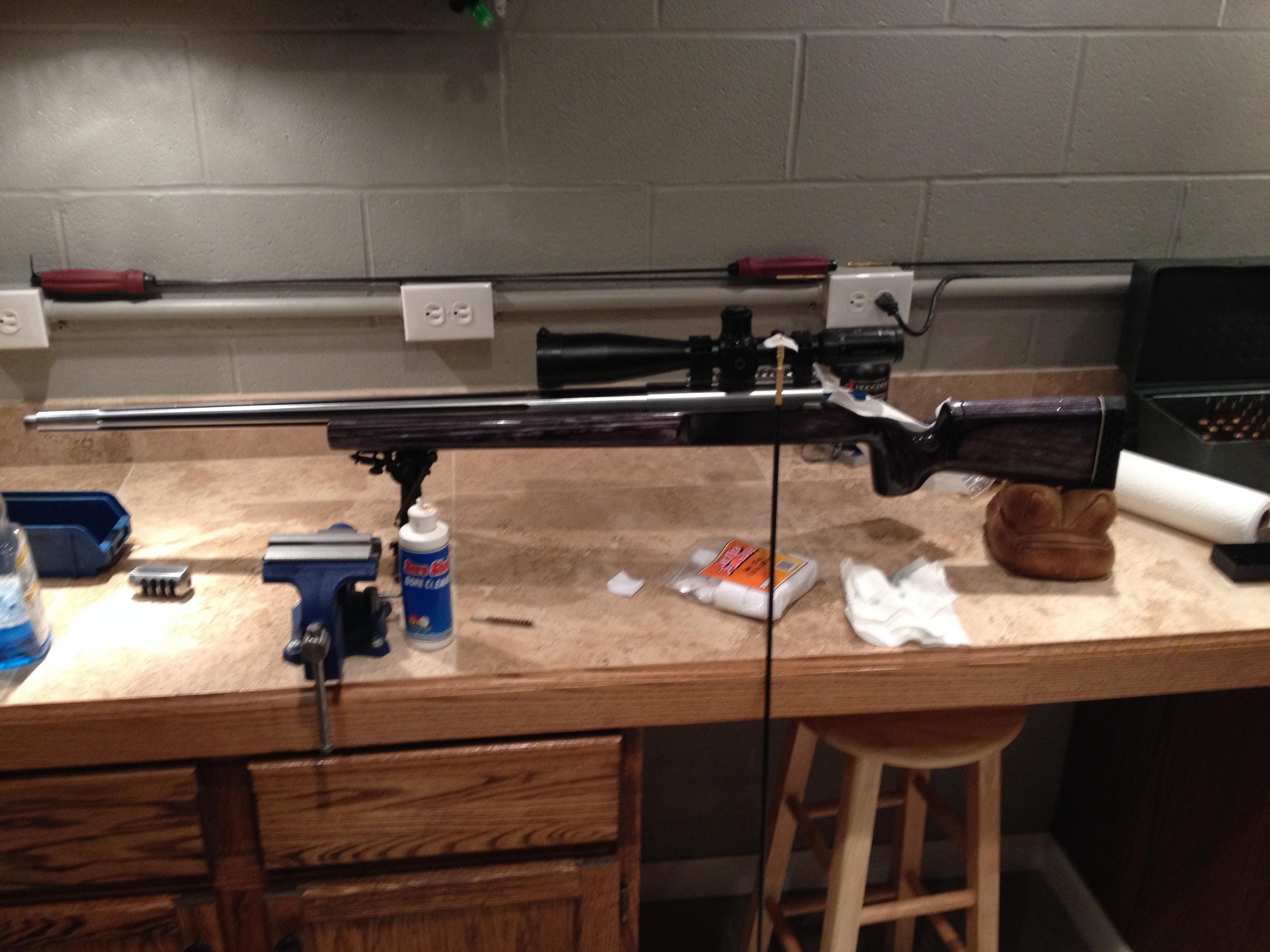

Today I ran some maximum safe velocity testing with the ZA 338 280.5 grain Match bullets. No accuracy testing was done at this time. All shots fired from a 338-408 Improved with a 30" barrel.
Distance to first Chronograph screen: 13'4"
Temp. 39F
Humidity 69%
Station Pressure 28.59
Based on other data I'd collected I thought 142 grains of RL-50 would be a safe place to start. Below are my sample charges and velocities.
142gr = 3278fps
147gr = 3377fps
152gr = 3479fps
154gr = 3518fps
I got a maximum velocity of 3518 w/ RL-50. The Primer was still round around the edges but some firing pin hole puckering was becoming evident. Given this is well over 100 FPS faster than I could run other 300 gr conventional, and solid bullets, I saw no reason to push. I Highly doubt I'm burning all the powder I'm putting through it. I feel pretty strongly a longer barrel would offer some increase on the top end.
Without any other test firing I simply loaded what I felt was the maximum safe powder charge(not knowing if it would produce an acceptable ES). I chose 153 Grains of RL-50 for 6 shots. It produced an ES of 8 and avg velocity of 3508 fps. Even though these bullets were not designed for my barrel they did produce sub MOA groups at 100 yards.

The rifle was built by montour county rifles.
Barrel is 1-9.4 broughton
Action is Bat
Jewell trigger
MCR custom laminate stock
Muscle brake
