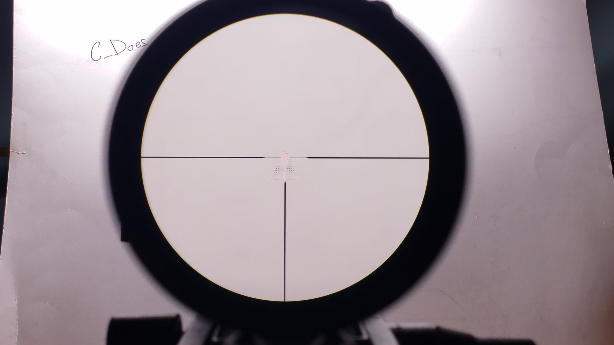

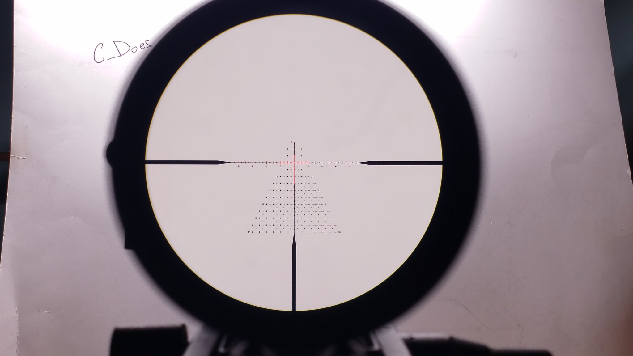

Hey Yall, Im finally getting ready to start filming my mega MPVO comparison. I got the H6Xi setup as good as possible. The illumination is on full and these stills at 2x increments. So 2x, 4x, 6x etc...
I dont mind the reticle past 6x. Unlike the Delta Stryker 5-30 reticle, I like the '+' at the full mil marker for the drops section. Its easy and fast to pick up and makes sense to me. Below 4x and it gets incredibly fine. Im glad that Steiner opted to have the posts extend to the outisde of the image. But its still missing something to pick up the center easily. Illumination isnt half bad tho, and I like what they did with the control for it.

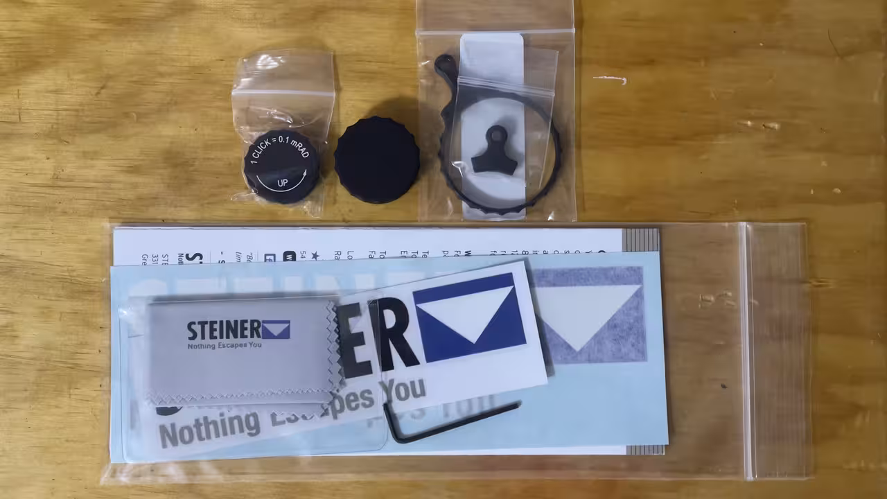

Steiner includes the focus ring, battery, capped turret conversion for the elevation, lens caps and lens cleaning cloths along with the "case candy" or paperwork/stickers and decals. Have a few photos and I'll post them tomorrow.

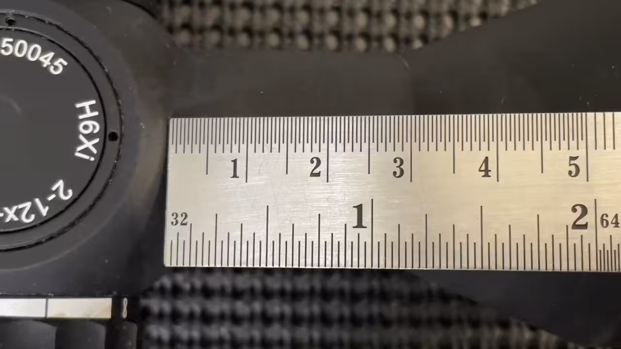

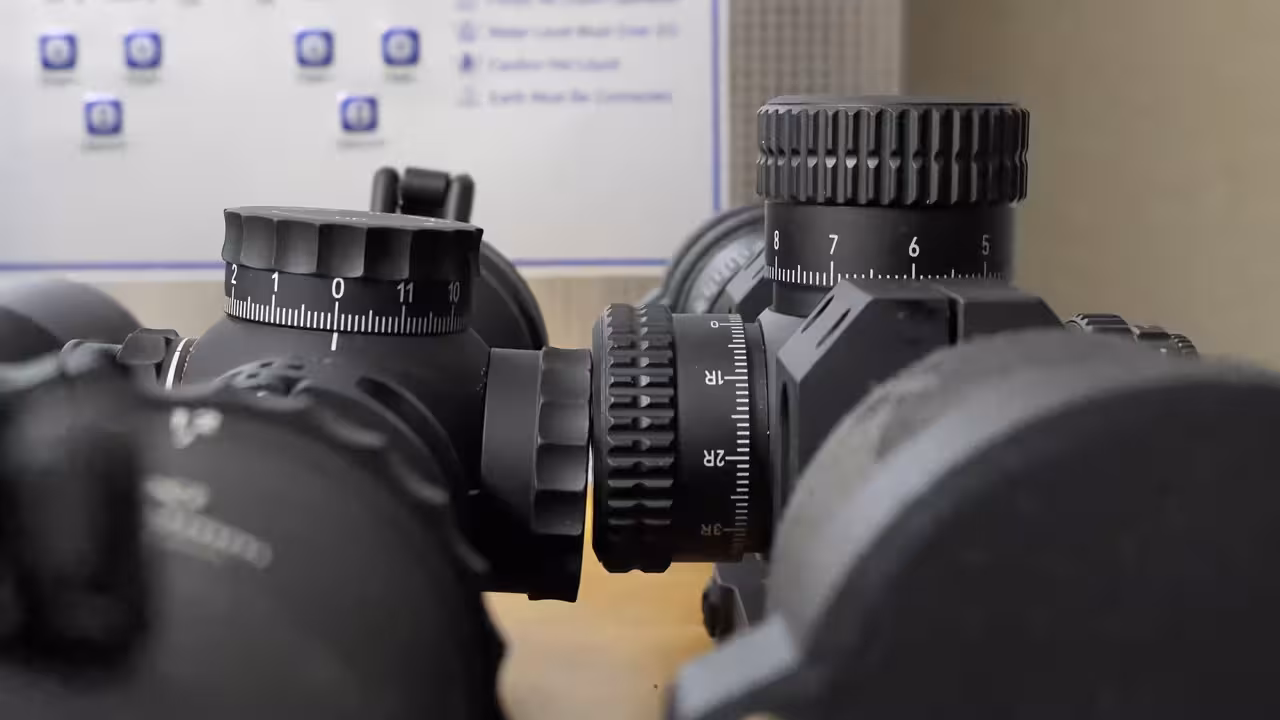

Here's a comparison of the Athlon and Steiner turret heights. I didn't have the Steiner mounted yet but you can see the difference. The Steiner's turrets are half the height.
On the 2-12 you have about 32mm clearance between the prism housing and where the scope flares out. It'll be a tight fit with any top ring RDO mounts so choose wisely and measure twice before ordering. I'm looking at the Area 419 cantilever mount which has a probably too tall RMR mount but could be an optical illusion.

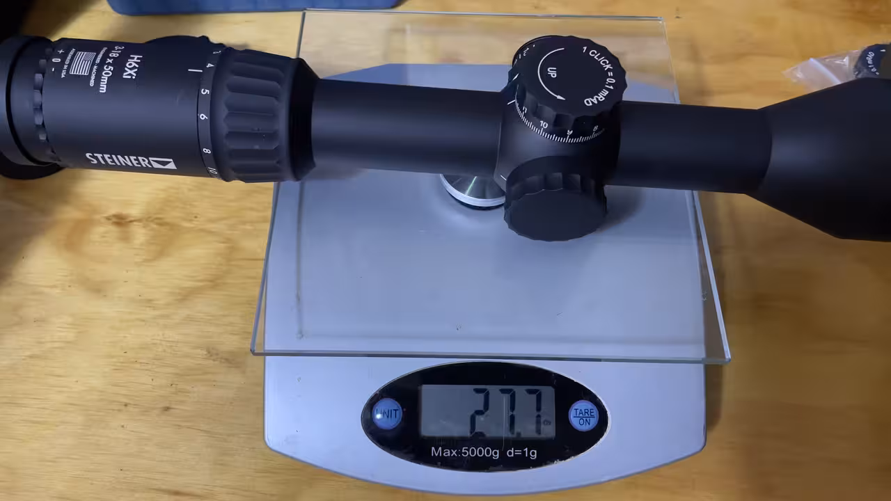

Weight! The Steiner had the OneHundredConcepts shock collar and rear scope cap so take off half an ounce.
The Athlon, naked, isn't far behind.
The 3-18 isn't too bad in the weight department.

Included accessories.
