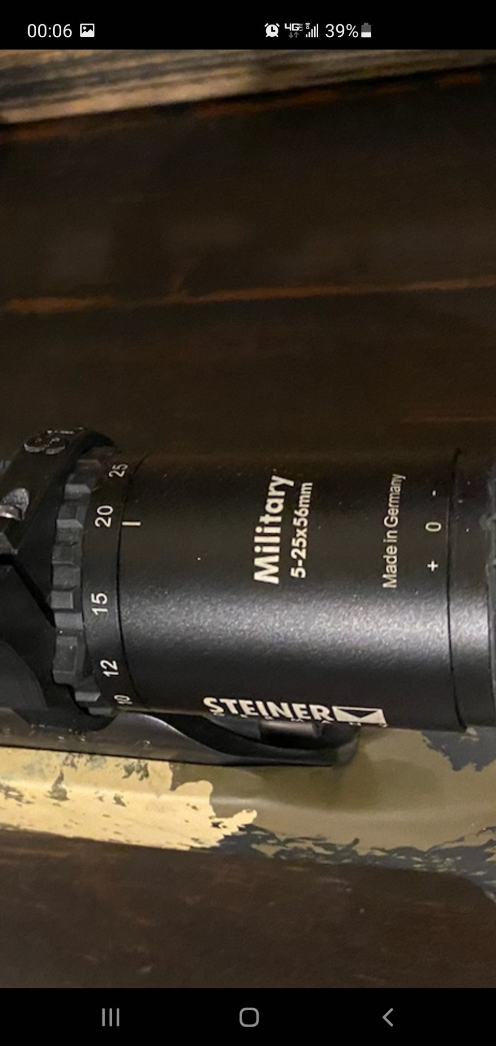

    Can the informed please outlined differences between these two scopes? One labeled "Military" and the other labeled "M5Xi".
    Mainly, when did this change occur?
    What distinguishes a Steiner "Military" from Steiner "M5xi"? Is it generation, country of origin, or nothing? Thinking it must be significant enough to rebrand on the eye piece.
    Please try not to muck it up with internet rumor mill guff or "guy at the range told me" conjecture. Just real facts...please....
    When over the years did they start doing that.... kinda helps to date these scores. If they switched to M5xi in 2020 and you see one with Military...then the Military score could potentially be just 2 years old or it could be 10 years old.

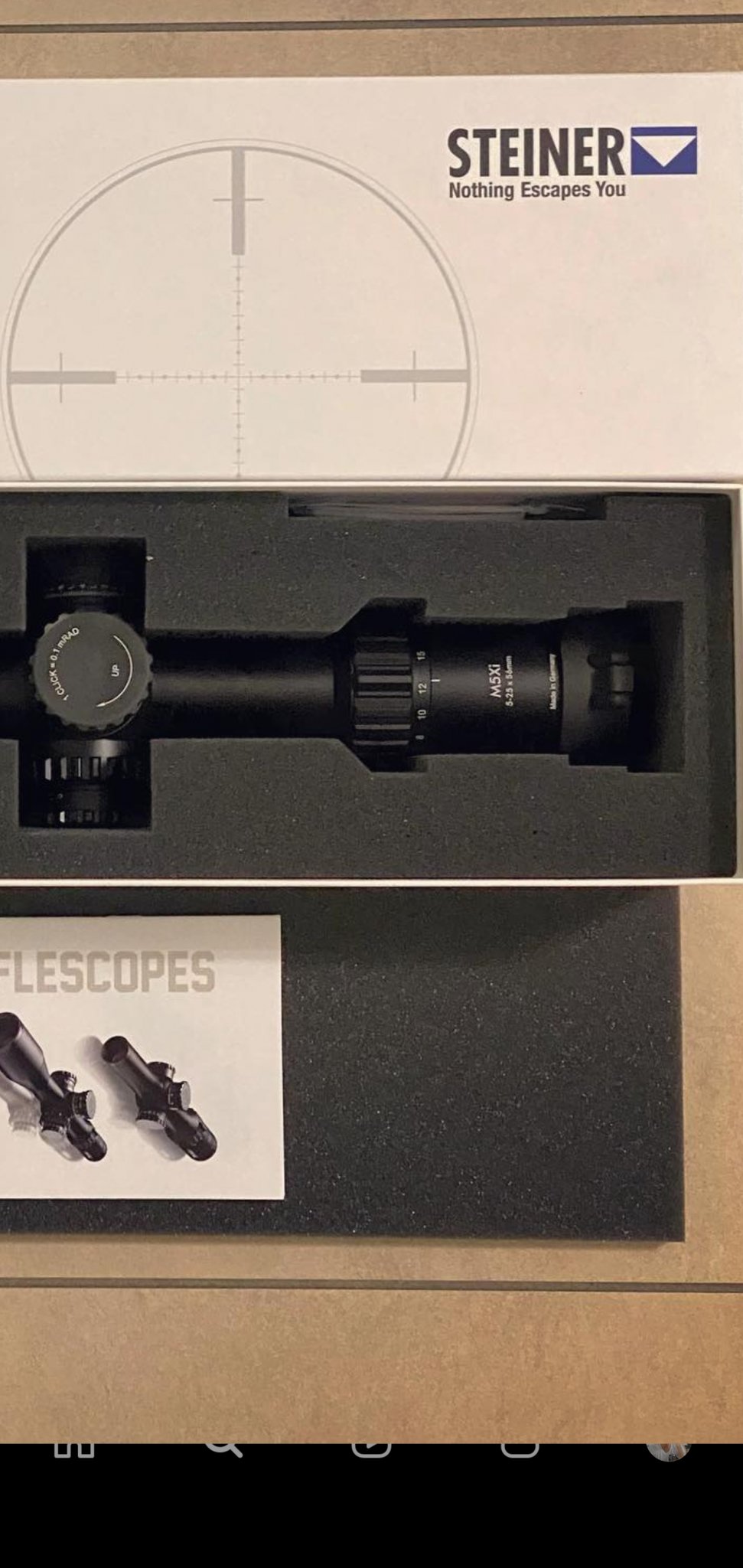

    If I remember right, I had a 3-15 that was labeled on the scope as Military but the box was M5Xi
