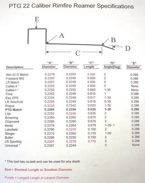

I’m looking at having a barrel chambered and fitted on my CZ457. I would like to have the same chamber that Vudoo uses but I believe that is proprietary. My question is what is the next best thing. I see there is a Anschutz, Lilja, PTG and several designed for Eley ammo. Does anyone have any experience with the different chambers and how they preform?
Going through this process myself except mine will be a modded 455. Most match chambers have the slight leade angles (1.5 - 2 deg) it really comes down to how much you engrave the bullet and the over all quality of the lapping job on the blank.
Voodoo use modified win52D I think. Think the new design is a "ravage" designation, which is based on a 52D. Again, best let them explain it better.
Calfee v2 is excellent.

It was ok but there were still many questions not answered.
I am getting ready for buying a barrel too and while I have not yet asked which reamers they use, I want to soak all information possible to make educated choice and maybe ask them to get a certain reamer.
At the moment I am reading all of the 22lr reamer threads and have also studied and been comparing the document listing reamers.

Ability to take a round out of the chamber usually coincides with how tight the chamber is... which generally means things are pushed really far into the lands, or the area for the brass is also so tight that any sort of particulate will cause friction. I ran a Win52D chamber. It was a pain in the ass to chamber. Had to really put a lot of force to cycle a round and get the bolt closed. It had a wider brass taper area so I could extract live rounds, but where the lands started was very early, which made feeding really rough.
I ended up getting my chamber re-reamed to push where it hit the lands further. I believe win52d is like .580, and Eley EPS is like .60 or .61. That .02 made a huge difference.
I went to a match, which was just bench silhouette shooting, and a person had an anschutz, they kept wacking the bolt forward to get it cam down. Shot fantastic, but definitely wouldn't run that for a PRS match.
Eley EPS chambers well, but I've heard due to the tight brass area it can have issues with live extraction. 52D has a large opening, just starts the lands early. I'd go Eley EPS and open it up for easier feeding + easier extraction.

The smith has a PTG match reamer.
Should I roll with it it? It seems to be tight enough. He added that he can use whatever reamer I have in my hands.
Should I buy another reamer? Padoms reamer sounds very good.
The more I read the more I had questions.
It also seems that the person making the chamber is as important as the reamer.
And I guess it is better to use a reamer the smith is familiar with?

I guess PTG Match chamber bites into Lapua and SK bullet bands?
