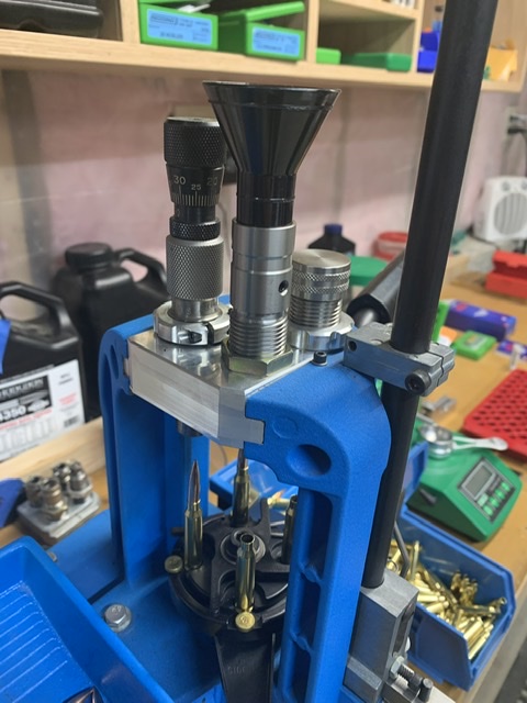

    Been considering the funnel, how’s it fit next to your seating die? I use Forster and Whidden and I suspect they’ll be too thick. The Whidden measures 1.2”.
    Thanks
    Thanks
    Fits no problem...here it is next to a SAC and Forster....Redding Micrometer seating dies are even slimmer....fits no problem....
    I checked with EntirelyCrimson. Whidden dies might not work at 1.2”.
    @padom, it looks like you’ve got the powder die raised pretty high with the Forster; no issues there? My Whidden seater sits 3” tall. Thanks
    For the Dillon RL550:
    The maximum compatible die diameter is 1.0” at the largest part of the funnel.
    Under 2.0” height (under the funnel flare), the die clearance is a maximum of 1.25”. However, the height may be usually be higher, this will vary by powder die funnel.
    Thanks,
    Austin
    EntirelyCrimson LLC
    My powder die is set at the height it properly engaged the Area419 funnel....all I did was put the EC funnel on...works great for 1000s of rounds
