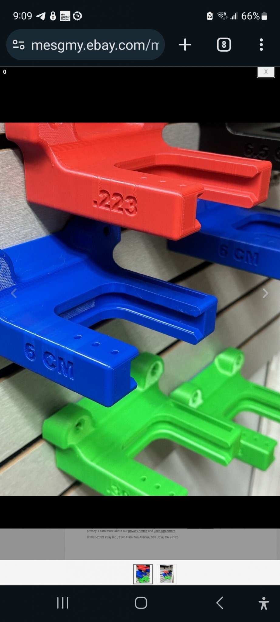

If you plan to have a bunch of toolheads Inlines wall mounting system with toolhead holders are excellent. This is an old picture but I have 2 rows on the wall of toolheads for my 550, another wall with all my 650 toolheads and another wall I'm now filling with Super 1050 toolheads.
I'm trying to find a rack for toolheads and powder hopper that will fit right into my slatwall that I have around my room. I could put one of the inline Fab wall organizer things and then some of their tool head holders but I may can find a 3d printed ones that will go into my slatwall directly which I would prefer. Definitely have to have something though for 8 tool heads
Speaking of Inline Fab.....
I've been working with Dan with Inline Fabrication to set up my new reloading room. I will post on some other relevant threads also but here's the code for Black Friday Inline Fab . It won't go active until after 5pm Wednesday pacific time.
Code is: BLACKFRIDAY23
15% off site wide
Pretty good time if you are looking to upgrade your set up. I'm definitely going to like the work station and being able to put a vise up there so easily as well as the Bins and input/output stuff they do.
Pretty sweet tool head storage racks. Color coded and embossed to match my dies and all.

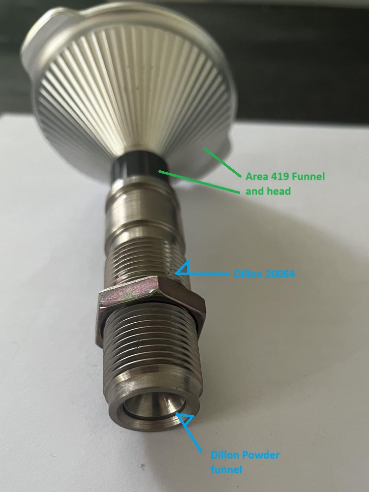

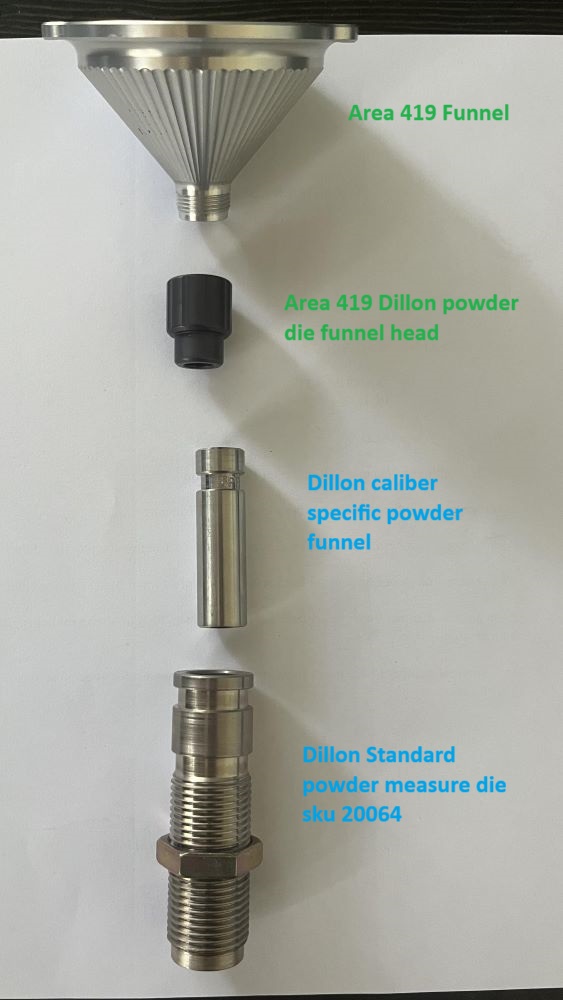

For stick powder i intend to use my autotrickler v3 and pour through funnel on 550. I assume it's not ideal to have the AT sitting on the same bench right next to the press as you might get some movement while working the press while powder is trickling? In that case, i probably need to build a shelf off the wall at the back of the bench, would it be best to have the shelf for the autotrickler setup behind the press to the left?
Edit: i missed that picture from @padom a few posts up where it is setup basically just like i described. That looks to be the ticket?
I have my AT about a foot away from my press, on a 3" thick granite slab on top of rubber hi-fi dampers. I can seat and drop, no problems.
I spill more often than I care to admit when I run the funnel on the press. If you're already running two toolheads, I find it better to dump powder while they're off press, captive in a case tray then top with a bullet and slip them into pos 3 to seat while the AT is running the next charge. I end up seating at about the same speed the AT/IP drops powder.

Right I guess my question is which one works with either Dillon plastic funnel or 419 funnel. Their site has 5 different powder dies and I obviously ordered the wrong ones (4 of them) since neither funnel fits. I even called them and got part numbers to ensure I ordered the right ones but…
Seems like the AT500 or AT500 oversized? The caliber specific funnel that comes with the conversion kits just falls right through the ones I ordered.
So, there's a tip for the 419 funnel that will work with dillon through die to throw powder off press. Then there's the various caliber specific pieces that work with the dillon powder dies. Perhaps there's some confusion here concerning that.
Reactions: HonkyTonk86
Something here is not lining up - I don't understand which parts you mean, and it could be because two things are called 'funnel.' You shouldn't need an oversized through die except for big bore like 50s.
This is my mediocre attempt at an expanded view:
And assembled (If held upright, like screwed into the press, everything is static and held by gravity, with the dillon funnel resting at the bottom of the powder measure die and 419 funnel resting on top. The dillon funnel will slide up and down as it engages the brass and may bump the 419 funnel head if the die is too low):
Hopefully this helps, if not, could you describe a little differently which pieces are falling through and what caliber you're reloading for?
