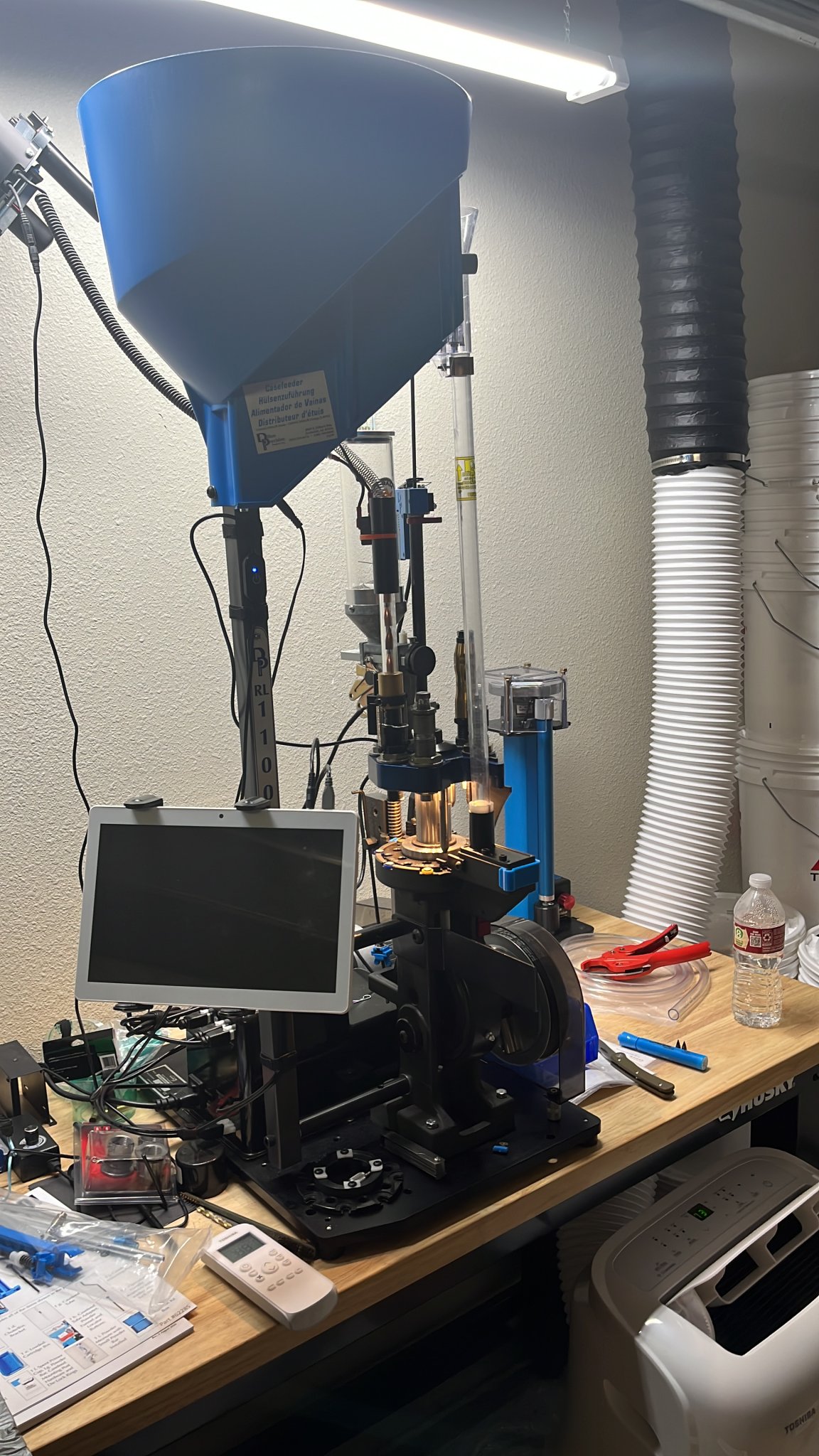

Hey guys, I'm in the market for one of these two, anyone here have both or have ran both? Just curious really about the pros and cons of both and if the Mark 7 is really worth the extra coin over the Dillon. Oh and I know I'm in for a bit of a wait, im fine with that.. Thanks guys for your input...
Absolutely! The Mark 7 is hands down BETTER. I’ve toyed with the RL1100 with autodrive for more than 6 months and the Dillon is an outright POS automated. Very inconsistent, always prone to failures like major powder spills, too much flex in the shellplate, indexing issues, the primer feed arm popping out of alignment, Mr Bulletfeeder not dropping bullets every time or dropping two or more at a time, and so on. I’ve tried everything from the level 10 innovations upgrades and the powder spill kits to the upgraded shellplate from TNT, and even the ball bearing kit for the shell plate. Nothing keeps it consistent for long. It’s just not meant to be automated. About the only thing that’s worth automating from Dillon is the CP2000 for case processing and THATS IT! Save your self the frustrations and buy a Apex 10 or Revolution. Those were designed from the ground up to be automated.
