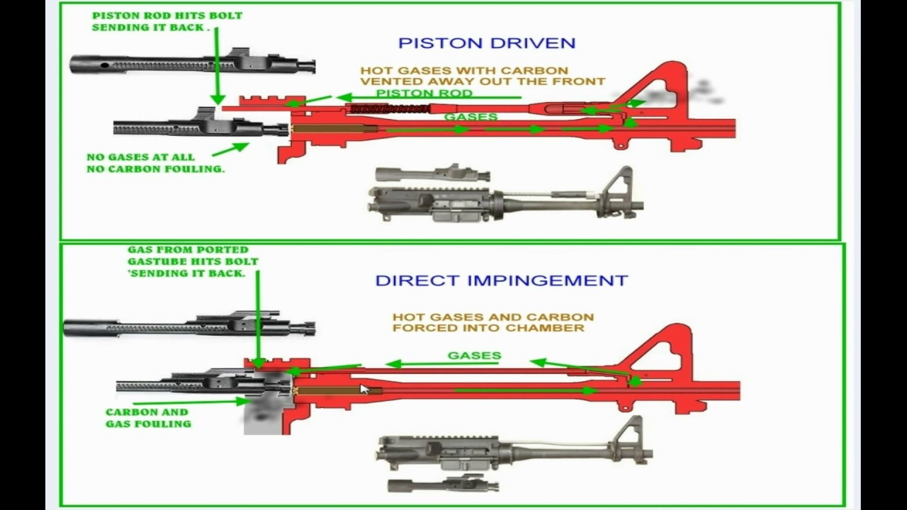

I am not giving you a snarky answer, I am just going to say it. What we call a DI gun is a piston system. It is just a different piston setup than a short or long stroke. Tim on the Military Arms Channel has done a couple of videos on it but it terms of failure rates when systems start to break down and need to be replaced, DI>Long Stroke>Short Stroke.

Actually, all you need is a gas block, a gas tube, and a standard bolt carrier and you’re back in business with a DI system; that is IF you have problems with your piston set up.
As somebody who owns both, the parade of imaginary horrible's, in regard to spare parts in a resident evil/book of eli type scenario is a little silly. Spare parts are easier to come by in DI, but its not exactly difficult to get spare parts for a piston set up its thats your cup of tea. I would recommend, the everyone, regardless if you shoot at DI or Piston, spend the money and get yourself a field repair/spare parts kits/tools/carbon scarper so if something weird comes up, it can be addressed .

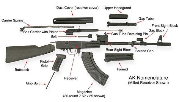

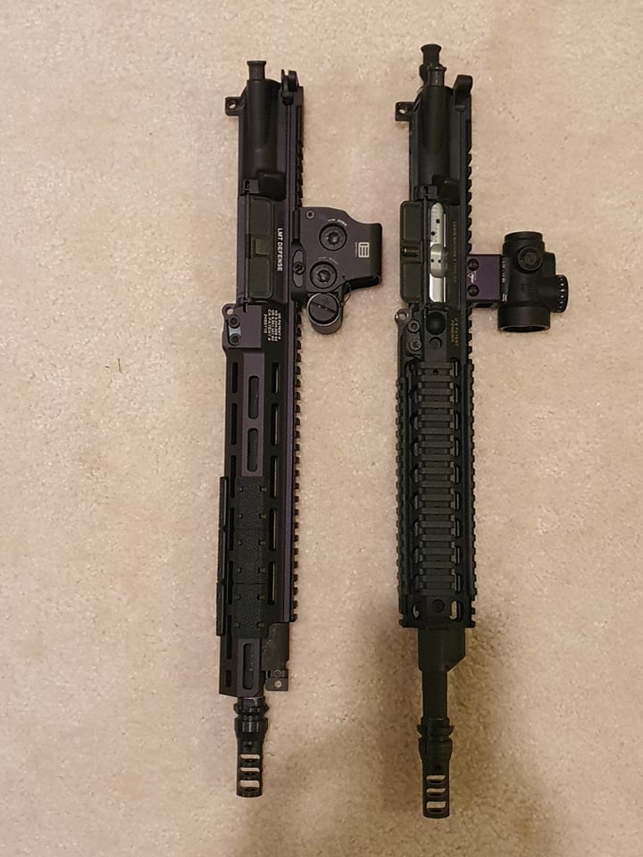

By a decisive margin and from the start the shooting world chose to describe the AR18 technology as a piston driven design and the AR15 as Di/Direct Impingement or Direct Gas design.
The logic behind the naming convention is based on the fact that in the AR18 there is a piston/piston rod moving the bolt to cycle the action, while in the AR15 dirty gases flow through a thin walled gas tube to move the bolt. There is no piston in a Di/Dg AR- the bolt isn't a piston in either design.
Even in an AK pattern rifle the piston rod is the piston, the bolt isn't the piston.
