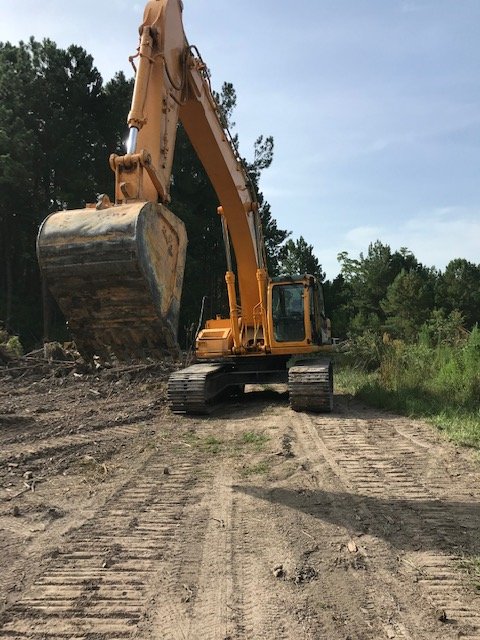

I bought a new house on 16 acres north oh Houston and have been brainstorming and estimating time and material and labor cost to build a 8’ tall U shaped berm with a 40 foot radius.
I’ve done the tire thing helping a friend years ago do his and promised myself I would never do it again. It’s the worst way I’ve ever seen and if you ever want to get rid of the property it does nothing but hurt you and is a serious kick in the ass to dispose of.
Hesco’s with extra dirt piled up on the impact side was my favorite idea, it would have been the most erosion resistant, less dirt over all needed to form the berm, looks better as a finished project, not to bad to dispose of if you get a roll off dumpster and an excavator dropped off to pull them out and emptied and mash them up into the dumpster and haul it off.
I have a bunch of pines to cull plus the area I want the burn to be is full of trees anyway, so my other idea was to use a bunch of them as a filler and cover them with dirt. It would save me some time cutting them up and burning them but I’m not crazy about the idea of using them an (organic rotting) material as my base material though...
There are other ideas I’ve sifted through and really it keeps coming down to trying to figure out how to get enough dirt moved efficiently.
As of a few days ago I finally said fuck it and decided im just going to rent an 19,000 lb or bigger excavator with a thumb for about $2500 for a week . Just use it to pull the trees in my way and dig out the dirt I need out out from behind where I want my berms and just pile it up and be done with the fucker.....

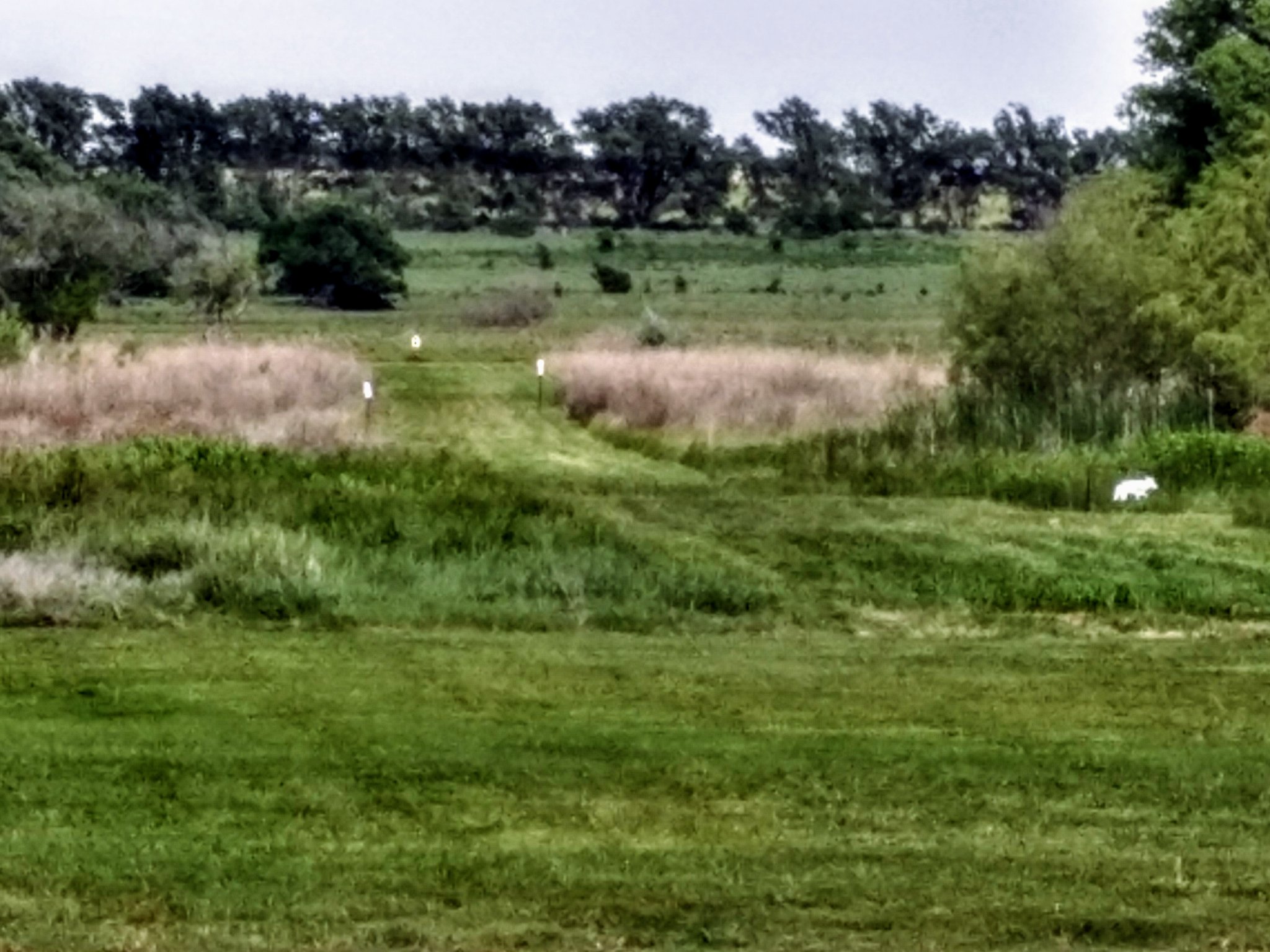

Built a running berm along one edge of our private range, currently it's about 350+ yards running length along the edge of the property. Got about another 75 yards to go and one entire edge of the range property will be bermed completely. It averages about 6 foot, at some points is 8 foot and probably averages about 4 foot thick in the center and just over 2 foot at the top of the berm. Smaller stand alone berms at 100, 200, 300 and the 419 berm is part of the running berm on the end near the vehicle range.
Most of the time we don't even shoot into that long running berm except a couple of places like the vehicle range area and the 419 yard target area. It does allow for almost a 300 degree shooting option in many spots on the range.
Besides, playing in the dirt is fun :)
