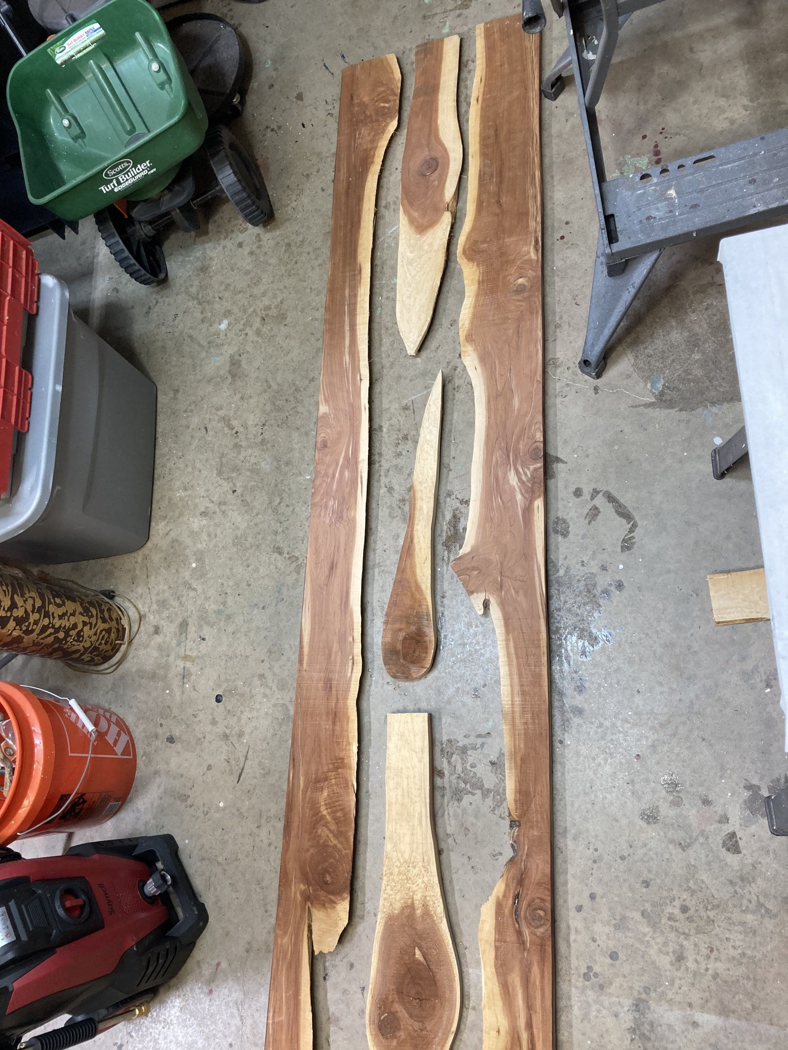

Been thinking about making one. Got some live edge cedar slabs. Might do a river table/ epoxy concept. I realize this is not the “professional” way with say a hard maple surface. I’ve been doing a little research. McClure Shuffleboard site has been useful.
Input and advice please.
Thanks

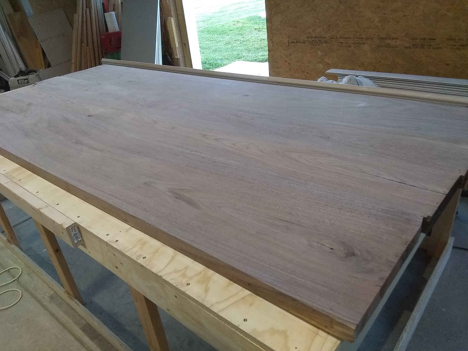

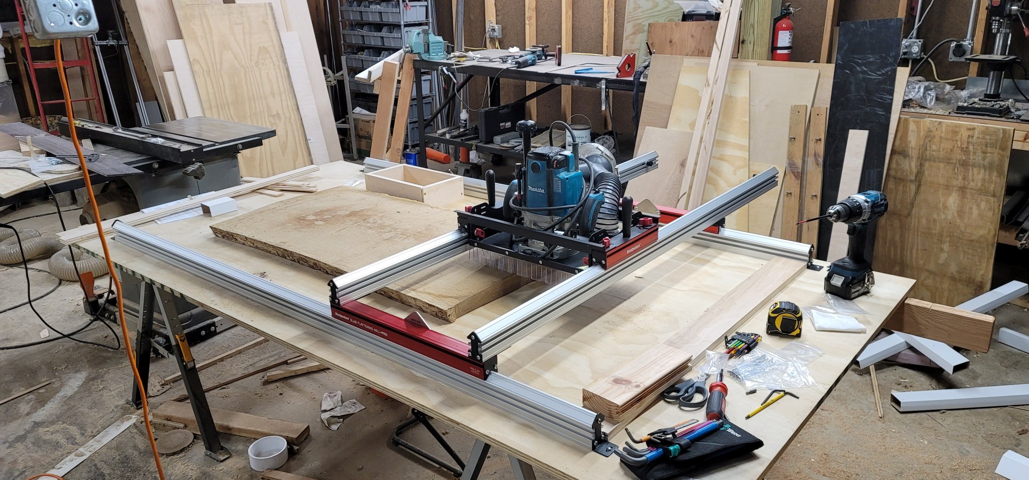

I used a Woodpecker Slab Flattening Mill to flatten a glued-up 9' walnut slab. Kind of expensive, but
you could probably make one with a homemade sliding router table to flatten it.
You can of course use a surface planer (I have a 20"), but that may still leave some twist, the router does a nice job of making it flat.

So, my slabs are +\- 1” thick. I was planning to make the playing surface 2” thick with the slabs buried in the epoxy. Hopefully eliminating the need for a lot of fine finishing to the wood. Yes,no,maybe?

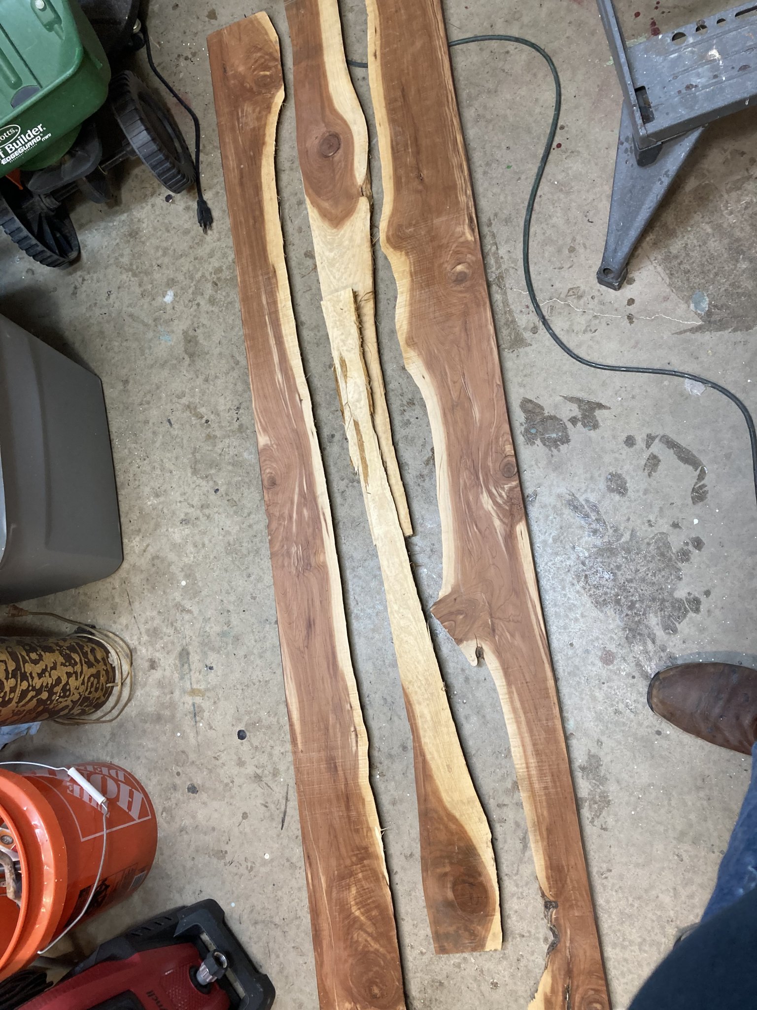

Some experimental layouts. Probably wind up not doing the center pieces. Don’t know yet.

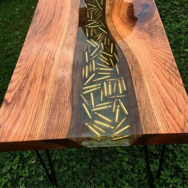

The river. I don’t know. The blue thing seems a bit over done. Ain’t seen too many blue rivers here in Texas.😂 I thinking LEDs under the river also. I’m very early in the planning stages
What’s that one river you texans are particularly proud of. It looks a lot like clay mud to me
I’m liking the cartridge theme.
As to slab mills. These guys have this. I know nothing about its quality or capabilities compared to the Woodpecker.

I have the Woodpecker slab mill. Works great. I used to use a homemade router sled. Either way you're going to get the job done. The Woodpecker rig is much more user friendly with lots of nice-to-haves.
