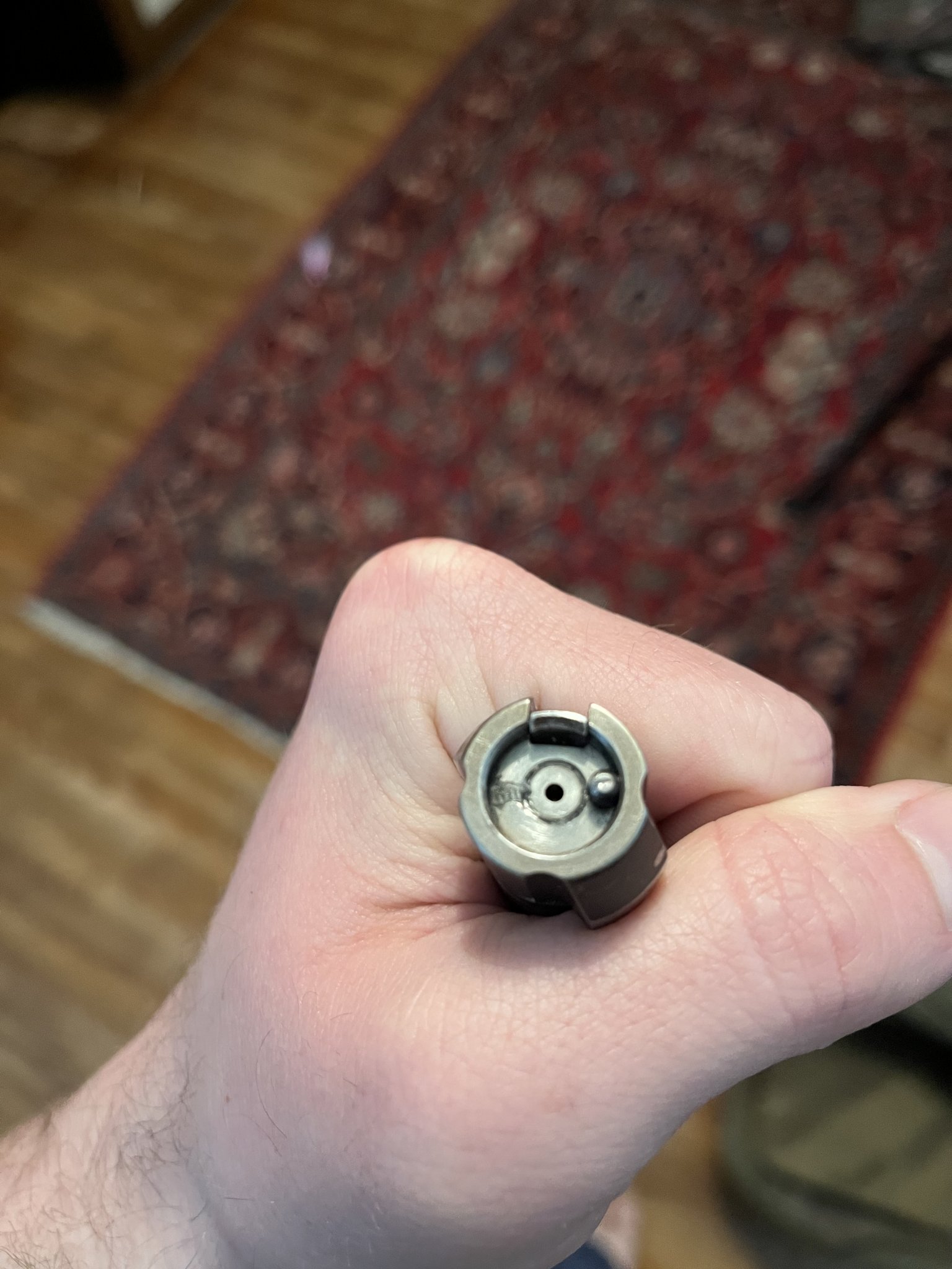

Recently had a primer blow out badly and looks like the bolt face is now damaged.
Do I need to get this repaired or replace my bolt entirely?
I will be reducing my powder charge, rework seating depth etc regardless

I would probably only shoot that bolt another 100-150 thousand times with the face cut like that.
So you’re saying it’s not a problem?
I’m about to switch barrels on this tikka and worried this will impact head spacing.
I’m still fairly new to all of this so I’m genuinely trying to understand what I need to do here.
Not going to affect headspace. As someone else mentioned. It looks like you’ve had leaky primers for a long time. Picture is blurry though.
Yes they may have been leaking but haven’t had any pierced primers except for one recently.
Main reason I’m switching barrels back to a stock tikka is the pressure issues I’ve experienced
Those issues tend to get worse after you pierce one. check the tip of your firing pin, it is probably etched too.
depending on how etched, it might leave marks in the headstamp of the brass that can effect reloading headspace. other than that I would shoot it as is, maybe take a little sand cloth to smooth it out. its not a safety concern.
Absolutely, not a problem.
If the jetting doesn’t stand proud of the boltface, it doesn’t matter. If it does, sand it down.
  • Check your brass- discard, if necessary.
  • Lower your load moving forward.
  • Also moving forward, pay attention to pressure signs, this has gone on a while.
Reactions: YotaEer
