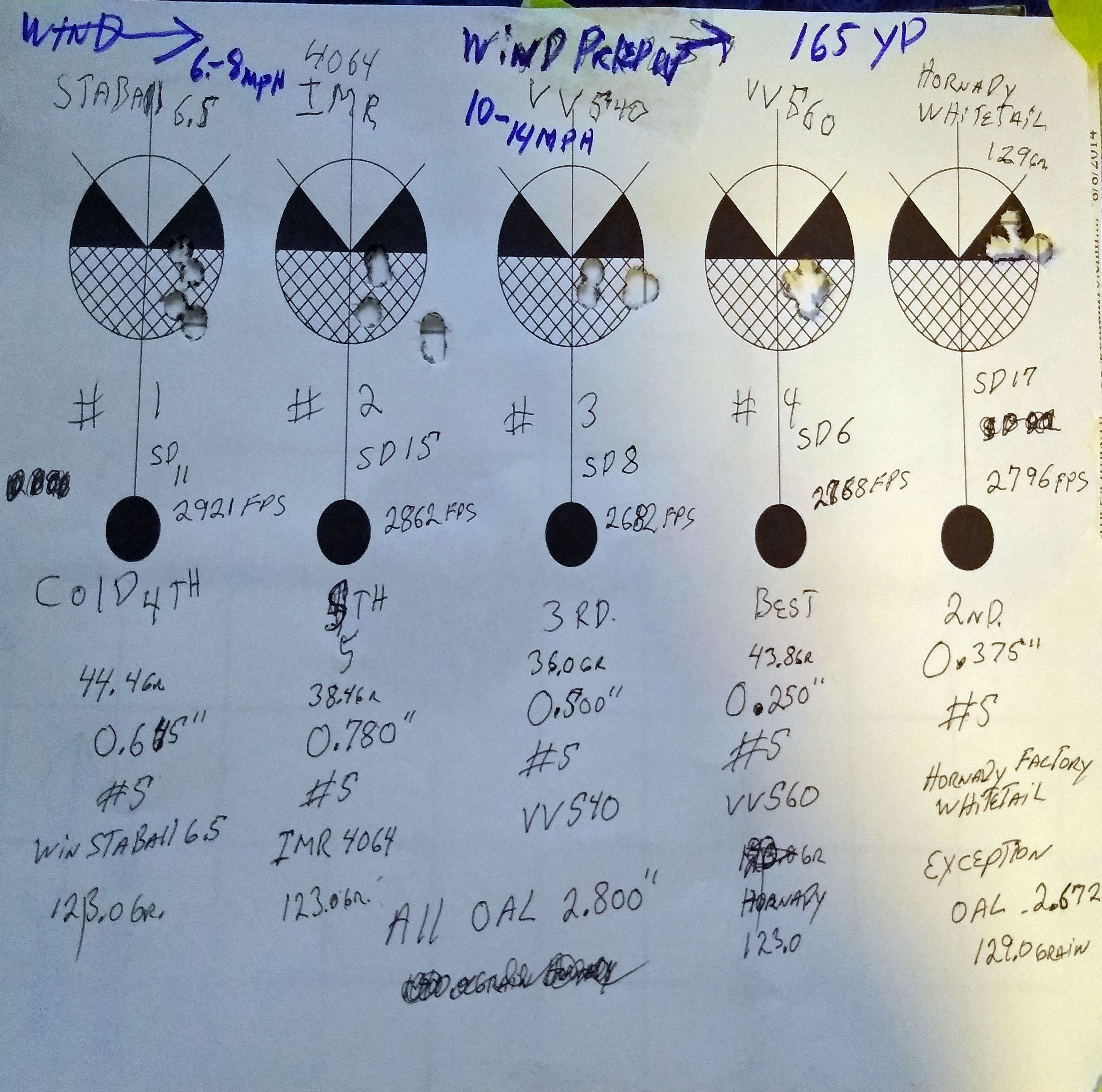

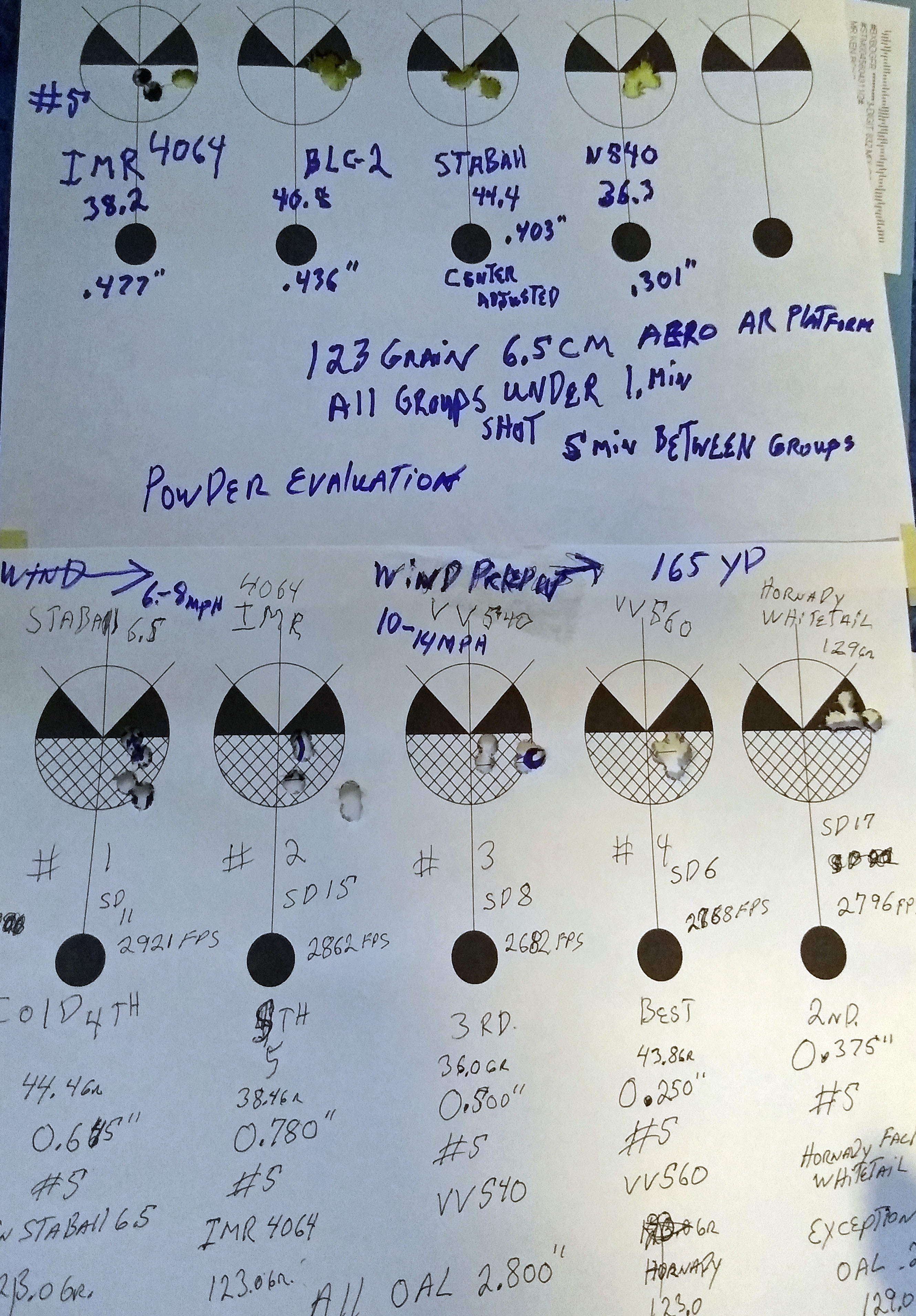

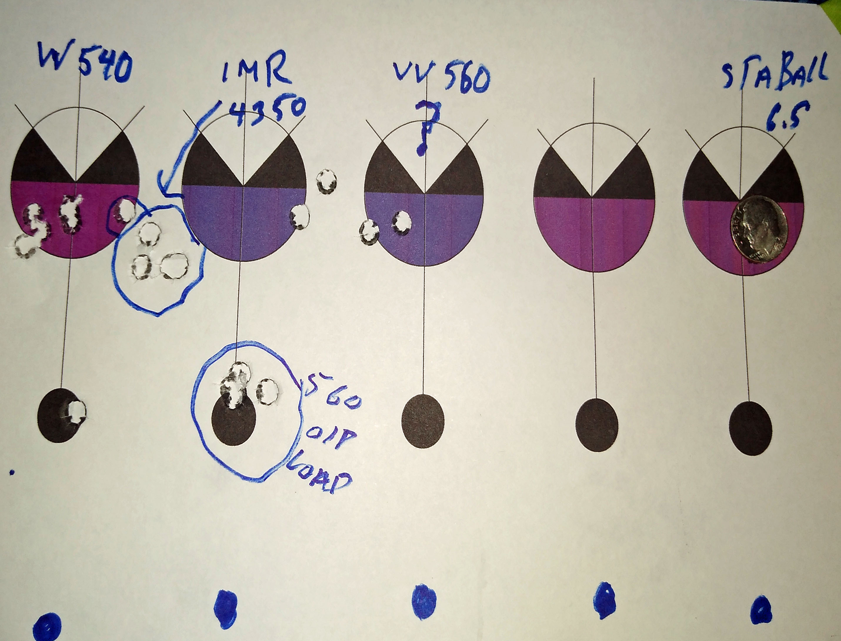

Starting with a KNOWN CLEAN bore ,gives You a Baseline accuracy point . Others may differ in their methods but when I do load development , I start around upper middle of the load charge recommendation . I then load #5 upper # 5 middle and #5 lower .
Known as covering the ladder . From a clean bore " ALWAYS FIRE A FOULING SHOT " before judging groups . Say lower rounds loaded didn't fair well ,save for fouling and ditto with any rounds which don't meet your approval for accuracy .
Don't know if you're running a Bolt or Gas gun ?. I'm running Gas guns ,so MY OAL is gonna be different as MY lede is a tad longer than most . I'm also on the upper end of Charges , so BE cautious IF You decide to use any of this data !!!. Stay 0.020" off the lands .
130's Hornady ELD , 45.2 gr. ALL loads using N560 Berger's 130 gr. VLD 48.6 gr. Fps 2815 and I practice a fair amount using Sierra HPBT bulk bullets using 44.0 gr. Happy to say at 165 Yd. .250" - .410" groups with all these loads . I also have had Really GOOD results using N 540 VV powder as well as Winchester 6.5 StaBall
Again N560 VV powder ELD 140 gr. .44.0 gr. Fps 2726 , 143 ELD 44.8 gr. , Fps 2742 out of 22.5" 1:7.5 Custom barrel .
I'll post some targets from this barrel when I get it broke and dialed in . Photos are for a couple of other 6.5 CM's I've cobbled together .
