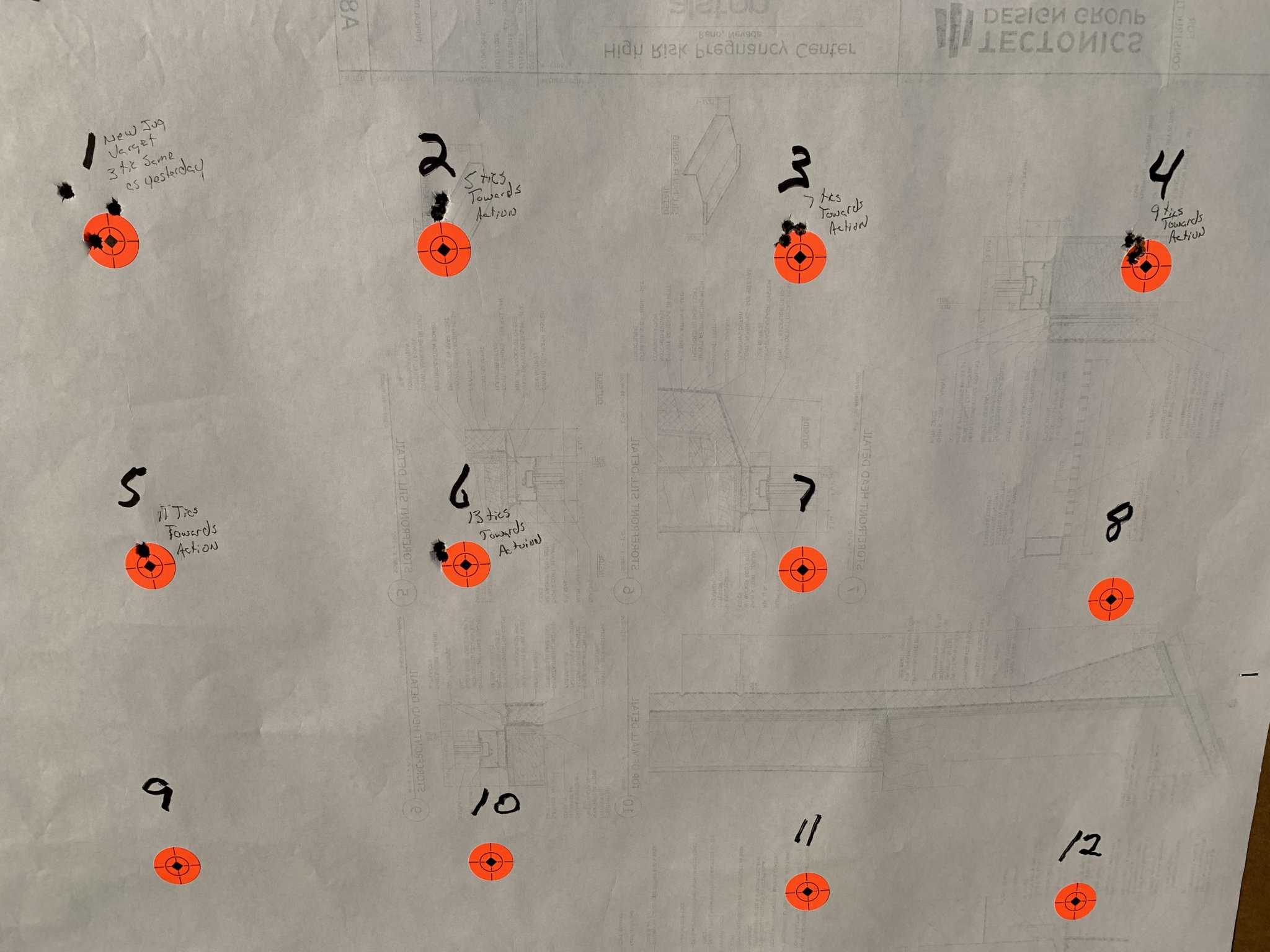

or just use a tuner....
oh i can load good ammo the tuner just takes another step out of the load development...now if it holds up remains to be seen...on the down side it adds another variable to the equation.
