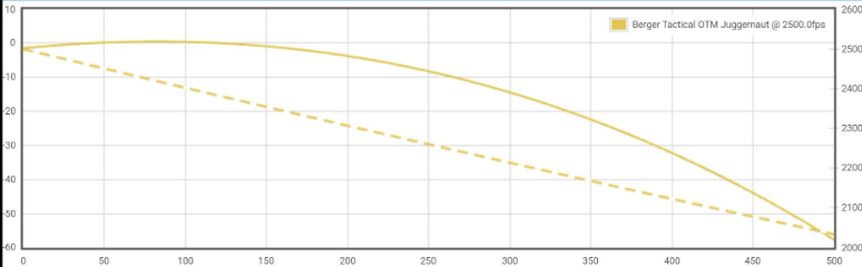

Does any ballistic app or software have a graph that shows the LOS in relation to the bullet trajectory?
Steel+Killer
Killing one steel plate at a time!
  • May 27, 2014
    4,066
    10,851
    50
    32.75259713494653, -79.87485679548313
    As the title says does any ballistic app or software have a graph that shows the LOS in relation to the bullet trajectory? If it could be printed that would be even better.
    I see plenty of apps that show the bullet drop at given ranges, but I want to see a graph that illustrates that as well.
    Anyone know of one that will do this?

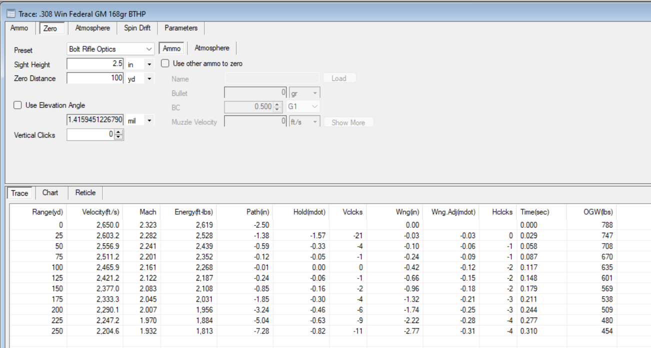

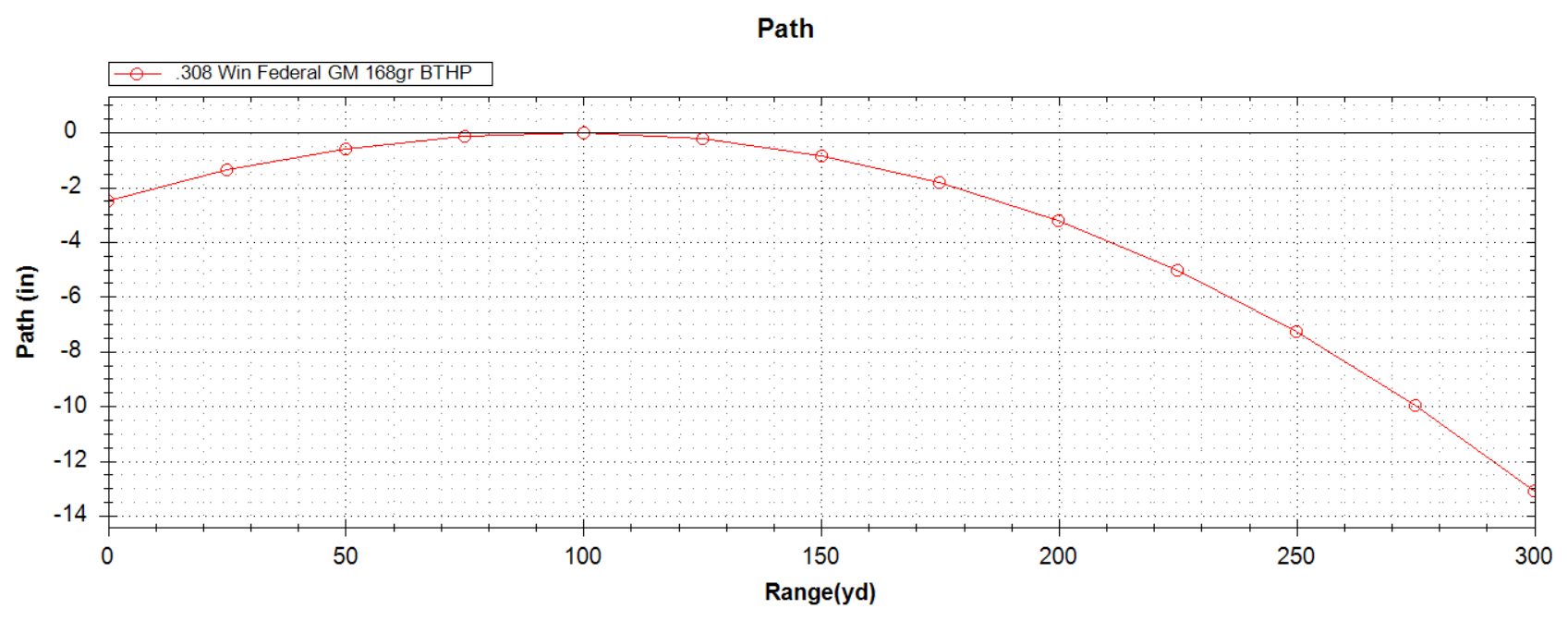

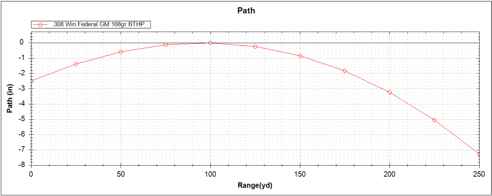

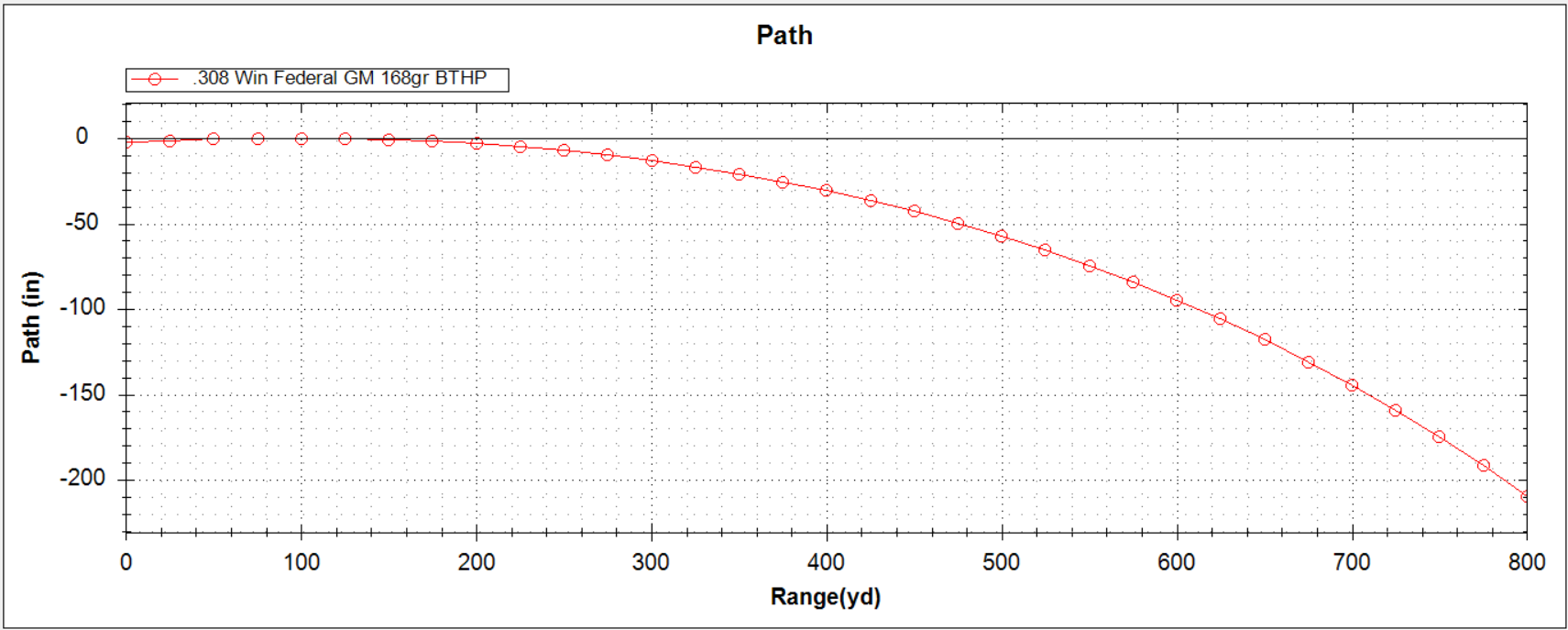

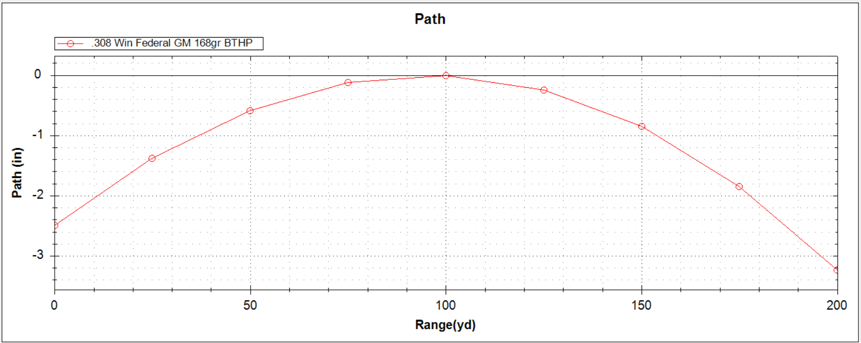

    That graph is an interesting exercise, but isn't good for all that much because the x-axis must be so highly compressed compared to the y-axis. The examples below are for a center-of-scope LOS 2.5" above the bore on a rifle zeroed at 100 yards. The data point increment is set to 25yds. The details for bullet, barrel, trace, atmosphere, etc., for the 250yd chart are at the end.

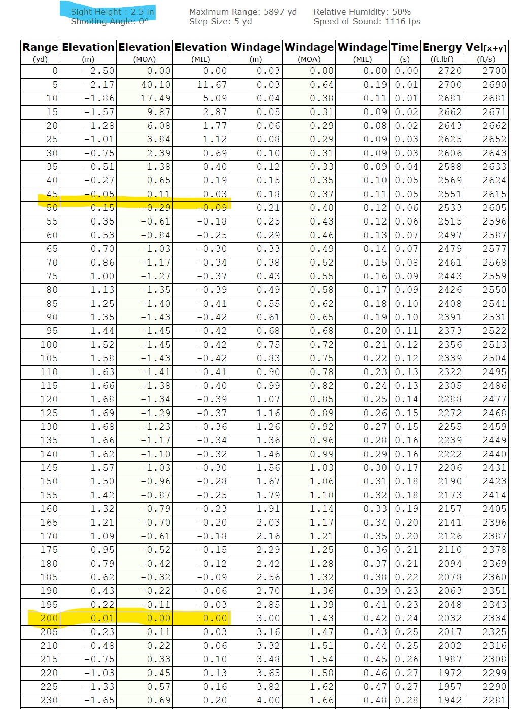

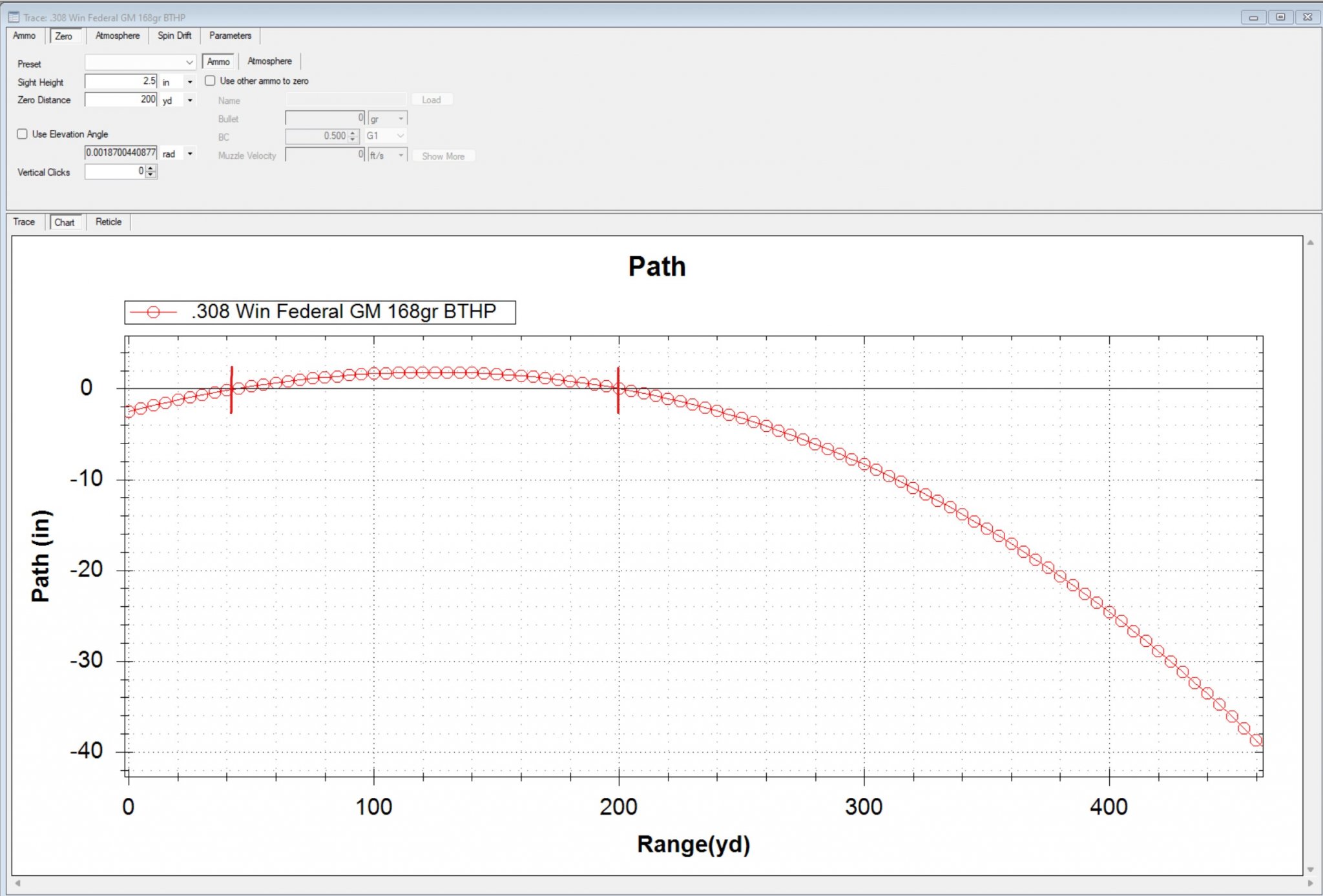

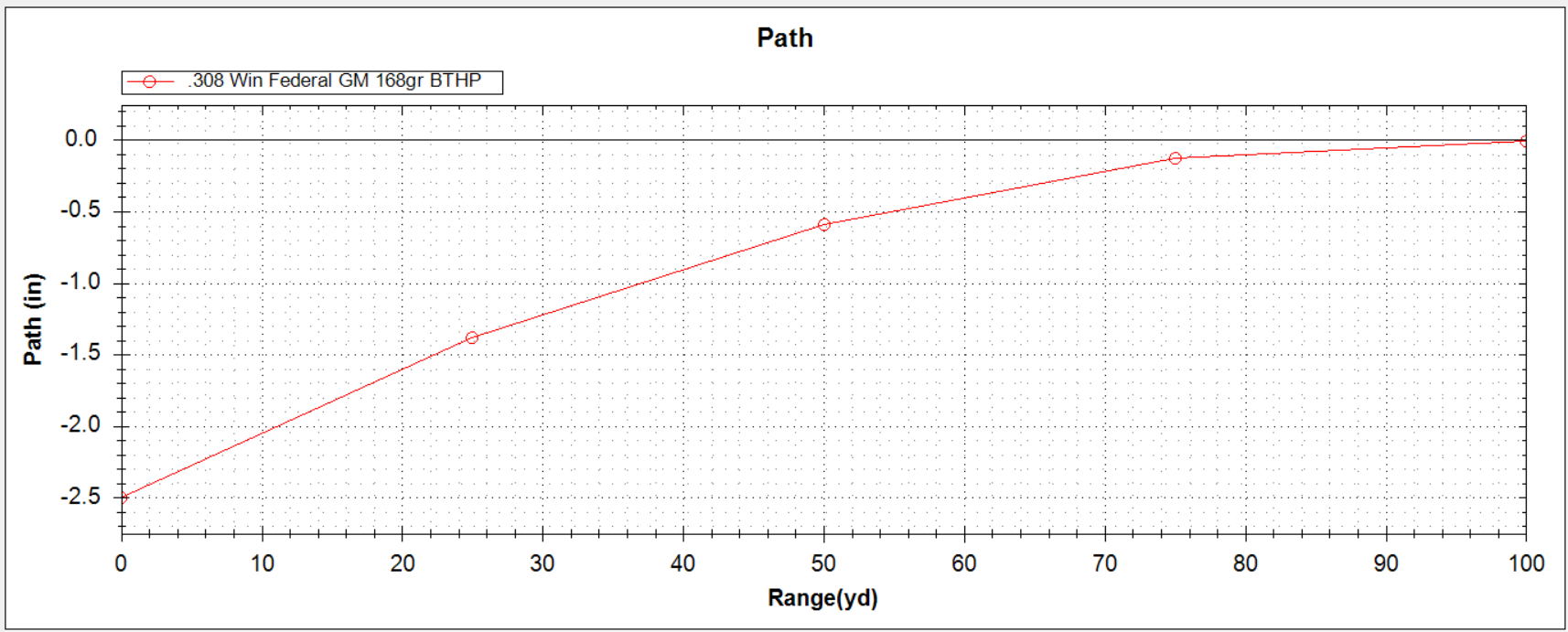

    For all of the ballistics experts out there, of which I am not one, this data is from a terminated open source C# project that appears to be fairly accurate. At least in comparison to the G1 data in the current Hornady G1/G7 calculator. But if it's not perfectly accurate, bitch at those folks, not me.

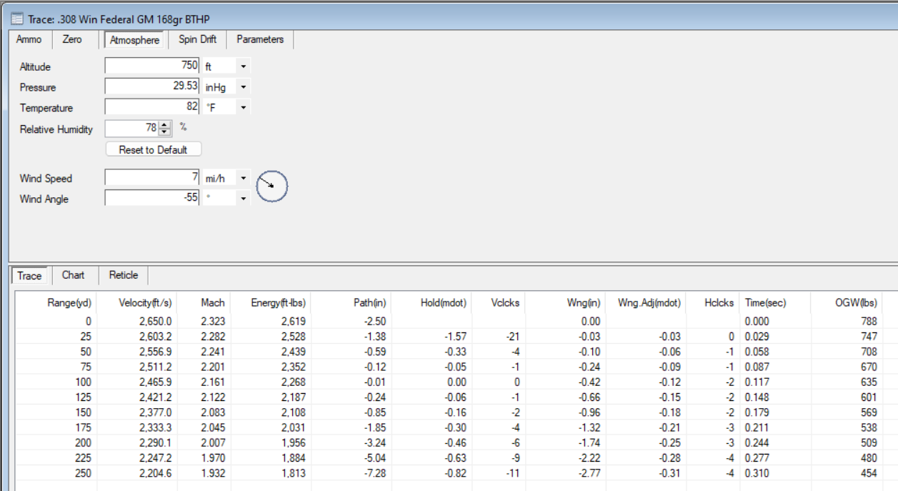

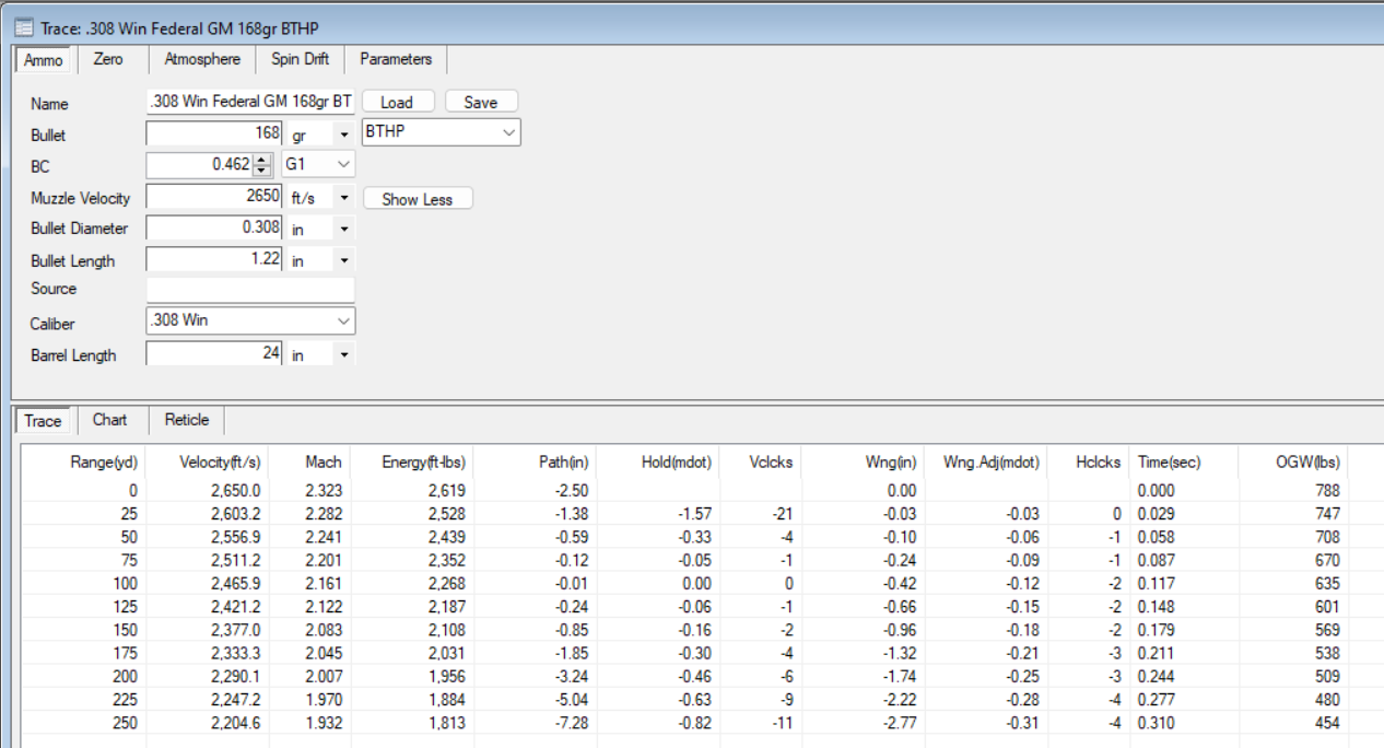

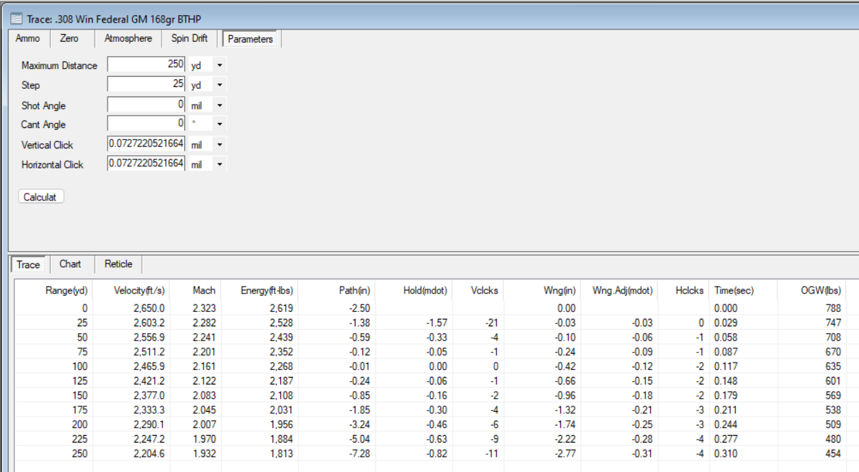

    Details for the 250yd example:

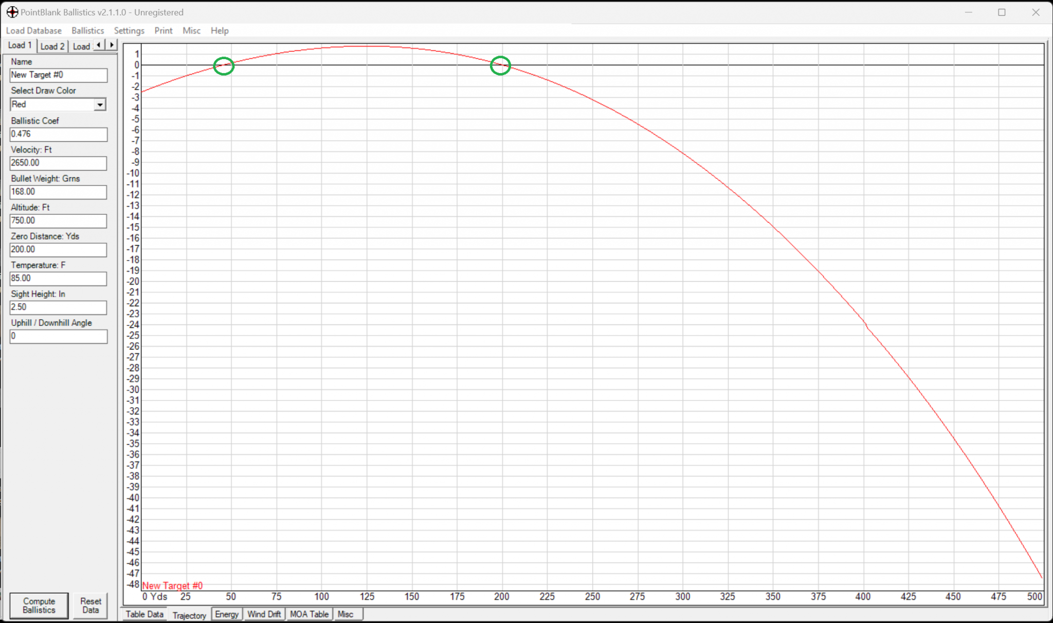

    I'm trying to find one that shows that accurately in my collection of old PC apps. One with data inputs for the concept of 'scope zero induced barrel inclination'. I think they are out there, but I only have low-end programs that were free or open source.
    The two yardage points below, which are likely not accurate, are in the trace data table. They're suspect because the program doesn't have inputs that accurately account for barrel inclination in relation to the zeroed reticle. Most graphing ballistics programs appear to just draw a horizontal line that intersects the parabola's vertex.
    Reactions: Steel+Killer
    Most ballistic apps show the bullet trajectory in relation to the LOS. For example, Ballistic AE generates a table with the “bullet drop,” but that figure is just the bullet path in relation to the LOS. And as @DocUSMCRetired said above, the AB app does the same. If you hit the “ballistics chart” or graph button you get the graphic you are looking for. If you want to see your bullet path relative to your LOS for an 800 yard shot, set the zero distance equal to 800.
    As @Tanstaafl said above, the app-generated graphs show a very very skewed picture because the y and x axes are way out of proportion.

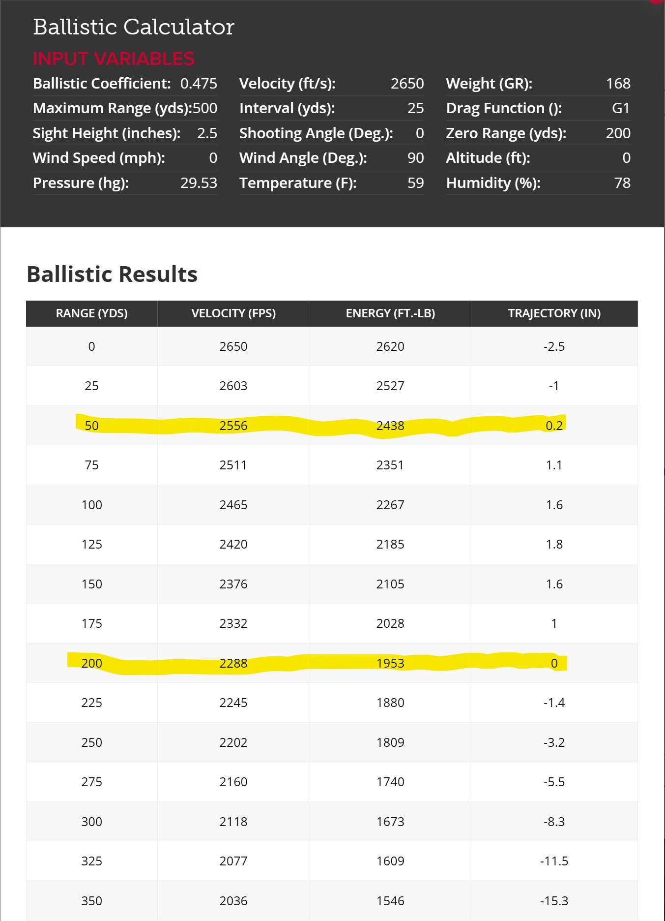

    Choose 308 and 200 yard zero from their presets. You will see a zero about 75 yards and zero again at 200 yards. You can also enter your own data for other calibers if you know the inputs.
    Thanks, the ShootersCalculator is a good source that answers the OPs original request. It, and trace data from any decent calculator, also confirms the BallisticCalculator graph. The 200 yard zero is good for illustrating all of this. I was just way too focused on the not applicable 100 yard zero. My bad.

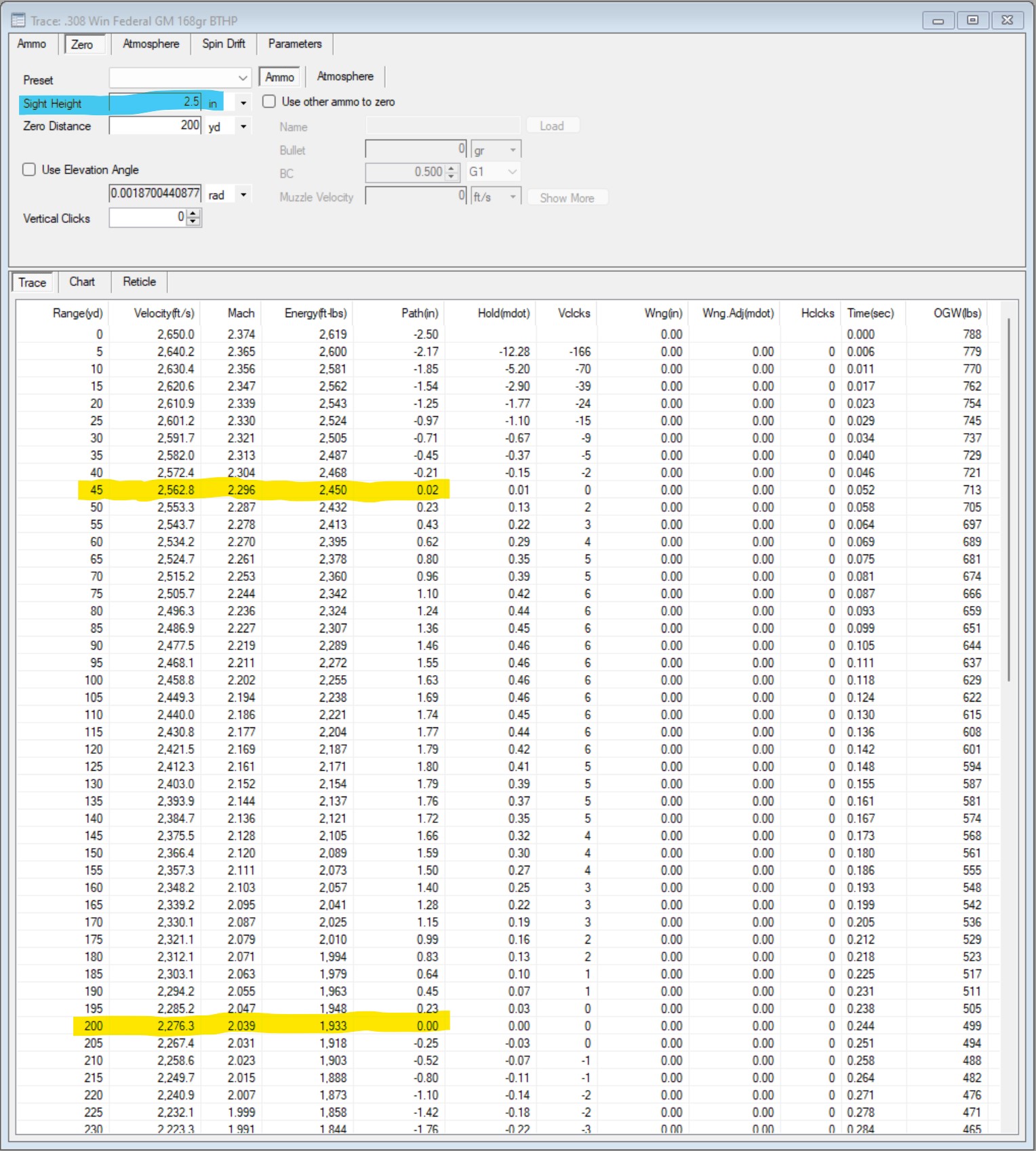

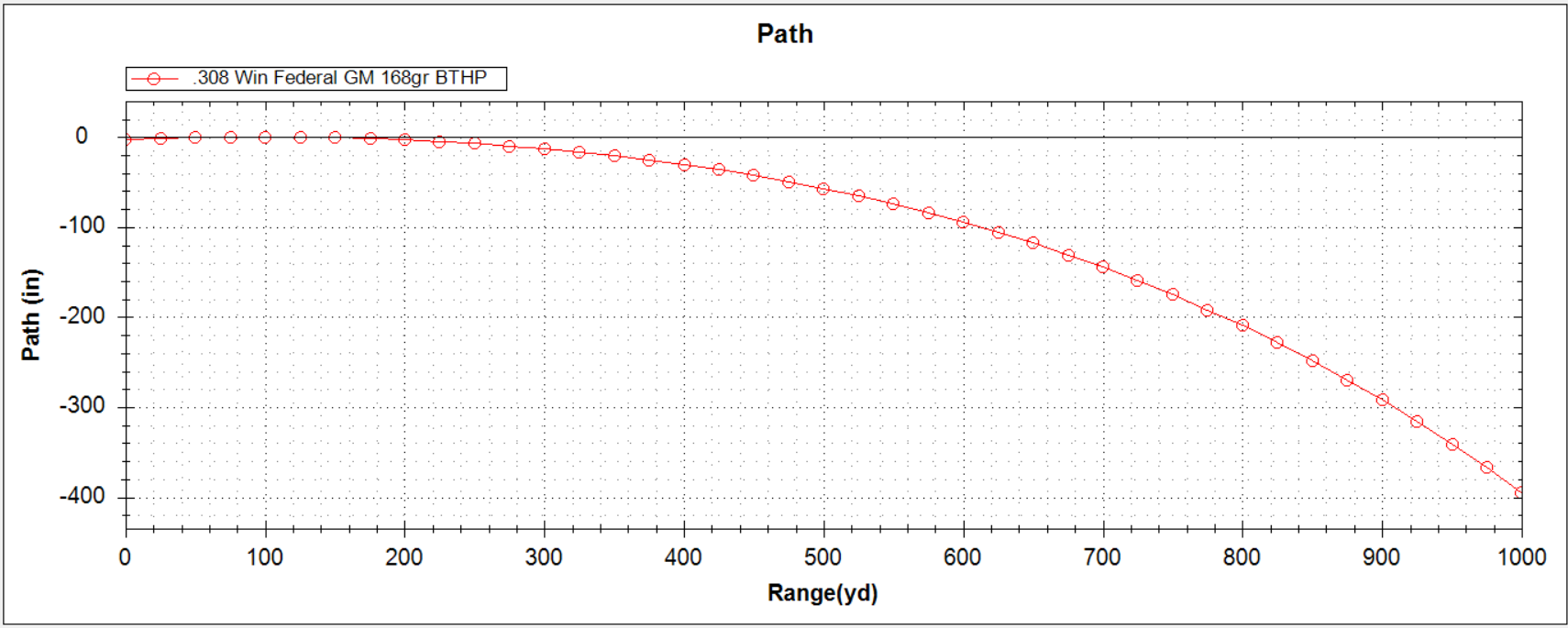

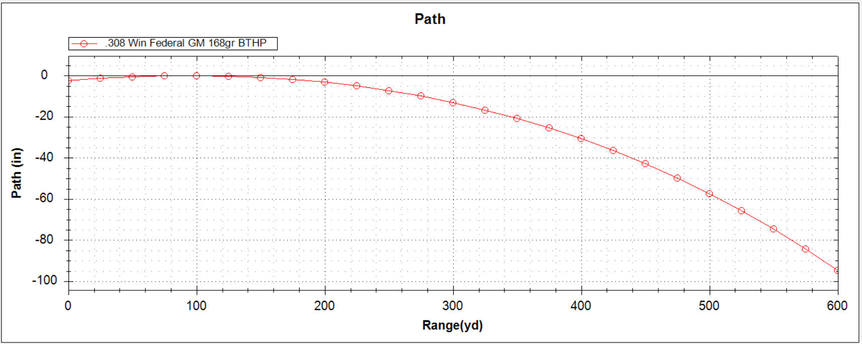

    The following may be obvious to most of you, but I’m recapping for myself and maybe some others.
    The trace data for all tools show basically the same thing for 168gr .308 with a 200yd zero. Both graphs show a horizontal LOS line that represents the shooter’s eye looking through a scope whose center is 2.5” above the barrel’s bore. The data and graphs illustrate that the bullet rises in relation to the scope LOS due to the slight inclination of the barrel in relation to the zeroed reticle, and that this arc crosses the reticle’s center at two points. Bullets can never rise in relation to the barrel’s bore of course. The two zeroes are around 45 yds and at 200 yds. You could get them to agree on the short range zero if you tweaked all the misc factors to match up.

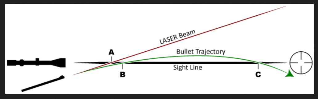

    “…the drop related to bore axis being the least important, with bore axis labeled as 'Laser Beam' in Windrider's picture. It is not a drop that is useful for anything out in the world…”
    Precisely put!
    This phrase from @Tanstaafl needs to be memorized by shooters seeking a firm understanding of exterior ballistics. That’s why I call it the fake line in the sky and the source of much confusion for new shooters and some experienced shooters who claim the bullet is falling the instant it leaves the barrel, notwithstanding the trivial classroom exercise of a barrel pointed parallel to the earth’s surface.
    Precisely put!
    to be memorized. That’s why I call it the fake line in the sky and the source of much confusion for new shooters and some experienced shooters who claim the bullet is falling the instant it leaves the barrel, not withstanding the trivial classroom exercise of a barrel pointed parallel to the earth’s surface.
    Most don’t even know what drop is vs what they hold or dial.
    Yea that picture is terrible because of the laser beam label,bet it was the best I could find at that moment but it illustrates what we are talking about here.

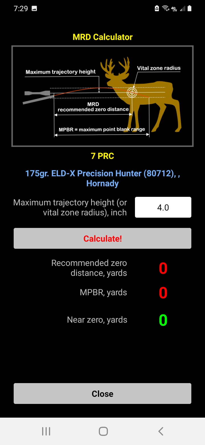

    Thanks for the reply for full disclosure this isn't really for me. I understand ballistics pretty well. Its for a friend I hunt with that I am trying to illustrate to him how some rifles can have two zero points depending on what distance the scope is zeroed at. Sometimes when you can show a graph even though the trajectory of the bullet is highly exaggerated it helps to visualize and understand better.
    Strelok Pro.
    Go into you rifle data. Select the MRD calculator. It is for MPBR but illustrates what you trying to say.

    Bullets do not "rise" on their own, they rise if they are launched at an upwards angle.
    Now if you were trying to hit a target that is below your position, the bullet wouldn't actually "rise" at all as relative to your ground position, as you'd be launching it at a flat or negative degree angle so your curve would be adjusting a rate of fall.
    This is the problem with those graphs, they show the rifle as flat when they should show the rifle as pointing just a bit upwards.
    You are of course correct. They rise because the launch angle is positive. Muzzle velocity is a “vector” (which has a direction as well as a strength) that can be split into its horizontal and vertical components. If something is moving at a positive angle to the horizontal, think of it as moving horizontally with a certain speed and vertically with a certain speed. This total velocity vector has two parts: a horizontal velocity vector and a vertical velocity vector. When a bullet is fired with a positive launch angle, it has a positive vertical velocity vector (it is rising relative to the tangent to the earth’s surface at launch point).
    Good stuff. That has to be the most words ever used to say that a barrel has to be pointed up for the bullet to go up.
    The issue is up relative to what? The only solid relationship is the bore centerline. The barrel is nominally at an up angle, relative to the sights. If I shoot downhill, is the barrel angled up or down? Up in relation to the sights, down in relation to gravity. Now, if I shoot downhill, does the bullet ever get above the shooting position/barrel? No, nor does it go over the extended centerline. If I shoot uphill, it's ALWAYS above the position/barrel, unless it travels far enough to return to Earth. Then, it STILL may not be below the barrel as it may land on a surface higher that the shooting position.
    That makes your description dependent on multiple variables, therefore vague and less than useful.
    I am pretty sure 99% of most shooters would assume and understand that I was talking about shooting horizontally parallel to generally flat ground / earth not some high angle shot up or down a mountain.
    I am also betting that most people shooting rifles are shooting horizontally parallel to generally flat ground / earth not some high angle shooting up or down a mountain.
    Give my regards to Mr. Strawman I bet you two are a hoot at party's....... :)
    but a bullet will certainly rise above the bore at its highest point in its trajectory when shooting long range.
    Obviously, if the barrel is level the bullet likely wouldn’t rise above it.
    I guess a simpler way to put it is it really depends on the angle of the barrel when the bullet leaves the muzzle.
    Not exactly a strawman when you reference the issue in your own post. And 'likely' wouldn't rise above it? I presume you refer to ricochets. If words are to be useful, they must have meaning. You said 'rise above the bore', which is simply not accurate.
    I’m not trying to be argumentative or mean spirited in this exchange. Sorry if it seems that way. I enjoy a healthy exchange of ideas. Thats how we learn. I expect you and @Steel+Killer have a good grounding in exterior ballistics. Sometimes semantics get in the way of learning.
    The direction that the barrel is pointing at bullet launch (McCoy calls this the velocity vector V) determines two key trajectory parameters:
    1. It sets the launch angle
    2. It gives us the initial velocity vector
    For uphill or downhill shooting, the site angle can be negative (downhill) or positive (uphill) but the launch angle (McCoy’s superelevation angle), relative to the gun-target line, is still positive resulting in the typical arched trajectory. However, for uphill and downhill fire, the gravity acceleration vector will not be perpendicular to the gun-target line. This results in the bullet hitting the target high when compared to the standard case of the gun-target line parallel to the earth’s surface.
    What I’m trying to do is clear up some long-held misconceptions—perpetuated mainly for magazine “gun experts”—regarding the imaginary line that extends to infinity from the bore. (Forget the trivial classroom exercise of a barrel horizontal to the earth’s surface).
    1. Shooters are wrongly led to believe that their bullet is falling from that line until it hits the target.
    2. Shooters are wrongly led to believe that the bullet falls from that line at an accelerating rate equal to the gravitational constant g.
    At the moment of launch, the bullet has a positive vertical velocity vector, notwithstanding the trivial classroom exercise of a barrel pointed horizontal to the earth’s surface. (Sorry, I have to repeat this or some troll would jump on the old HS exercise). And yes it is being accelerated downward by the gravity acceleration vector g (g=32.17ft per second for each second of flight). This simply means the bullet’s upward velocity is slowing due to gravity. This upward velocity slows and becomes zero at the apex (max ord) of the trajectory. At that point, for a brief instant, the bullet has zero vertical velocity. The bullet then starts to fall at the g acceleration rate.
    1. Shooters are led to believe that their bullet is falling from that line until it hits the target. because it is.
    Yup! I’m aware that you know what you are talking about, however, your terms are still inaccurate to describe what your trying to convey, no matter how much you quote McCoy.
    “…imaginary line that extends to infinity from the bore…”
    No matter how you couch it nor how much you think that it’s a high school exercise, the bullet does not ever, under normal circumstances, rise above that imaginary line.
    I’m anxious to see your math and an illustration showing me when that will be the case.
    I believe that you are confusing line of sight with the imaginary line coming from the bore, that begins at the chamber, goes through a point in the center of the bore and extends to infinity.
    The laser beam. At the max ord, the bullet will never be above the line of departure because that line goes out and up at the same angle into infinity. The bullet is obvious moving forward but even though “it’s rising” it’s still dropping which is why I’ll go back to my earlier statement that most people don’t know what the drop number actually is
    Reactions: lash
    No use responding to the low-IQ flying monkey. Not worth your time or attention. Best to just hit the ignore button.
    Lolol! That’s right. When you can’t respond intelligently, always respond with an insult. That way people instantly know that you’re right, even if you can’t express it in words.
    An object, be it a bullet, ball, or person, cannot fall from a height if that object is never at that height. The bullet is never at the height of the line of departure except for the brief moment at the tip of the barrel. After that, it starts its journey on its parabolic trajectory.
    Reactions: Ronws
    I will concede that it is possible that for a nano second after the bullet completely exits the barrel that maybe this is true. Maybe. But one nano second later it is not.
    It is my belief that mathematics would prove that even for a nano second it isn’t true. Perhaps the only time it’s true is while the bullet is traveling down the barrel as it is forced into that line of departure by an object and gravity can’t yet act on it.
    Reactions: lash
    You’re missing the point. In all my posts, I have never indicated the bullet travels above this line of departure. This is because it’s an insignificant point and not relevant to the bullet’s trajectory. Go back and read my posts.
    If you add in Aerodynamic Jump, then it can happen.
    It is not insignificant. That line of departure is what makes any trajectory possible. Without considering that line of departure, you have no idea what the trajectory is.
    We spend piles of money on angled mounts and high end glass just so that we can control that line of departure to the extent that we know what the trajectory will be every time. 😁
