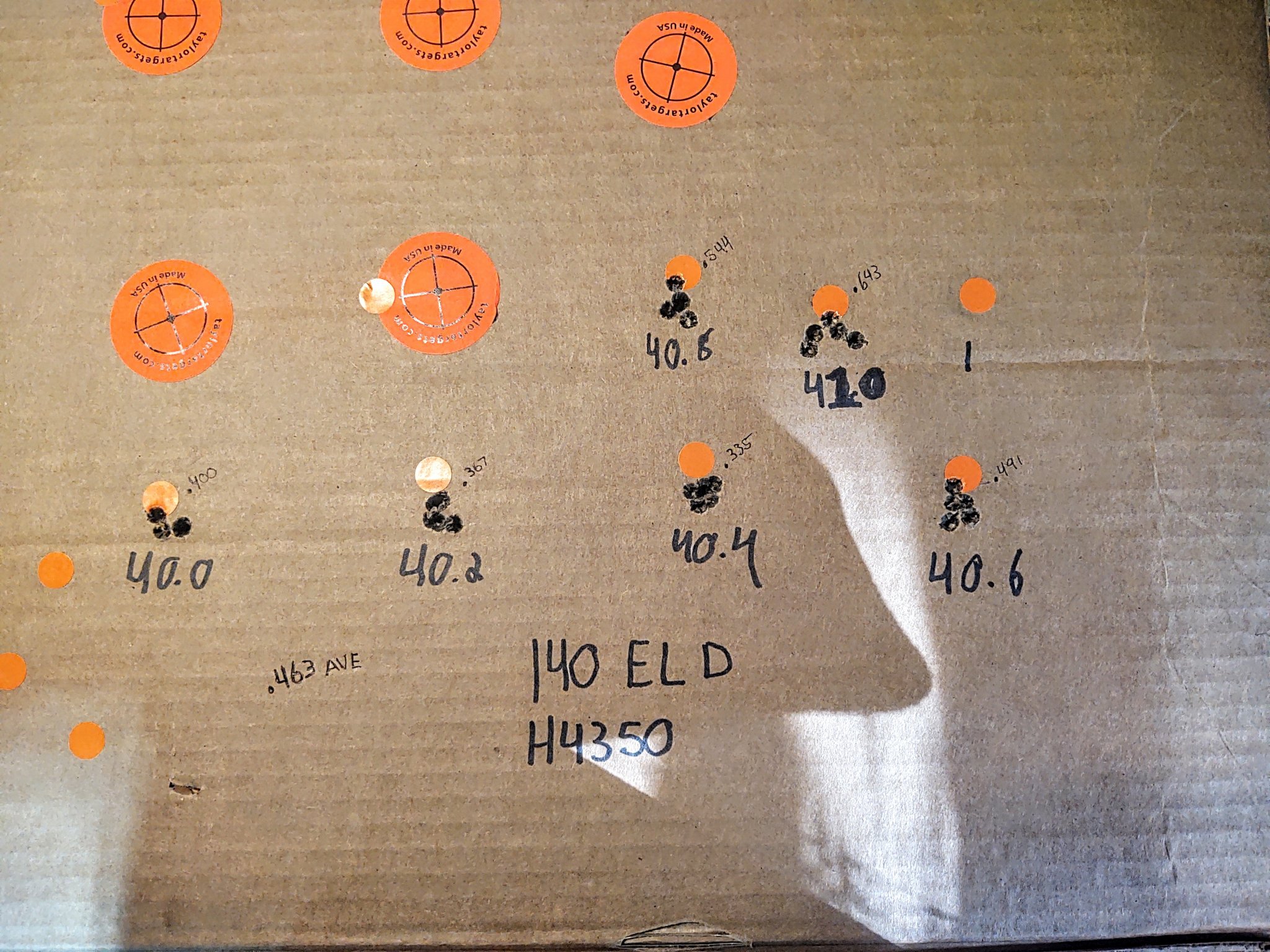

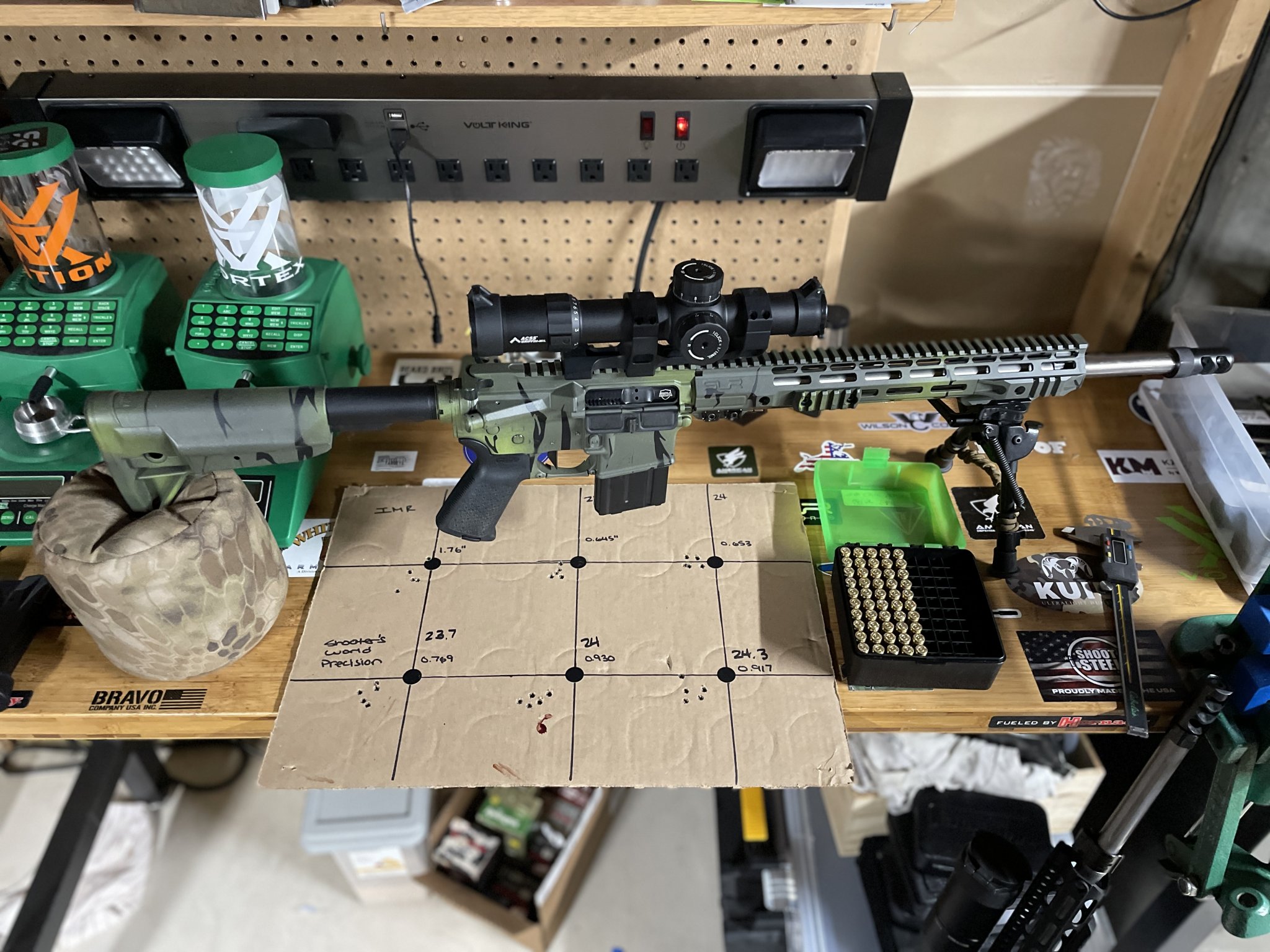

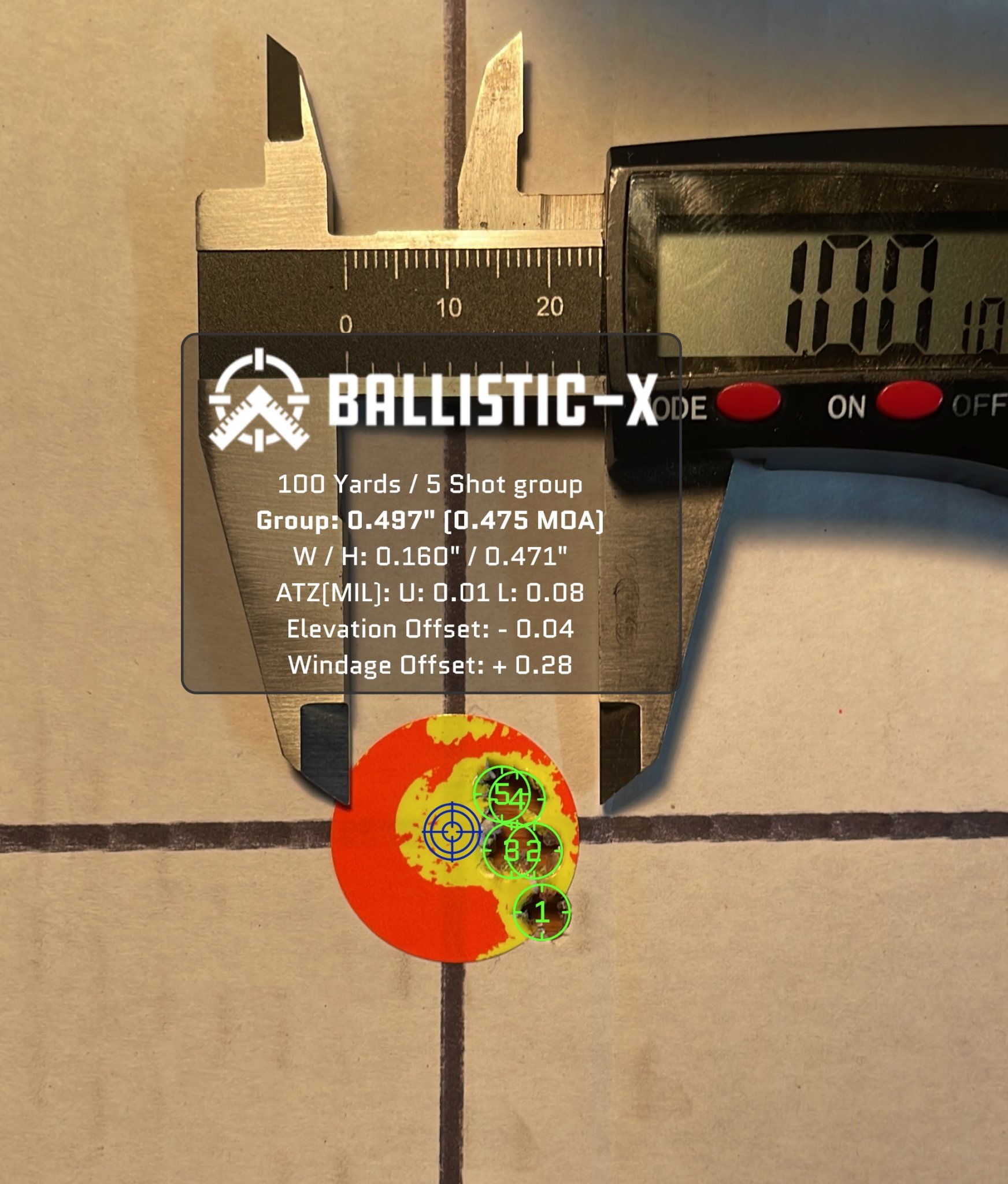

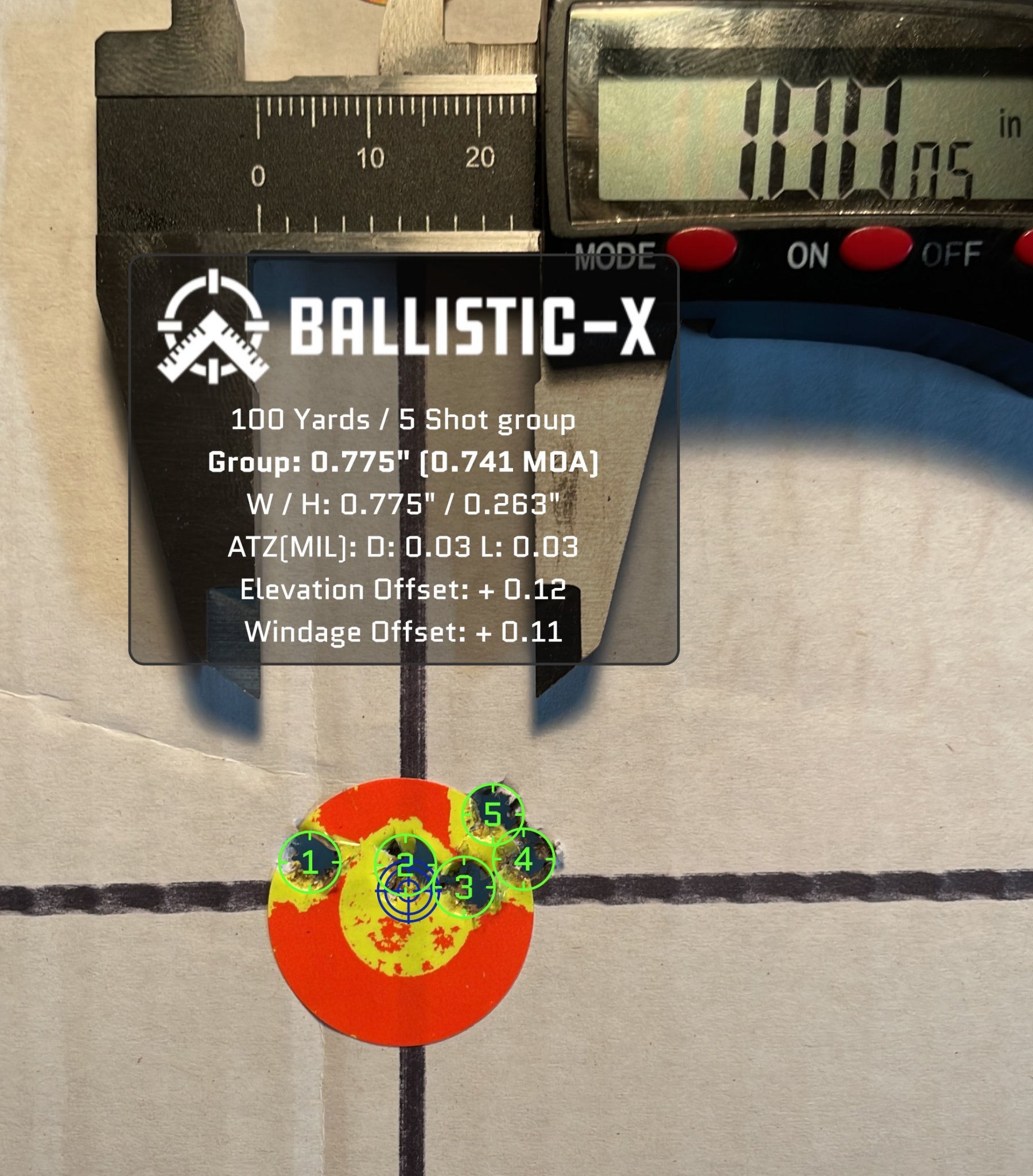

This is from yesterday, I started my first round of load development for a Custom 6.5 Creedmoor 18" Bartlein I put in one of my LaRue OBR's that I'll be releasing a Review/Range Report on here soon.
So basically I shot a 6x5 each group a different load and I still averaged Sub 1/2 MOA... So yeah I can shoot the difference between a Bartlein and a WOA, Shilen, Criterion.
Every rifle in my stable has either a Bartlein, Krieger or Proof barrel even my "Blaster" 16" Recce rifle has a Krieger in it. Why have ANY gun if the accuracy is mediocre?? There's nothing wrong with putting a Single Point Cut Barrel in a hard use rifle, what do you think is in the KAC APR and APC?? A Krieger!

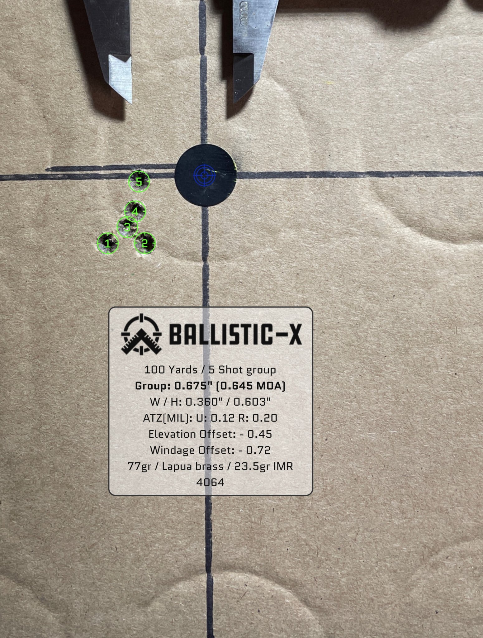

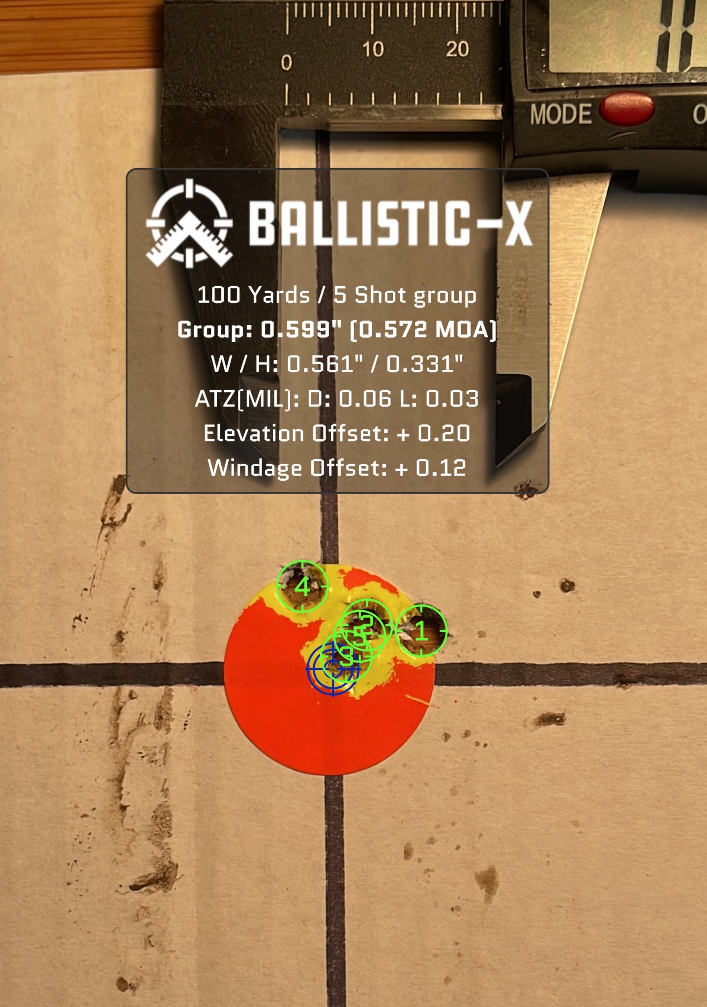

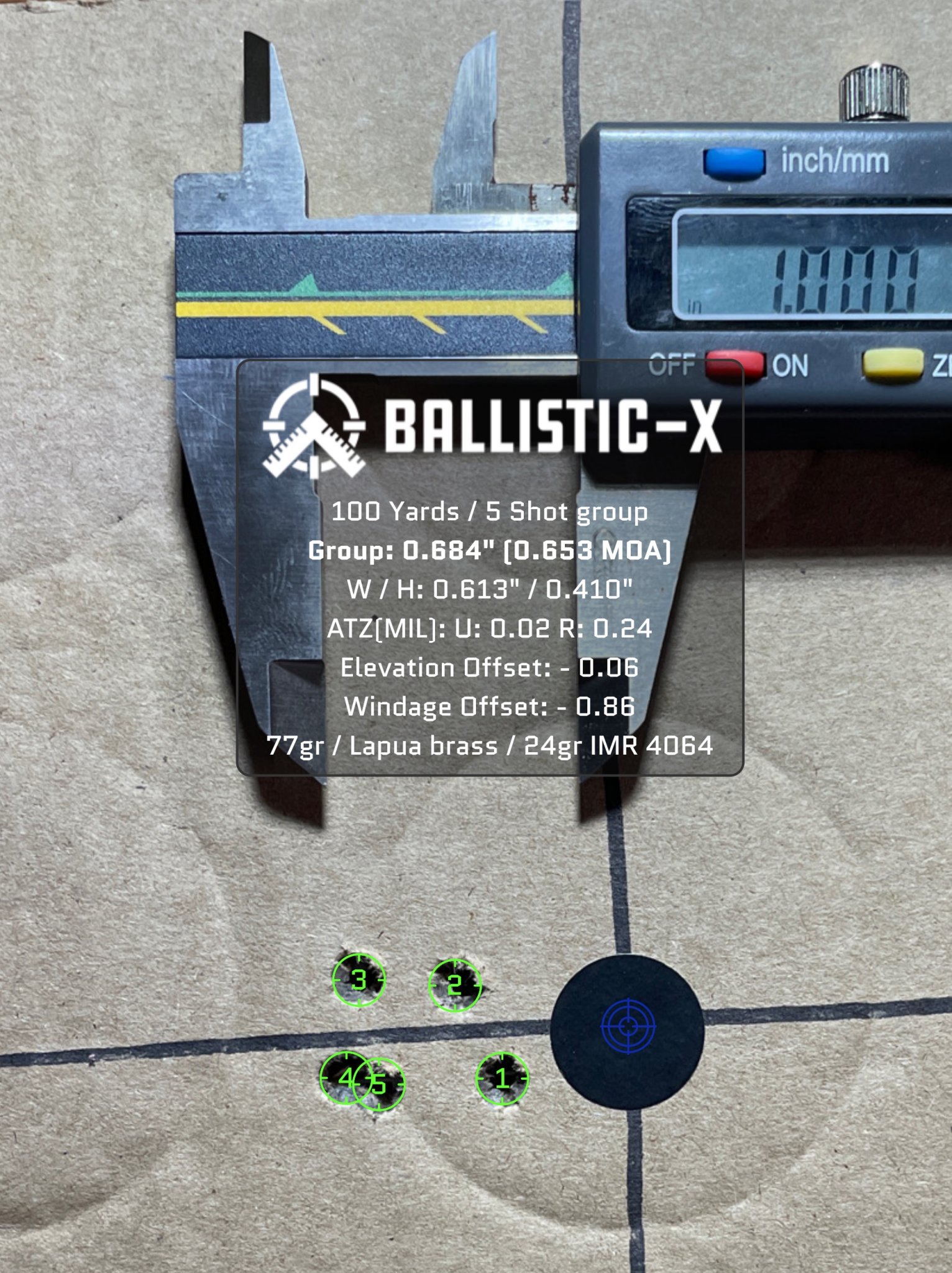

Yes absolutely Proof, Bartlein, and Krieger are awesome in gas guns. Yesterday I was actually thinking about posting a 500 round performance review on my Proof barrels for the very reason that there isn’t a ton of content about them for ARs. I have 2 Proof barrels on gas guns that both perform extremely well.
AR10 is setup with a 24-inch Proof stainless barrel w/ +2 gas system, JP lmos bcg, JP SCS, Triggertech Diamond, and a Vortex 5-25x PST Gen II and this rifle shoots small. I want to say that 3/4-1 MOA groups happen on bad shooting days. On range trips, I usually set up a 4"x6" IPSC at 600 yards and have no issues connecting. The only hiccup I had with this barrel is that I had to open up the gas port a tiny bit with a reamer, but after doing that reliability has been 100% and accuracy has always been stellar. I have about 400 rounds down the tube running 140gr ELD-Ms, Hornady Brass, 41.7gr H4350, and #34 primers.
AR15 is set up with 18-inch Proof stainless barrel, Rubber City BCG, Geiselle SD-E, Primary Arms Platinum 1-8x Griffin Mil and I'm still able to shoot in the 0.6s from prone and had no issues going out to 700 yards on 2ish MOA targets. Keep in mind this is a DMR type setup and a different optic wither magnification could probably help shoot smaller. Round count is just over 500 and my accuracy load is 77gr SMK, Lapua brass, 24gr IMR 4064, #41 primers.
