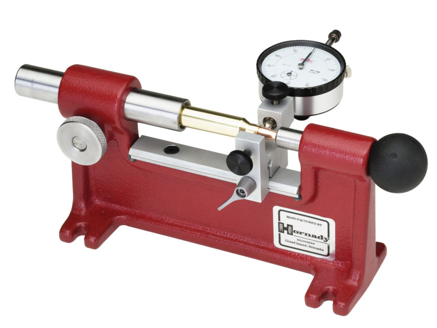

By this it would seem to indicate that you are at .0005 concentricity on center.
Or common parlance 5 ten thousandths.
I'll wager your measuring device isn't up to that level of metrology.
R
Watch this:
The first cartridge they check.... that's what my gauge reads. "less than 1 thousandth." Each gradation is a thousandth. The gauge stays within the single gradation
Don't know what to tell ya. That's what my gauge reads,when I use the Wilson seater dies.. How much you want to wager?
Watch this:
The first cartridge they check.... that's what my guage reads. "less than 1 thousandth." Each gradation is a thousandth. The gauge stays within the single gradation
Just because the gauge "reads" .001 of movement doesn't mean it is capable or accurate.
I have "guages" that read into the ten thousandths and can do it consistently.
I'll wager there is more than .001 of play in the casting/cylinder securing the bullet end.
In other words just because there is a video on the internet doesn't verify their measurements or standards.
I've lead you to the water and you'll have none.
I'll spare you the loss of any wager.

Okay here goes nothing...
The Hornady gauge in a perfect world pins both ends of the cartridge and you measure the jump-rope bend present in the middle (usually near the start of the ogive).
If the tip of your bullet is deformed, you read runout on the gauge. If there is actual runout in the seating of the bullet, you read runout on the gauge. If your extractor mangled the rim of the case, you read runout on the gauge. You can bend the neck to correct for a mangled rim and read zero runout at that 1 point on the gauge, and have made your problems worse.
Think of how barrels are indicated in for chambering. You accept that the bore is non-concentric to the OD, and measure off of TWO points to get it running true. Measuring off of 1 point will give you positional correctness at that ONE point, but does not guarantee axial correctness anywhere, and does not guarantee positional correctness anywhere besides that one point.
More to Rthur's point, there has to be clearance between the spring loaded cylinder and the housing for it to slide back and forth. Take your gauge, load up a cartridge, then push back and forth on the spring loaded cylinder. You can ASSUME it self-centers, but you don't have a guarantee of that. Likewise on the back end, there is slop that is hard-biased from using the tightening screw to hold that cylinder in place.
Not saying the tool is useless, broken, etc... It just has limitations and there are many variables that have to be checked before you can definitively say that bullet seating runout is what is being measured, and what is being measured is valid.
He didn’t say it was malfunctioning, he said that it likely didn’t have the degree of accuracy built into the instrumentation to read accurately down to the level you stated.
Just because it has a graduation doesn’t mean it’s accurate. It’s a novel concept, but I guess you’re just working on faith that it’s accurate/correct.
He's definitely workin' on faith that it isn't accurate / correct.... given he's never seen or touched the gauge. :)
