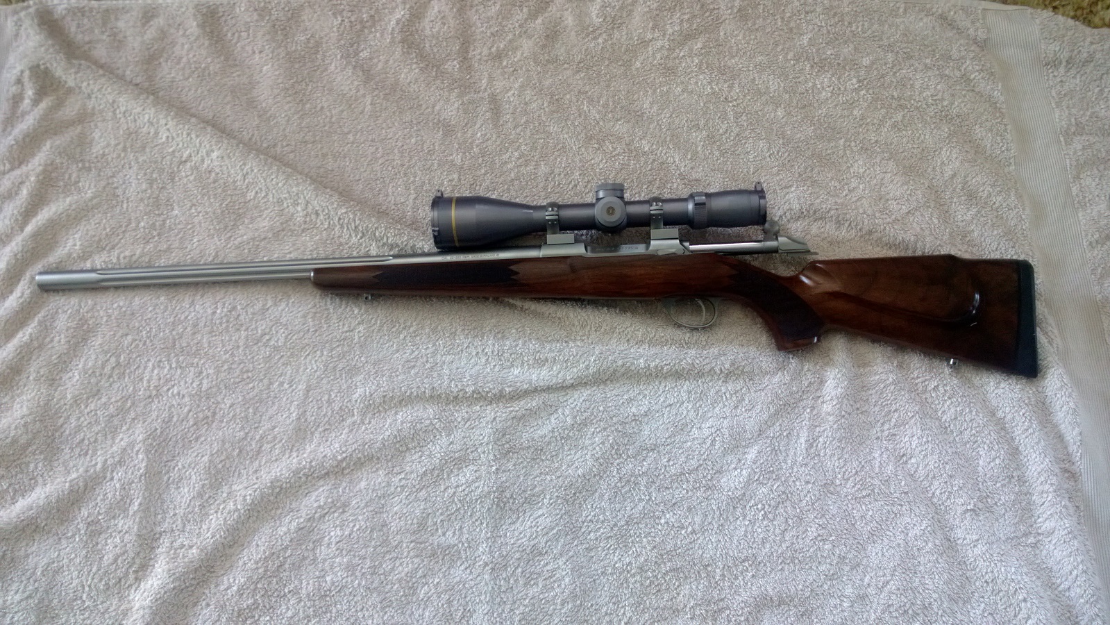

We get the Sako 85 varmint fluted stainless with walnut stock here in Aus (I think it's an aussie only special) I've got one in 22-250, lovely rifle, definitely worth the extra coin over the Tikka.
