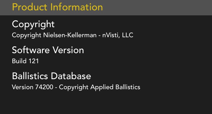

Doc, FYI - I bought my Kestrel Elite Ballistics last week (1/25) and the firmware version was 1.17 - had immediate problems transferring profiles. As of yesterday, NK had no quick fix other than waiting for 1.18. Build number on my app was 118 - is that the latest?
My app build is 121
Moot point but it was later than that - I first downloaded the app on the 26th and got Build 118. I haven't tried the newer build because I'm pretty sure the main problem is with the FW (Kestrel independently won't delete all profiles, even when adding Factory Restore).
I’m also on build 121 now- the build that fixed my issue.
I’d still suggest updating the app. Even if it doesn’t solve the problem, there was clearly some kind of glitch in the older app- who knows what could activate it, then you’re frustrated with two problems.
