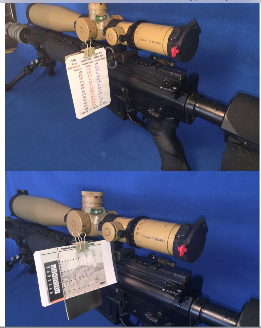

Tactical luggage tag, with data cards for DA’s from -2000 to 15000 folded up inside.
JBM online, matched to real dope and shrunk to print the size I want with MS Word. Flip side has the further ranges out to 1200.

Those would be great for the range bag. Good idea. I also want to have just the little card for quick reference. At the range or course I'll have cell phone. This is for back up or if I ever get drug out to go hunting.

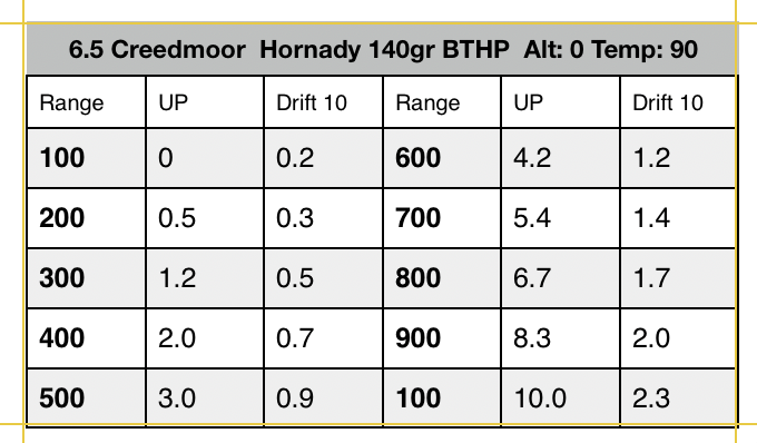

I spent some time with pages and a business card template and came up with this for the mil/mil scope. I just saw the typo- need to add a zero to make 1000. Of course I need to actually measure scope above bore height, and a real chronograph would help too. This should get me in the ball park.

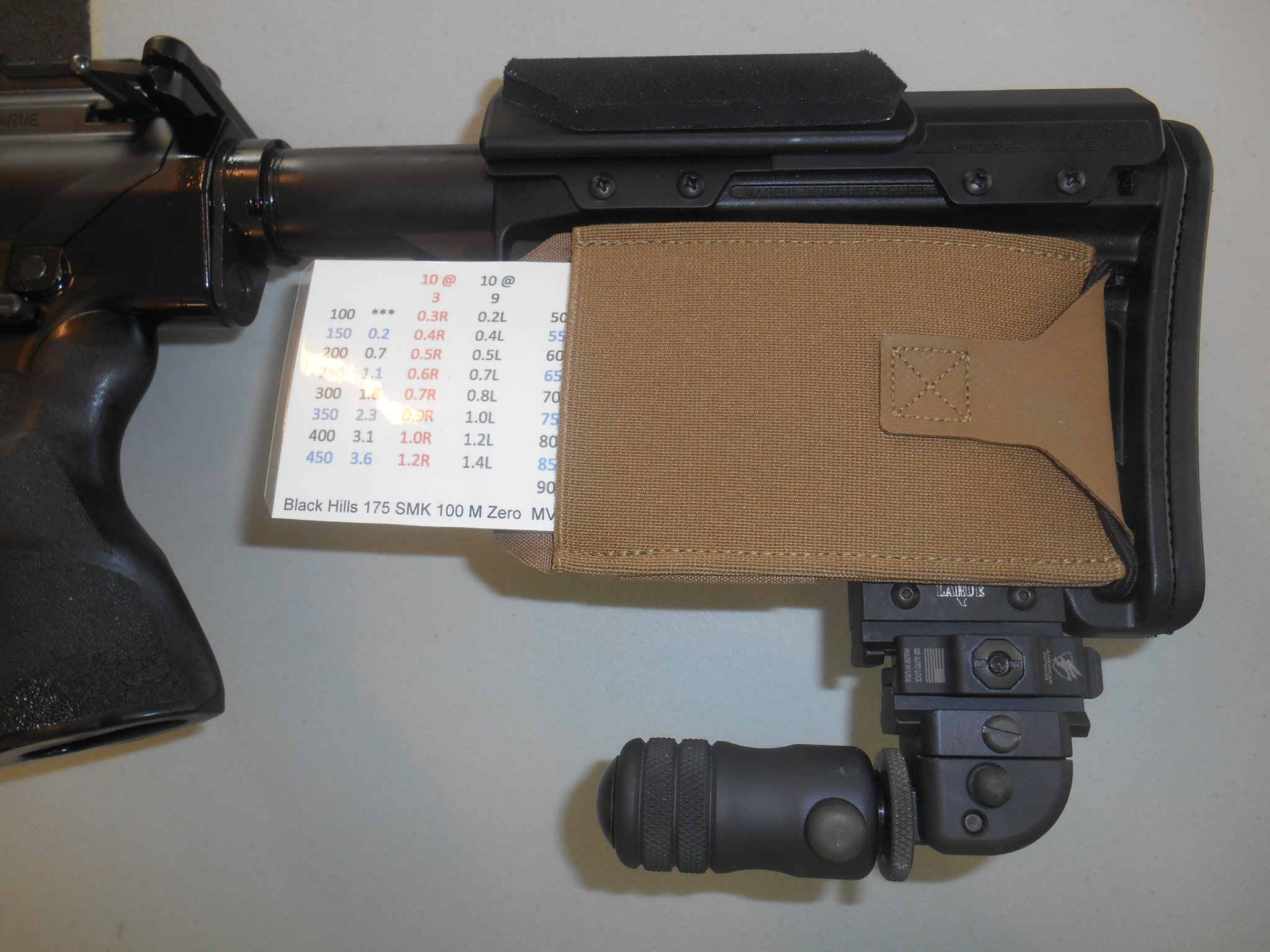

Make different DA dope cards. As big as will fit on the stock. Laminate them.
Use clear packing take to affix the one you need to rifles when DA changes enough to swap cards, cut it off and tape on other one.
Keep using your laminated cards and just tape the one you want on.

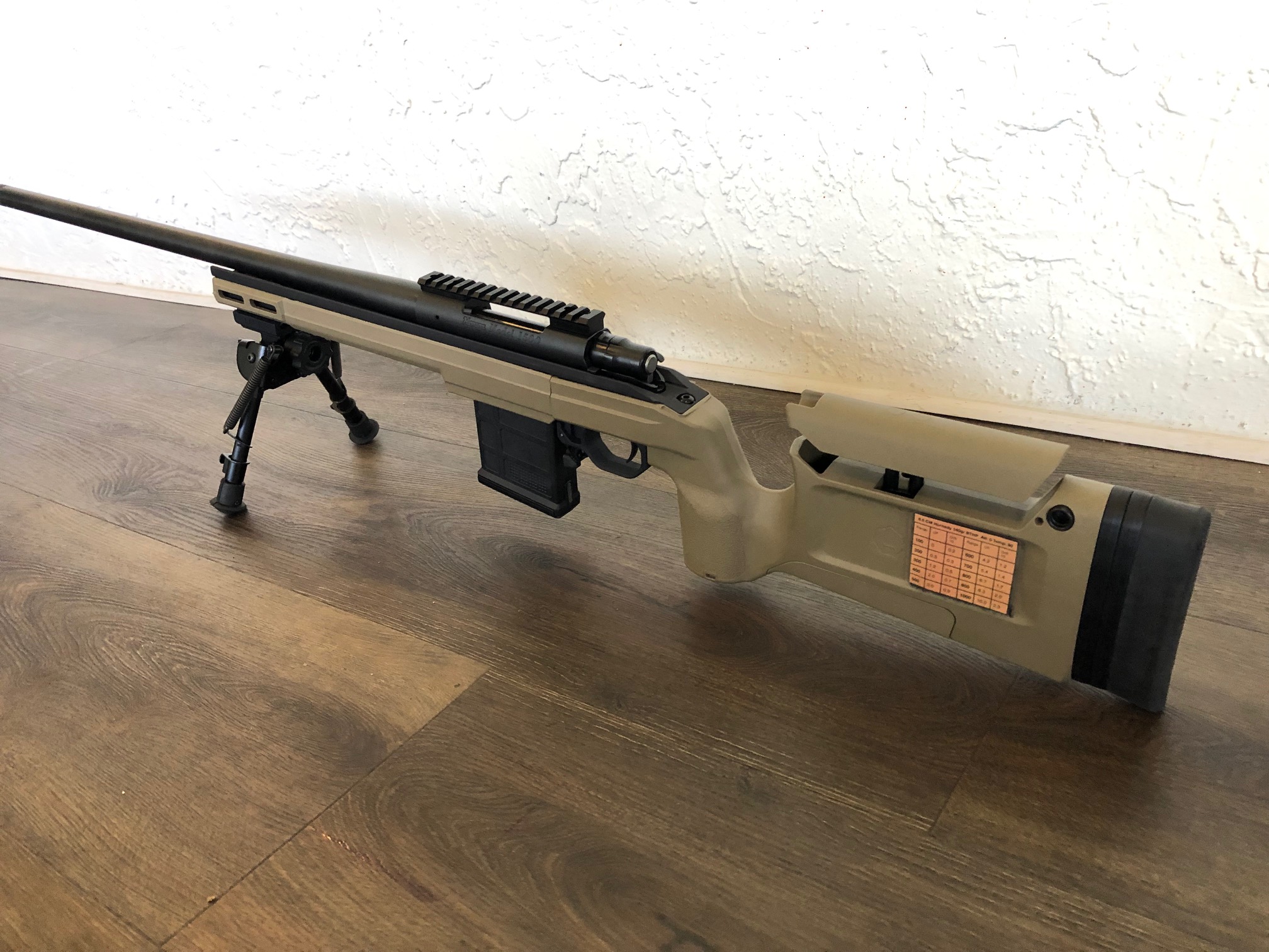

I made a chart, laminated with business card sized pockets, cut to size, and stuck velcro on it. Now with the format, I can make updated tables, laminate, and velcro in just a few minutes. As you mentioned, I could make a stack of these for the range bag with different DA's. However I'm in very southern Florida where there is no elevation and the temperature stays within 10 degrees. I made this card for zero elevation. DA is about 2000 feet, so I should make a card for that as well. White paper looked a little un-tactical, so I picked "brown" but it's no match for FDE, I'll have to play with the color settings.
