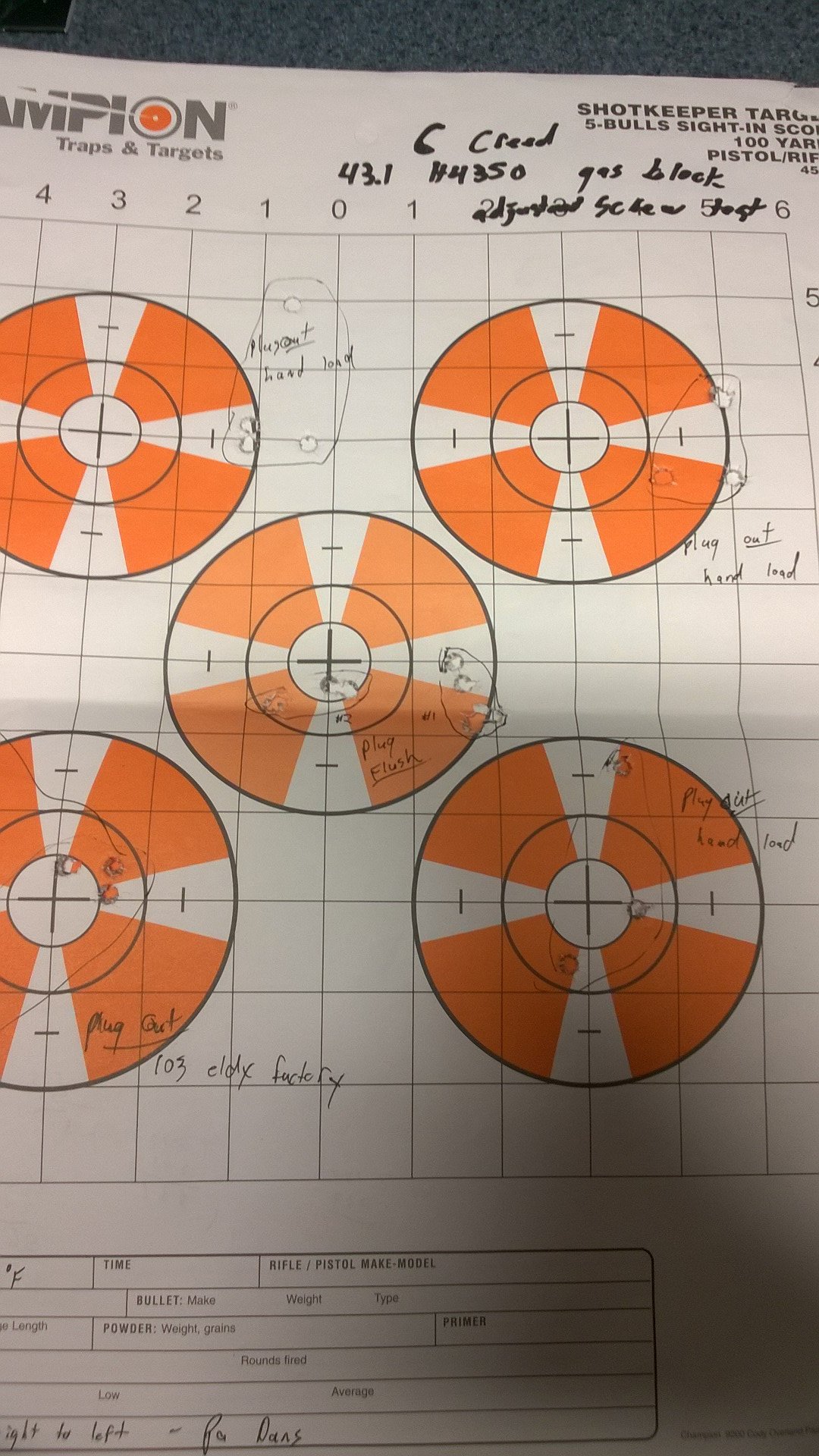

It definitely makes a difference in group size. With the adjustment screw completely out (like laying on the bench), my 6mm shot the 103 Factorys pretty well, but sprayed my 87gr V-max handload all over. With it the screw flush to the muzzle end of the chamber, it shoots both pretty well, but always with enough flyers that I can't call it "good".
I think I posted this elsewhere, but even with the screw completely out, like 95% of the gas still goes down the tube. I determined that with the gas block off, using my air compressor. Shooting suppressed, I only had to add like 1/4 turn on the adjustable gas key to get it to cycle the same as with the screw in.
Like you said, it's one more variable that I'd rather not have. This barrel / system has been the most consistency inconsistent one I've tried to hand load for. If it always shot ~.7 MOA, I could accept that. But no, it regularly shoots several in damn-near the same hole, but with a flyer mixed in.

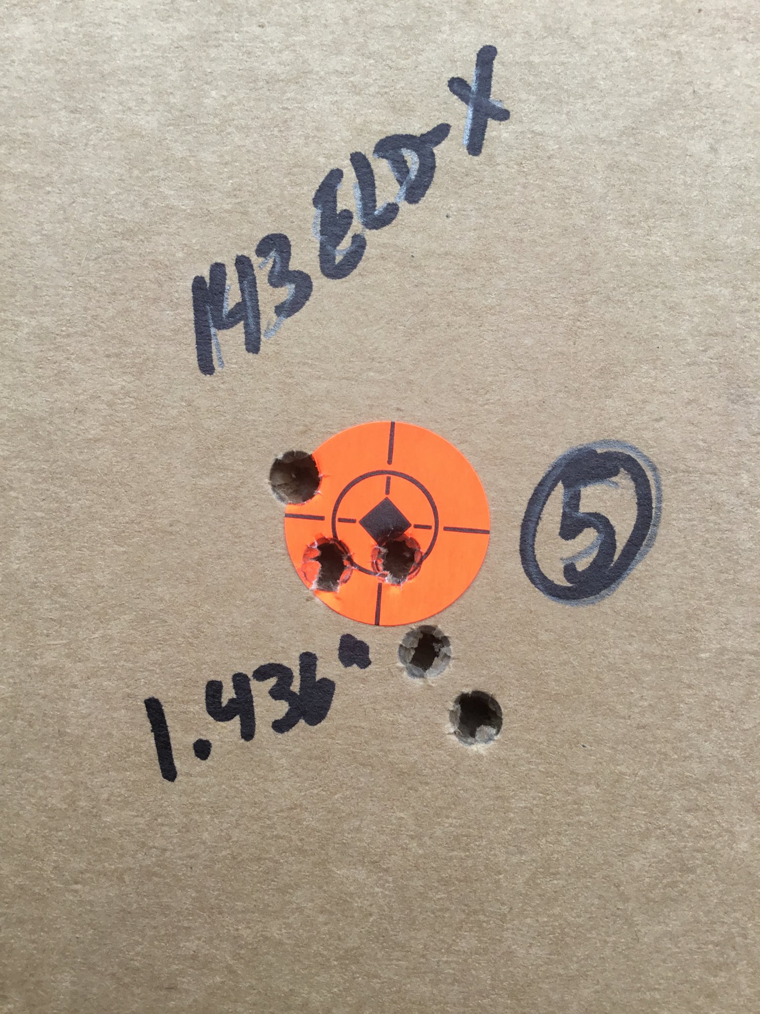

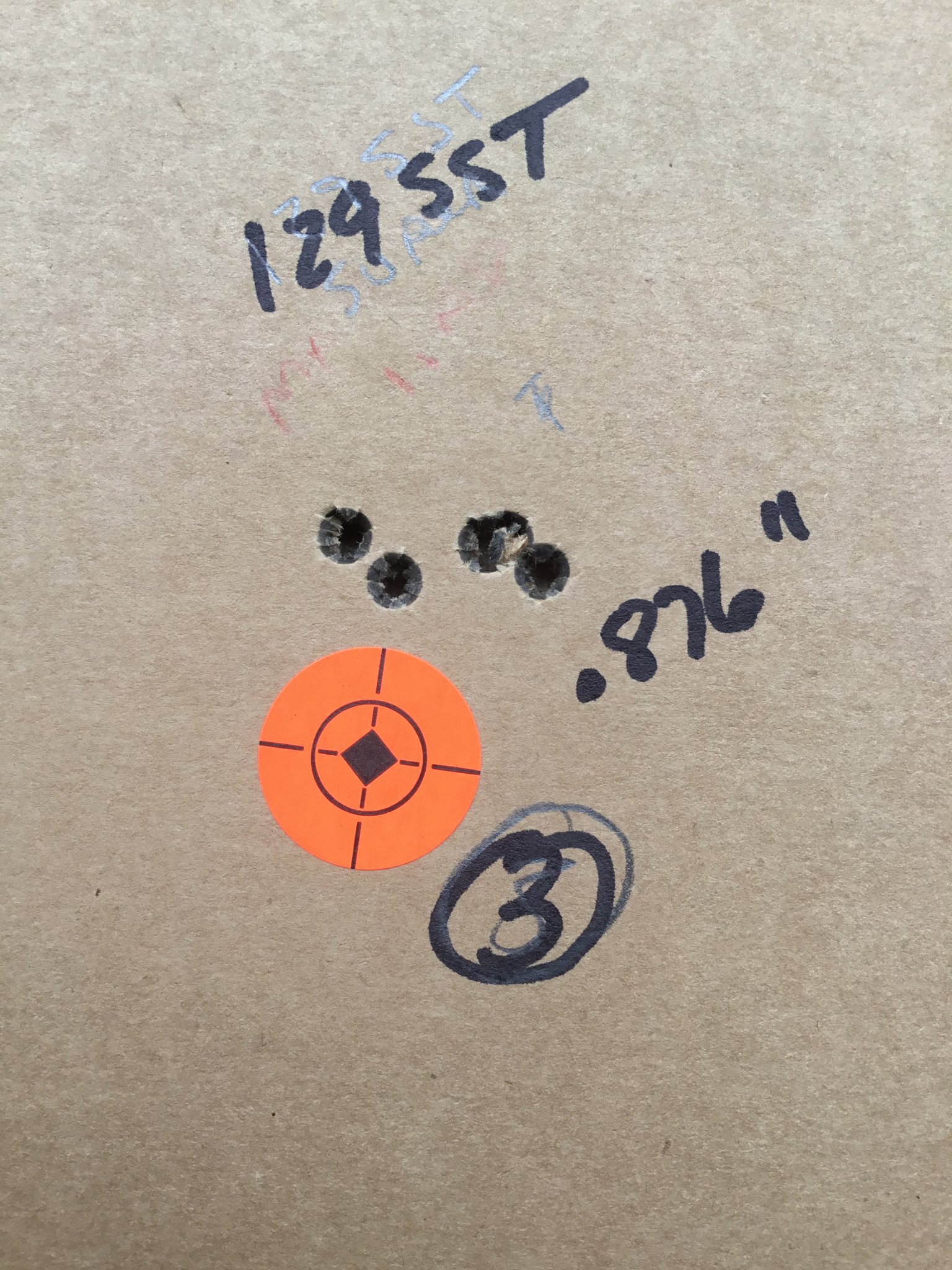

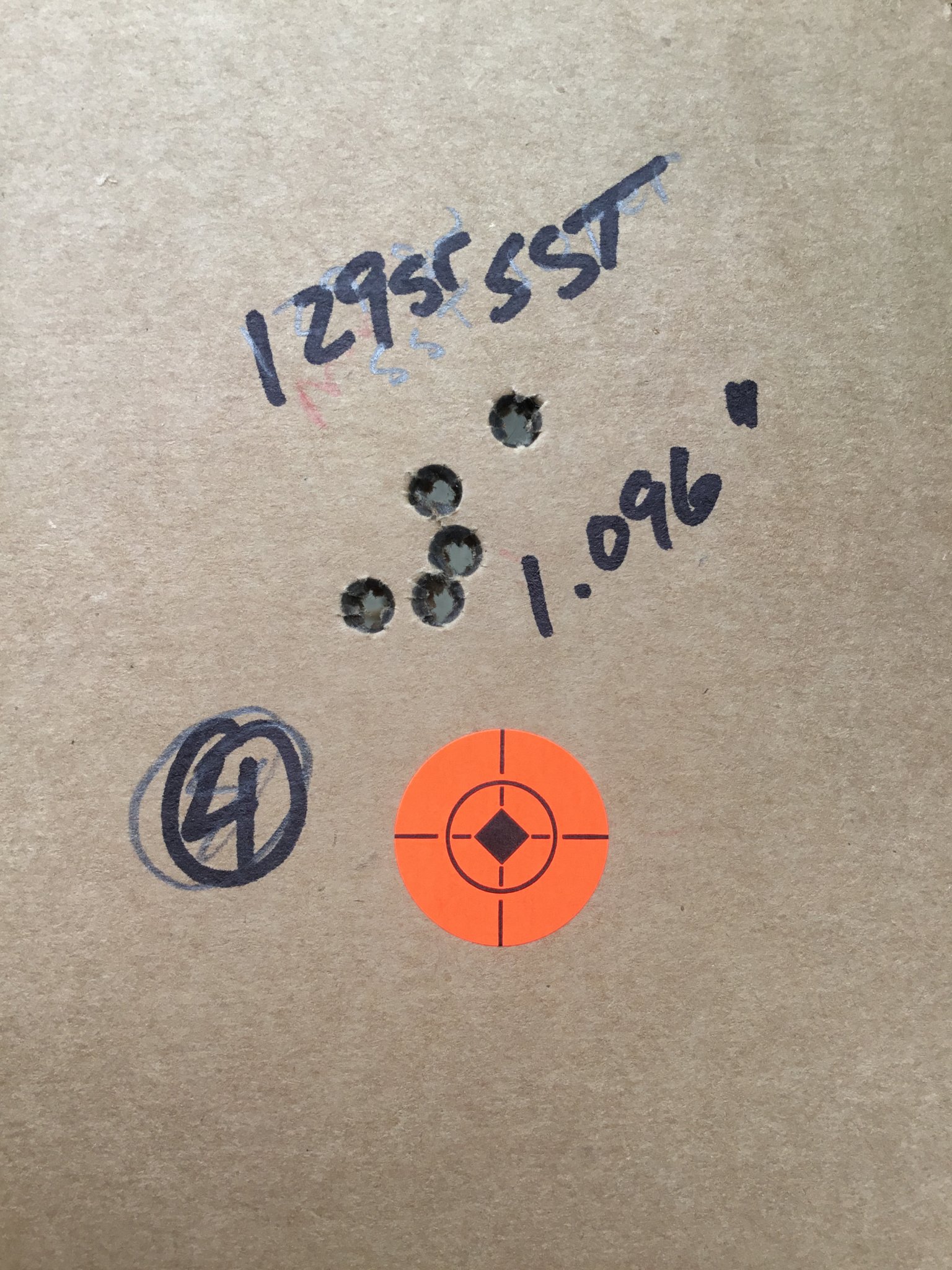

Here's mine shooting like complete dog shit with the adjustment screw removed.
The two better, but still sub-par groups in the middle target are the same load with the adjustment screw flush with the end of the block.

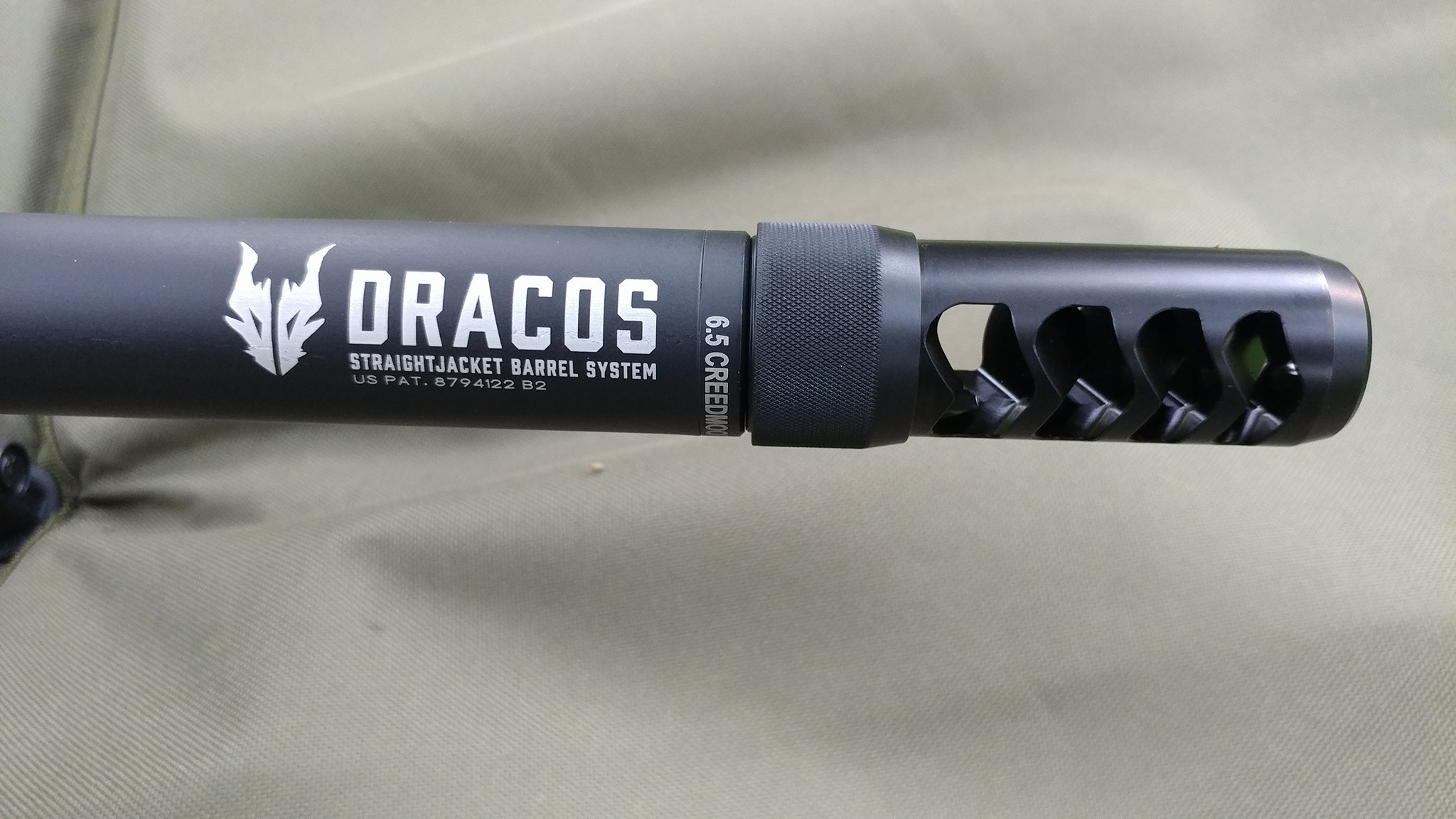

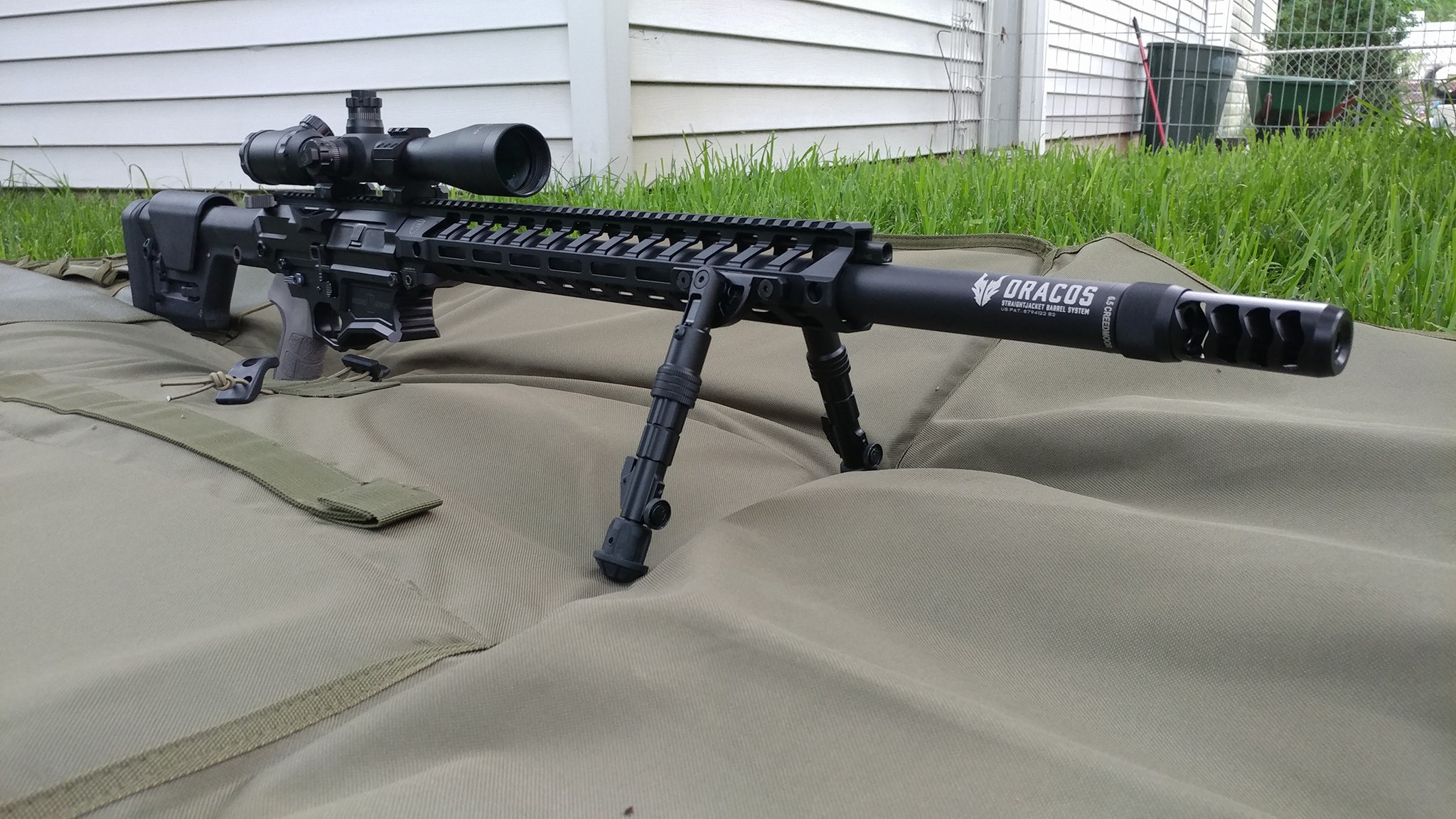

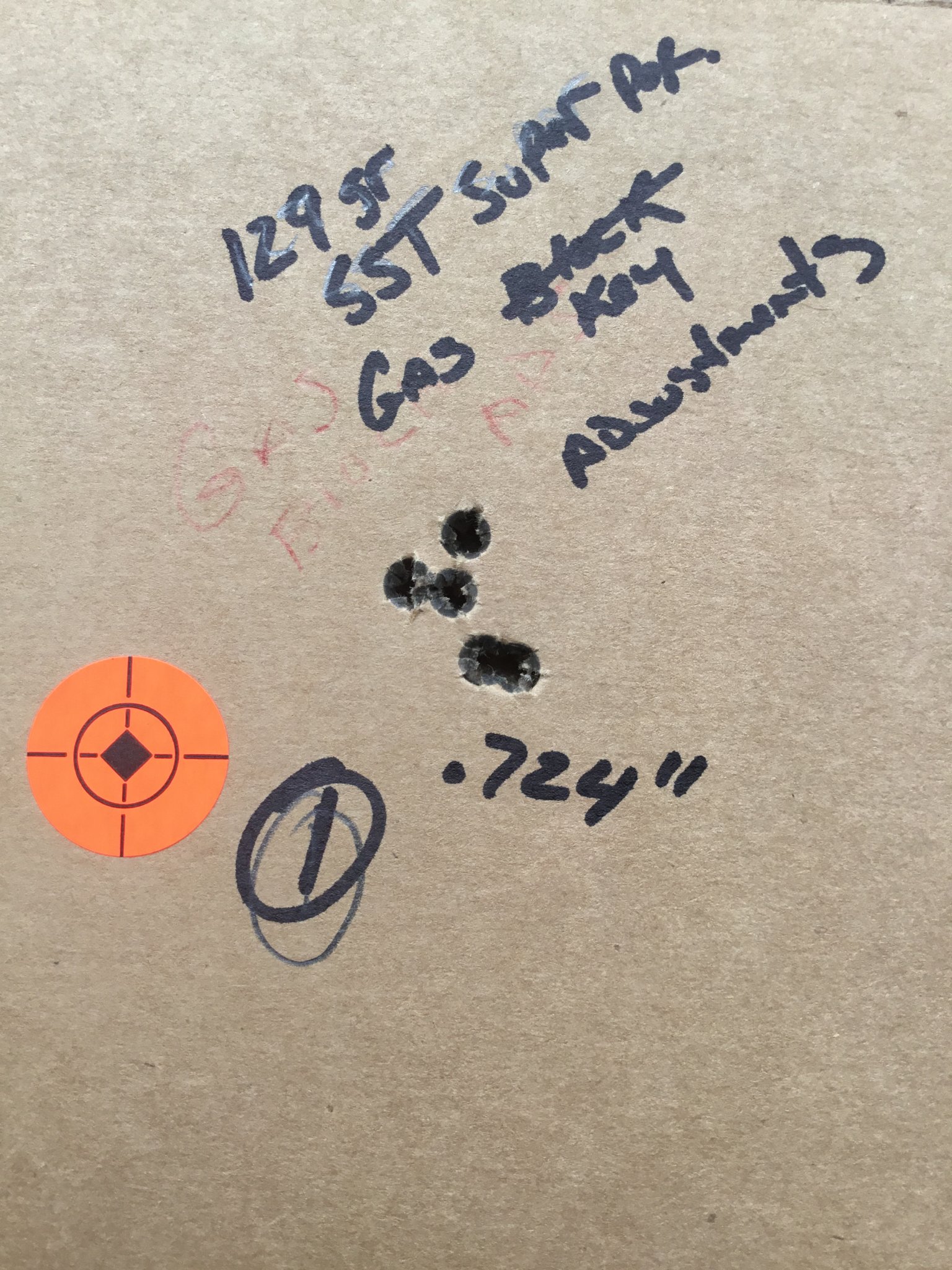

I just finished my Draco's 6.5 CM build. I'm running a JP Low Mass Carrier with their high pressure bolt. I have not tried to adjust that gas block yet. I'm shooting sub-moa with the cheapest ammo I could find. I'm definitely over gassed. Brass is ejecting at 1 o'clock. I have the JP silent capture sping installed with the standard spring. I may try the heavy spring and see what that does. I will be installing an RCA adjustable gas key as well.
Thought I'd add to the conversation. Regarding the adjustment and it's function (or lack thereof), it works but only just barely in it's current form. I found it helped ejection pattern very slightly (from 1oclock to 2oclock) throughout the adjustment range. Personally, I'd suggest running gas screw nearly completely out even protruding slightly (1-2mm) and using red loctite to ensure it doesn't come out/loose. YMMV depending on load.
I spoke with Dracos in April and they confirmed that they aren't thrilled with the design and said they were working on a new gas block design to allow better adjustment of flow/volume (read: making a normal adjustable gas block). No word on whether it's going to be backwards compatible yet. I'm planning to reach out to them to see how their testing has gone and hope to get an update or ETA for release.
Regarding precision/accuracy, I've had better success with 123gr/130gr bullets than I have with 140+. I've gotten the 123 SMK to shoot fairly consistent 1/2 to 3/4 moa multiple 5-shot groups. The only trouble I'm having currently is vertical spread which is either being caused by bullets unseating slightly (search reloading section for thread) or my rear bag technique (photo attached).

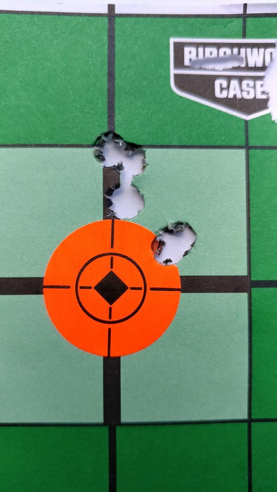

Here is a 6-shot group at 1060yds to show you what I mean: 10" vertical and 5.5" wide. (Sorry for upside down picture)
Here is 100yds with flat bag and low cheek pressure vs vertical bag and heavy cheek pressure. Top left is bolt gun for reference; bottom left group is solid bipod load, flat rear bag acting more like a rider bag vs top right group is vertical bag with heavy cheek pressure downward/hard squeeze on rear bag and same bipod load in all three. Notice the center of each group is nearly EXACTLY the same for both groups. Even more evidence of the need for PERFECT (really perfect) hold on bag, cheek weld and shoulder: the top right group was 3 rounds, break hold and reload magazine and send next two rounds.
While I will say it's been frustrating at times, I've really grown to like the Dracos barrel overall. GREAT heat dissipation, easy to clean and very consistent with the right load. The downsides have been mainly issues with torquing muzzle brake properly (too tight and groups went to shit; too loose and brake would loosen mid session), difficult to tune load and dirty as hell to shoot because of the no adjustable gas volume. But if rifle shoots this well for next 2k-3k rounds, it's worth it. I'm currently at ~2400 rounds with no discernable loss of accuracy. Trying to test their claim of lifetime MOA precision! Lol. Feel free to PM of you have any questions.
Note: I'm not affiliated in any way with Dracos; I bought a blem barrel to test out concept and am considering sending a Krieger AR15 barrel to Teludyne for a straight jacket to compare against Dracos.
Happy shooting!

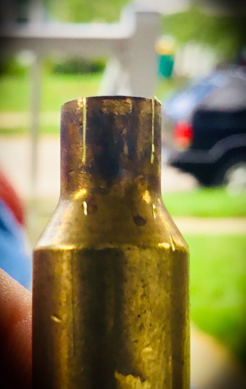

Here is what my brass looks like. Every one has these cuts / scratches. The edges on my extension are like razor blades as well. I did notice my JP Bolt has an Oring on the extractor spring. I’m going to remove the oring and adjust the gas key tomorrow with some factory ammo and see how it runs. Anyone else ever have problems like this with their brass?
Had the exact same problem with my Dracos for most of the first 2000 rounds. It started to go away with a heavier buffer, flatwire spring and, frankly, wearing in of the barrel extension. If you are careful, you can use an Emory paper strip or super fine file/hone and stone the edges/tips of the barrel extension at the 2 through 4 o'clock position. That should help quite a bit but go VERY VERY carefully into that process.
Those marks are pretty common for new barrels with too much gas/velocity at extraction. I have the same on three different new barrels in AR platforms. The ones with adjustable gas blocks allow me to minimize scratching but it's still there slightly.
