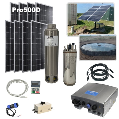

So it sounds like your setup is like what I had previously. Where the well pump had to come on MANY times each day, which is hard on the pump.
Have you considered a solar powered pump that fills a large storage tank and then using a jet pump to pressurize the house?
Unfortunately at your depth it won't be cheap.
You "might" be able to use the 2000 but more then likely would have to step up to the 3000.
Even using your current pump to fill a 2500ish gal storage tank and just adding a jet pump to pressurize house would alleviate the need to store water. It would also greatly decrease power requirements on a genset for daily use.
