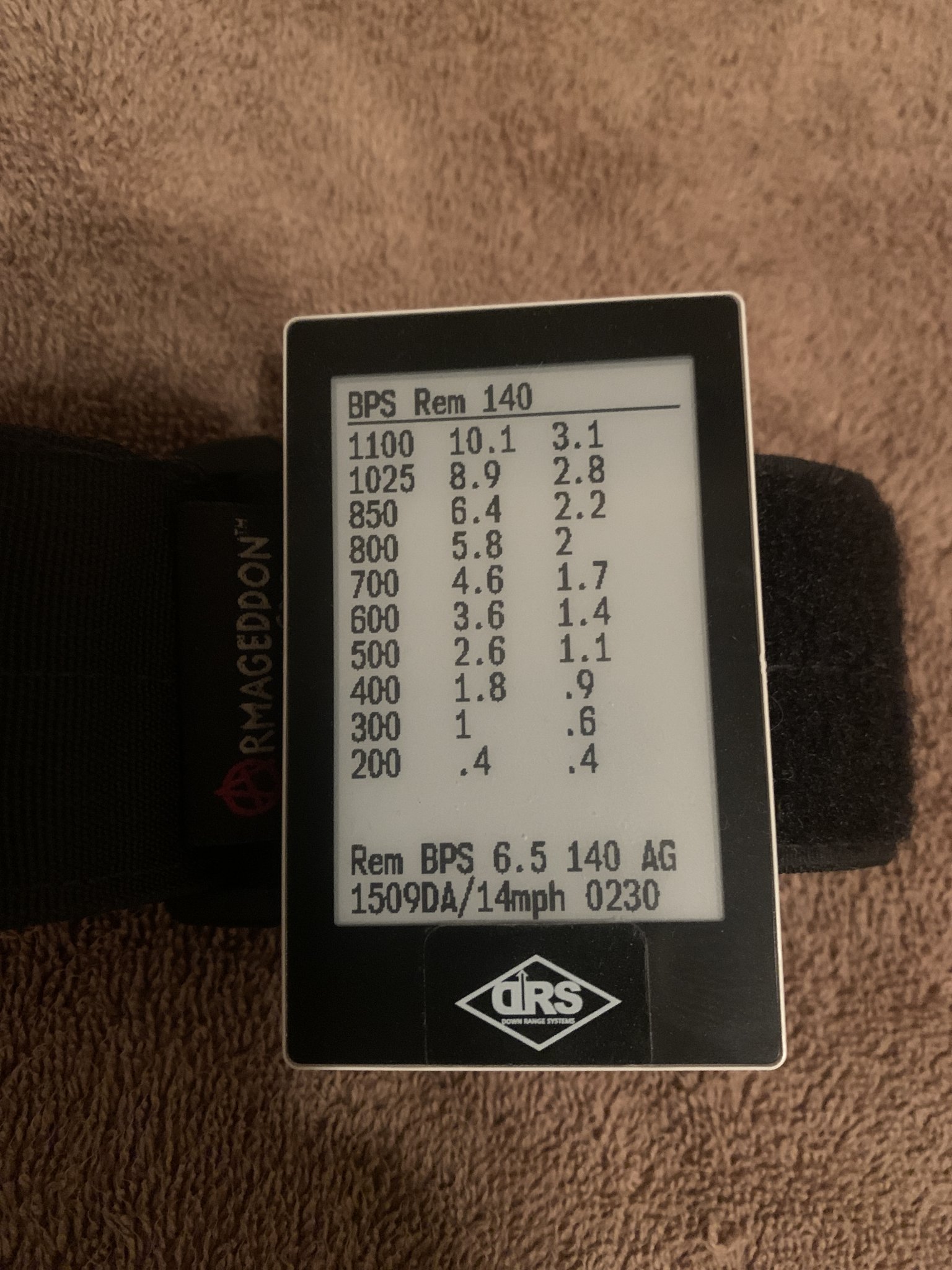

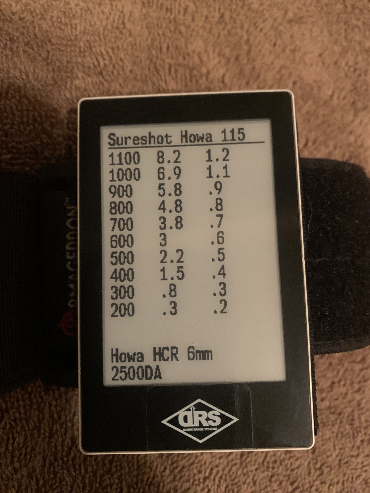

Mines been working great so far with iOS and the geoballistics app. Running iOS 14 and ran it yesterday at a match using the range card feature. Worked great. Few hiccups I had with getting some errors was when I had a bunch of other apps open. The app from geoballistics paired with this card are perfect for me.
