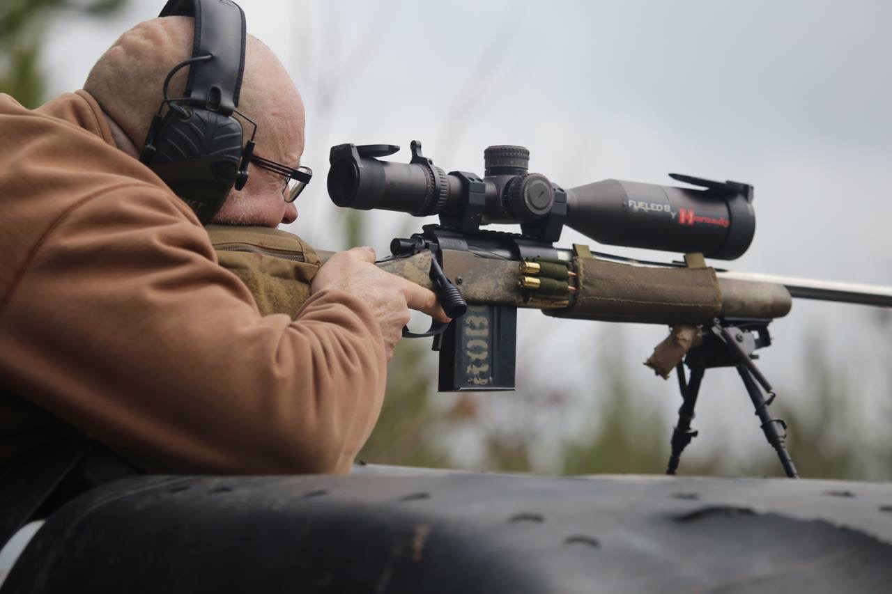

Yes just like any chassis or stock there are action screws that screw into the bottom of the action and hold it in the chassis. Below is a pic of my 591 in a Manners with mini chassis. I will see if I can find any pics of the mini chassis area of the stock but there are pics on Manners page.

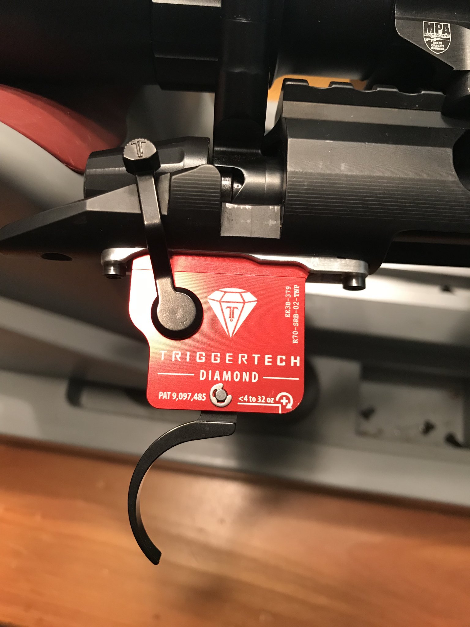

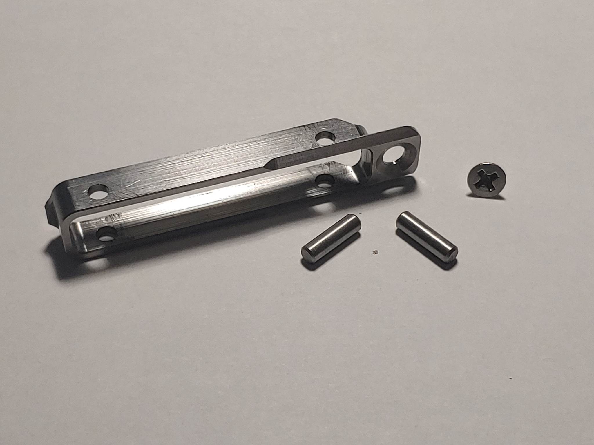

You install the trigger into the hanger and then screw the hanger into the action.
The hangers make the triggers footprint larger and some chassis don’t have accommodations for it so you may have to get the dremel out in some cases.
