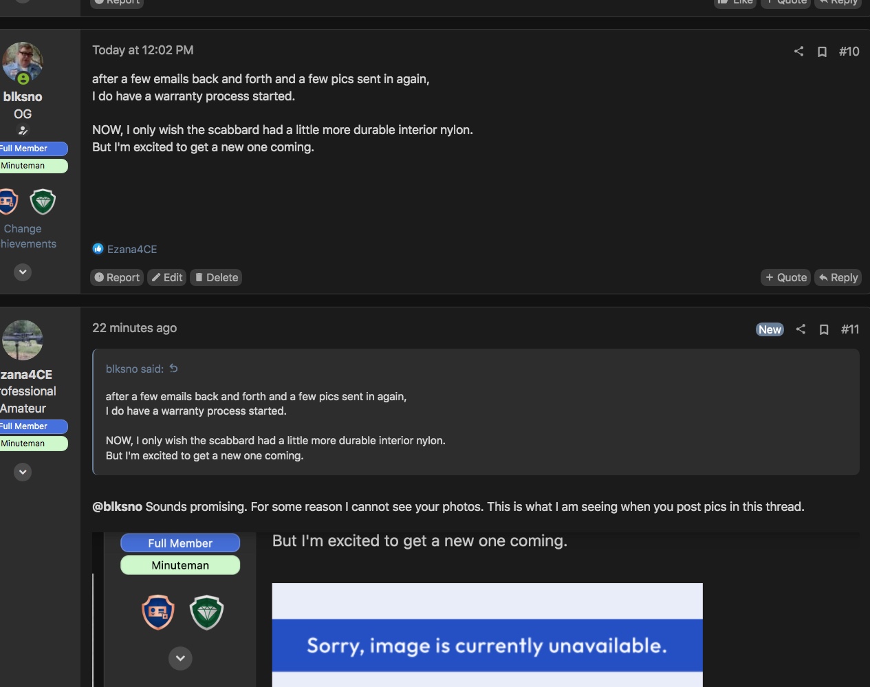

    after a few emails back and forth and a few pics sent in again,
    I do have a warranty process started.
    NOW, I only wish the scabbard had a little more durable interior nylon.
    But I'm excited to get a new one coming.

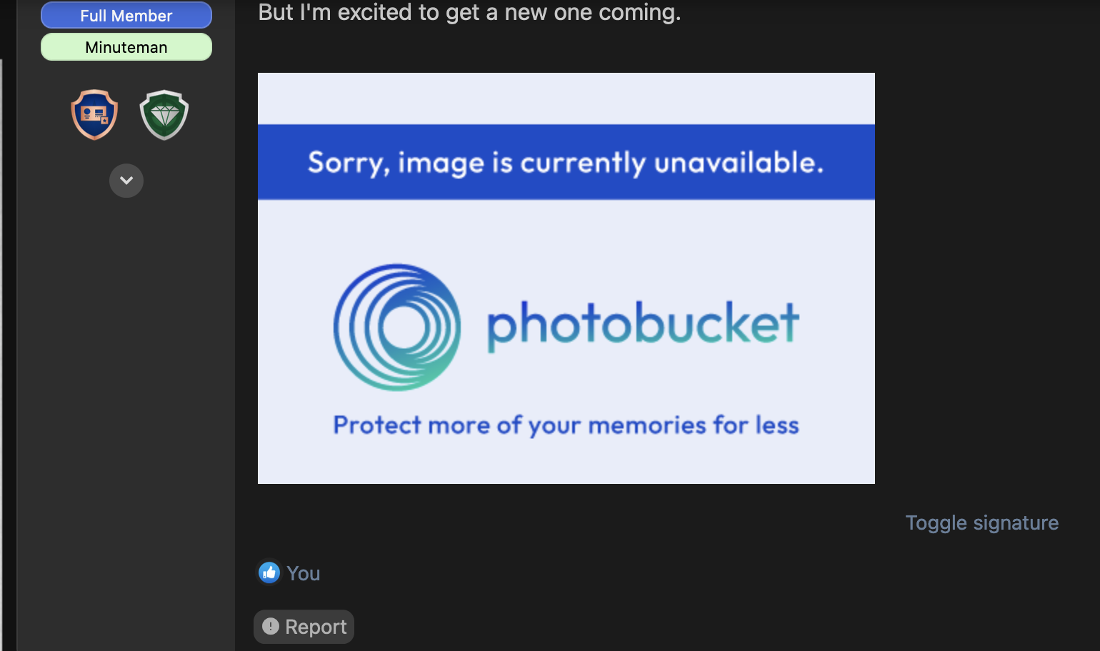

    @blksno Sounds promising. For some reason I cannot see your photos. This is what I am seeing when you post pics in this thread.
