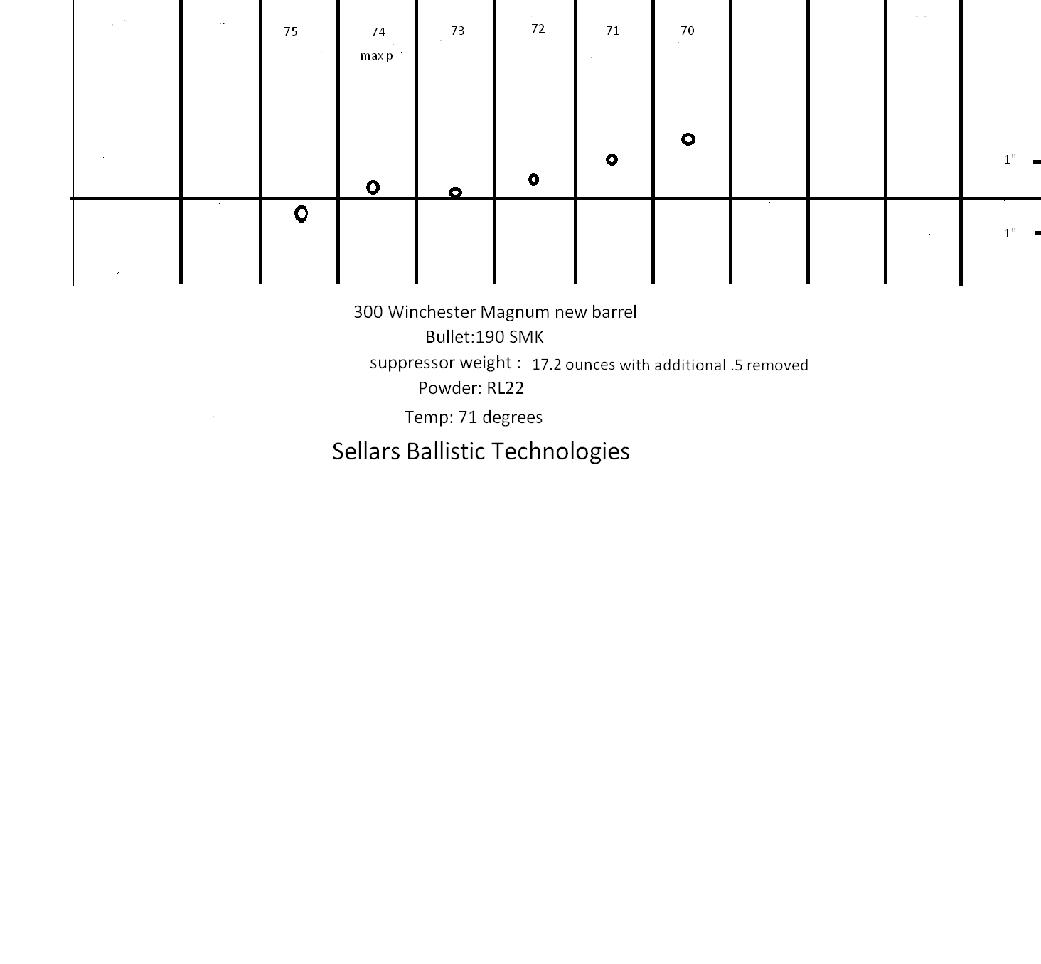

There is one way to measure barrel movements that has been used for many years but in different manners being called a ladder test. The ladder testing manner is the most reliable way to test precise movements under recoil and while the bullet is in the barrel. My particular methods entail specific scales or spacing designed to see even the smallest barrel movements that have been repeated for twenty years or so . Brian has offered no evidence to the contrary at this time. I have done exhaustive research specifically in the area of internal ballistics and intermediate ballistics through my company Sellars Ballistic technologies and is what we do . I am only here to help shooters learn the basics of tuners and not to get in to a pissing match. And please test everything I say that is doubted after all that is your only real proof anyway. Here is a small sample of a ladder test : This is a rifle that is full out of tune, and the wrong weight. I have hundreds of charts on just about every combination of barrel contours and proportionate weighting possible.

There is one way to measure barrel movements that has been used for many years but in different manners being called a ladder test. The ladder testing manner is the most reliable way to test precise movements under recoil and while the bullet is in the barrel. My particular methods entail specific scales or spacing designed to see even the smallest barrel movements that have been repeated for twenty years or so . Brian has offered no evidence to the contrary at this time. I have done exhaustive research specifically in the area of internal ballistics and intermediate ballistics through my company Sellars Ballistic technolgies and is what we do . I am only here to help shooters learn the basics of tuners and not to get in to a pissing match. And please test everything I say that is doubted after all that is your only real proof anyway. Here is a small sample of a ladder test :
That doesn’t actually test barrel movement.
We are working with the theory that it’s barrel movement. Obviously something is happening. But no one has confirmed exactly what is the cause.
Ladder tests show POI and such. Nothing more, nothing less.
Actually the ladder test shows the barrels angular position with differing exit times. The differences of 38 fps should only be only around .030 change in height, but it is much more, why? The barrel aimed it there .
Again, you’re making an assumption/theory as to why.
You have an end result:
38fps should = .030 change. It doesn’t in your testing.
That’s all your testing shows. It doesn’t answer “why?”. You filled that part in with a theory (and it’s a logical theory). Which is not to take anything away from it. It’s good testing.
Which is why words like “could” “possibly” should be used when testing shows an outcome but doesn’t shed light on the actual why.
Here is that same barrel the vertical bending had been modified, notice the slower rounds hitting higher? That is only possible by the barrel aiming it there.Please do not tell me that is is just a fluke. I have done this too many times in precisely controlled conditions and have 20 years of statistics to show it .
The reason is there is more weight below the barrel than above the barrel ,when the recoil impulse forces the rifle back the barrel will bend according to that weigh offset. A tuner just speeds up and slows down the bending that is created from the recoil force and offset of weight above and below the barreled action. Fair enough?
Tim in Tx
Reactions: AleksanderSuave
Tim in Tx
Again, that’s a logical *theory* and it may very well be what’s happening.
Until we have the equipment to measure where the barrel is “aimed” then it will remain a theory.
That’s why we always need to keep pushing and digging. If we stop at what logically might be happening, we never figure it out fully and don’t continue to advance.
The world being flat was a logical theory with the information we had at the time.. But we didn’t stop there.
I can assure you my company is well beyond theory. I have data on every caliber from 22 RF to 375 . I can shape a specific vibration to benefit every rifle and more importantly to gain an infinite tune. Tested for 7 years in competition and over 5000 rounds just on 1 tuning system.
