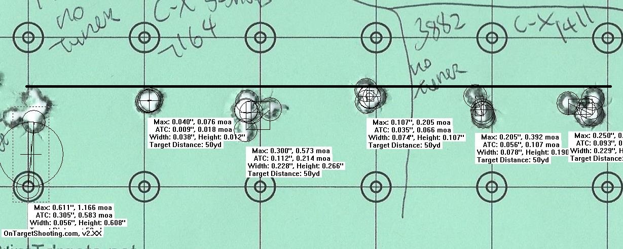

Matt, I use 3 shots to tune with too. but if the first 2 don't touch each other I don't shoot the 3rd.
as I mentioned tuning is about bullet exit timing and making it so the bullet will exit at the highest peak of the barrel's elliptical pattern of movement. if you can envision the barrel starts at a natural droop position from the weight of the barrel it will move upward from left to right since the torque of the bullet traveling down the barrel will make want to pull to the right in a clockwise direction. I am sure you seen a bullet spiral and veer to the right as it loses velocity. with a barrel that has no weight at the muzzle it will move and reach its natural highest peak as the bullet exits. with a good consistent lot, it will have the bullet exit timing very close to each other except for when there is a slight velocity difference as is normal in rimfire ammo. it will show a vertical height pattern close to each POI. with this information you now know where the barrel will naturally have bullets exit at the highest POI. when tuning you are trying to find a setting to match or exceed that natural highest POI
if you use weight at the muzzle to start with you will never know where that highest POI should be at and will be adjusting the tuner for new lots or condition changes.
Here is an example of what I am talking about. these groups all 5 shots were shot with no tuner and 2 different lots of CX notice the vertical height as shown with the black line above each group. as you can see each group had the highest shot very close to each other. this is the barrel's natural highest bullet exit point. even the far-left group which is about 6-8 shots to foul the clean barrel has a shot that is close to the others. my POA is the bull below each group. with this information I was able to tune this rifle and have the tuner set at 90 and has not been touched since going on 7 years I believe.
how well is it tuned the other target was shot with a lot of CX for the first time at 100yds. 50 shots a quarter is 0.955 in diameter. 2 RBA targets one shot in December and the other in August in club matches. 250-22X and 250-21X. probably a 60-degree difference in temperatures. I was able to get this rifle tuned to be able to do this because I knew where the barrel needed to have the bullet exit at. all because I knew the how it shot bare barrel.
