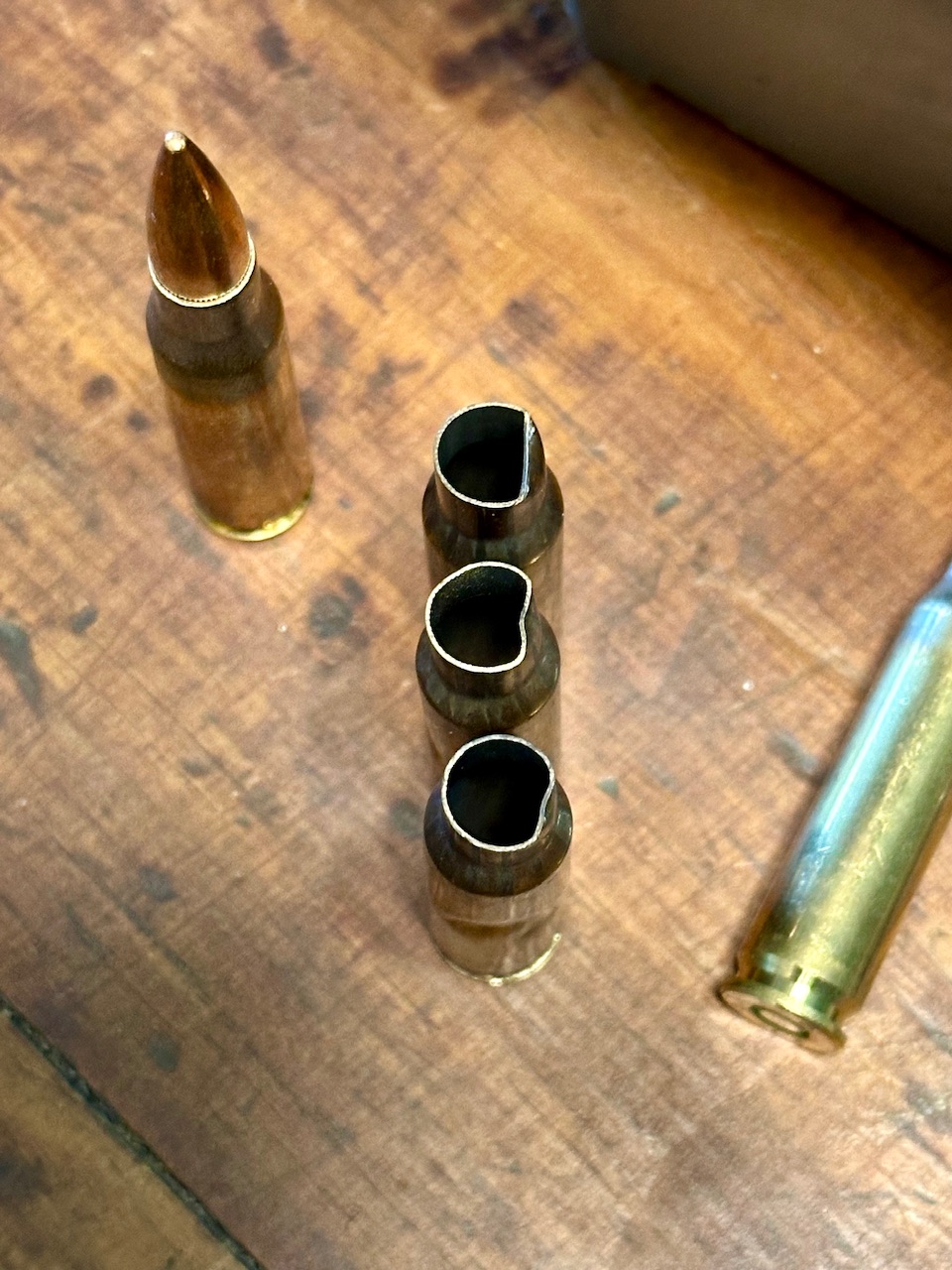

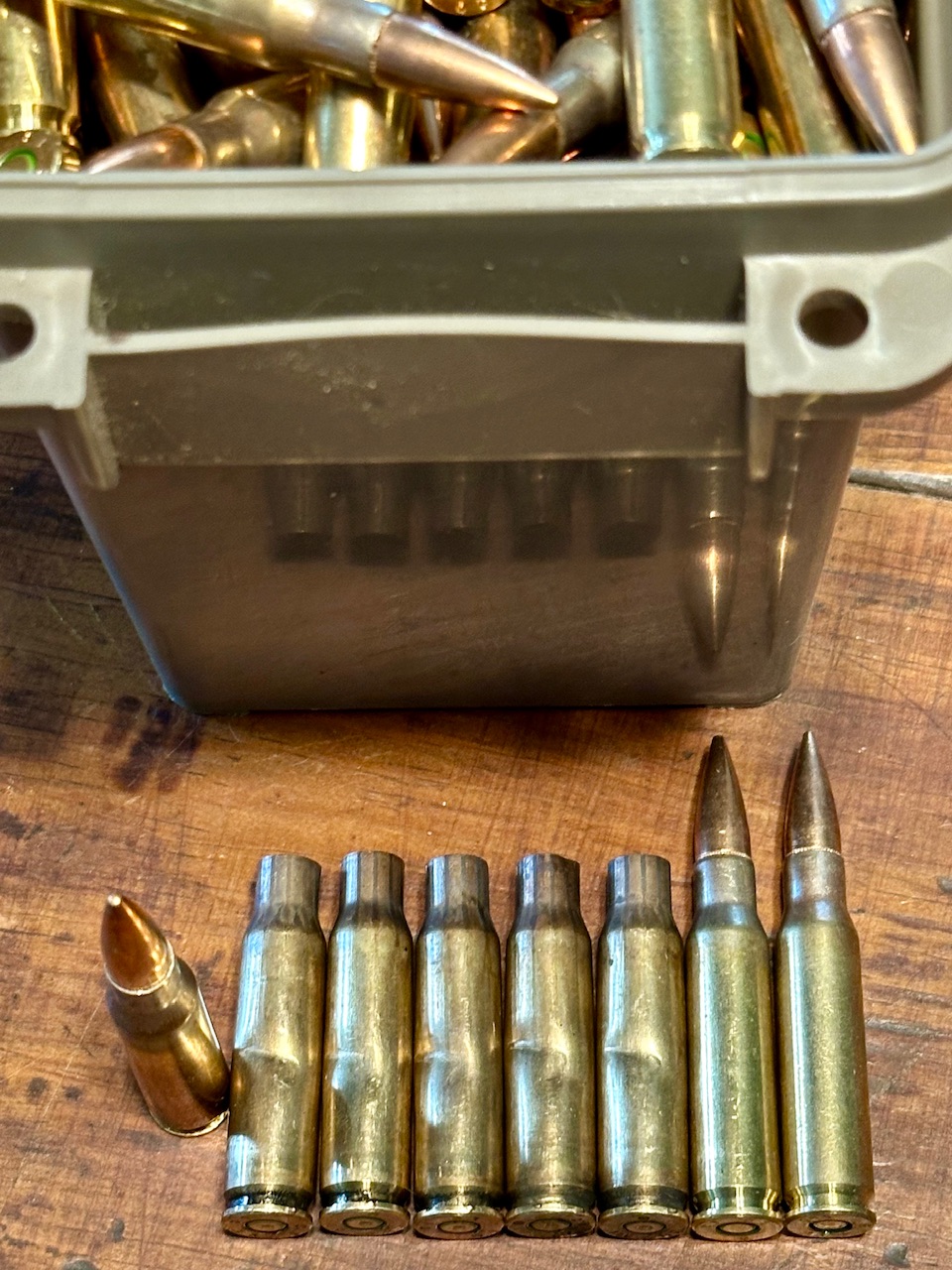

    My question is… do all 91/G3’s do this?
    And holy crap does this thing chuck brass a mile or what?! It’s like a lethal secondary projectile. Stuff was, no exaggeration, 25+ feet away!
    This is my first HK91. It ain’t no wannabe PTR knockoff. It looks brand new inside and out, all original, with a matching S&B 3-12. It’s a piece or art, but why the hate?

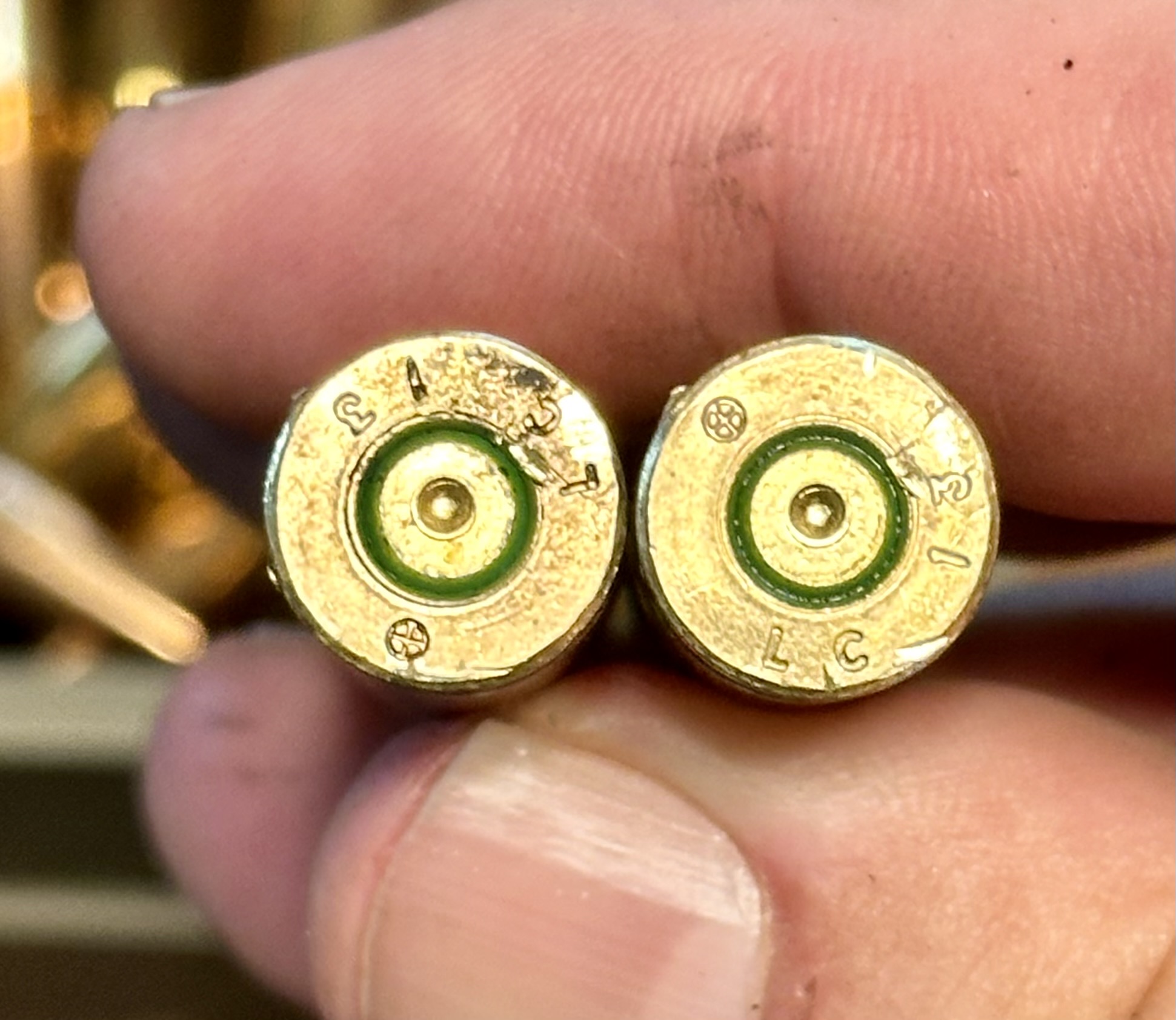

    It was LC M80 ball ammo. Included original ammo and photographic evidence of this HK’s crimes against Brassmanity.

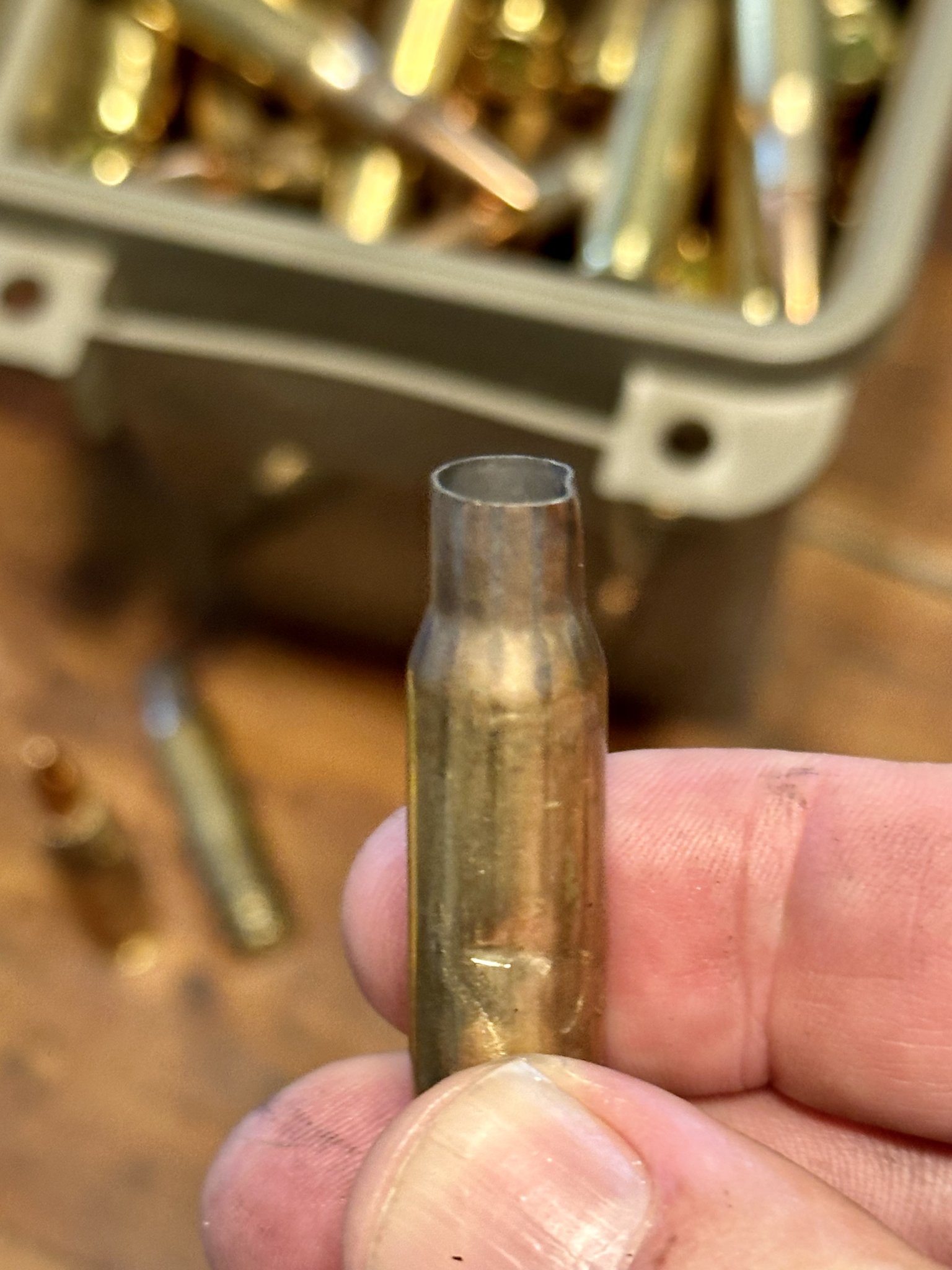

    Before and after. It literally beat the lip, the side, and the bottom, and scored the case circumference with groove marks.

    Welcome to what everyone has experienced for the past 50 years.
    Roller locked guns are very hard on brass due to the way everything works.
    They were designed for military applications and brass was always considered single use from the get go.
    Yes if you don't hit the enemy with the bullet you might still take them out with the ejected case.
    The grove marks in the necks are from the gas flutes in the chamber.
    Actually some of the PTR clones beat up the brass a bit less, but still it's not usually considered worth reloading after that.
    It's the nature of the system.
    If you want to reload your brass get an AR10
    My PTR91 does the same with the 45⁰ standard locking piece. I switched to an HK21/23E #9 40⁰ locking piece and it made a significant difference because it slows down the bolt speed noticeably.
    And now the brass only fucks off 15-20 feet away instead of the 30-40 feet away.
    I do not recall seeing the mid-case crease as well, but grooves and mouth dent: 100% of the time, intrinsic.
    Flute marks are meaningless. People who load a LOT, and to failure for experiments, have never ever ever had a flute related failure. Works like any full power rifle, get 7-8 loads out of them if you do the rest of your process.
    Case mouth will need to be opened before you can resize but that's trivial. Get an old pen or make a plastic or wood or metal flaring "tool". Inspect a bit then to make sure nothing creased (may not be able to do this till after resize, but do check) and be sure to lube to reduce the chances of creasing, but should work fine.
    Official HK gave such advice when they sold mostly roller locks and had nice CS folks.
    CETME C also does this.
    Anyway... super slow-motion footage of this type of rifle shows that the vigorous ejection actually spins the case so violently that it hits the receiver twice.
    The first time, the brass hits the rear edge of the ejection port, making the diagonal shaped crease in mid case. Since the case is spinning, it continues along until it hits the case mouth somewhere aft of the ejection port. If you inspect carefully, you will see the yellow brass stain in that area.

    Slow motion G3 cycling. Very impressive.

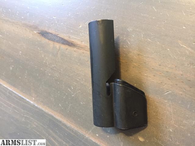

    They used to sell a port buffer that clamped over the top of the receiver to help save the brass from dents. Don't know if they are still available. Had one on a 91 30 years ago, and reloaded for it, worked well.
    View attachment 8444371View attachment 8444372
    Modified one to work with a railed PTR91. Dremel to fit & glued on.
    Recommend, if they ever turn up again & someone wants to save brass.

    Quick question… spicy ammo, like M80A1 and M993 — should that be avoided, or OK in this gun?
