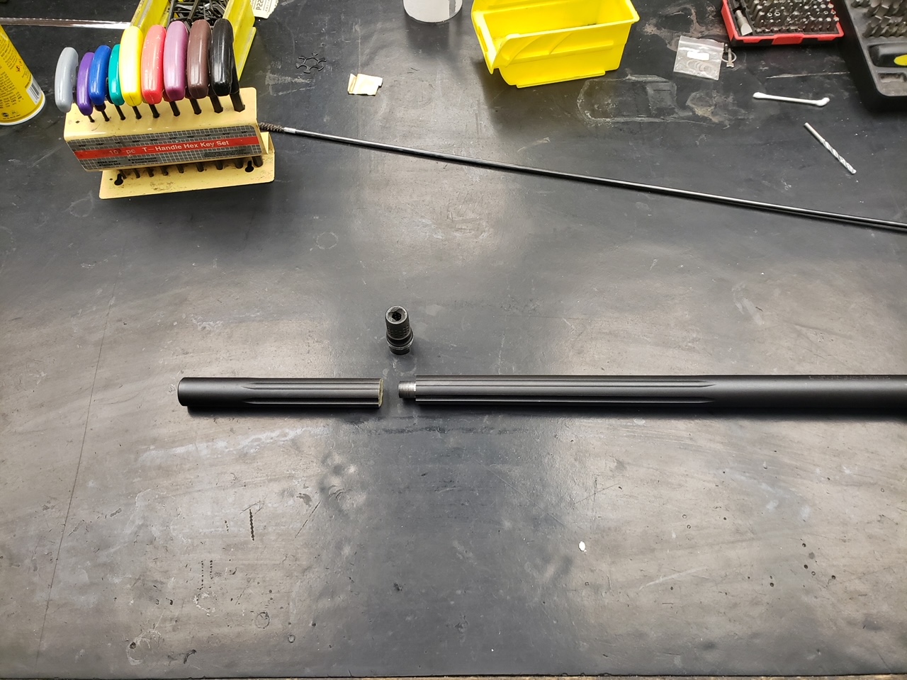

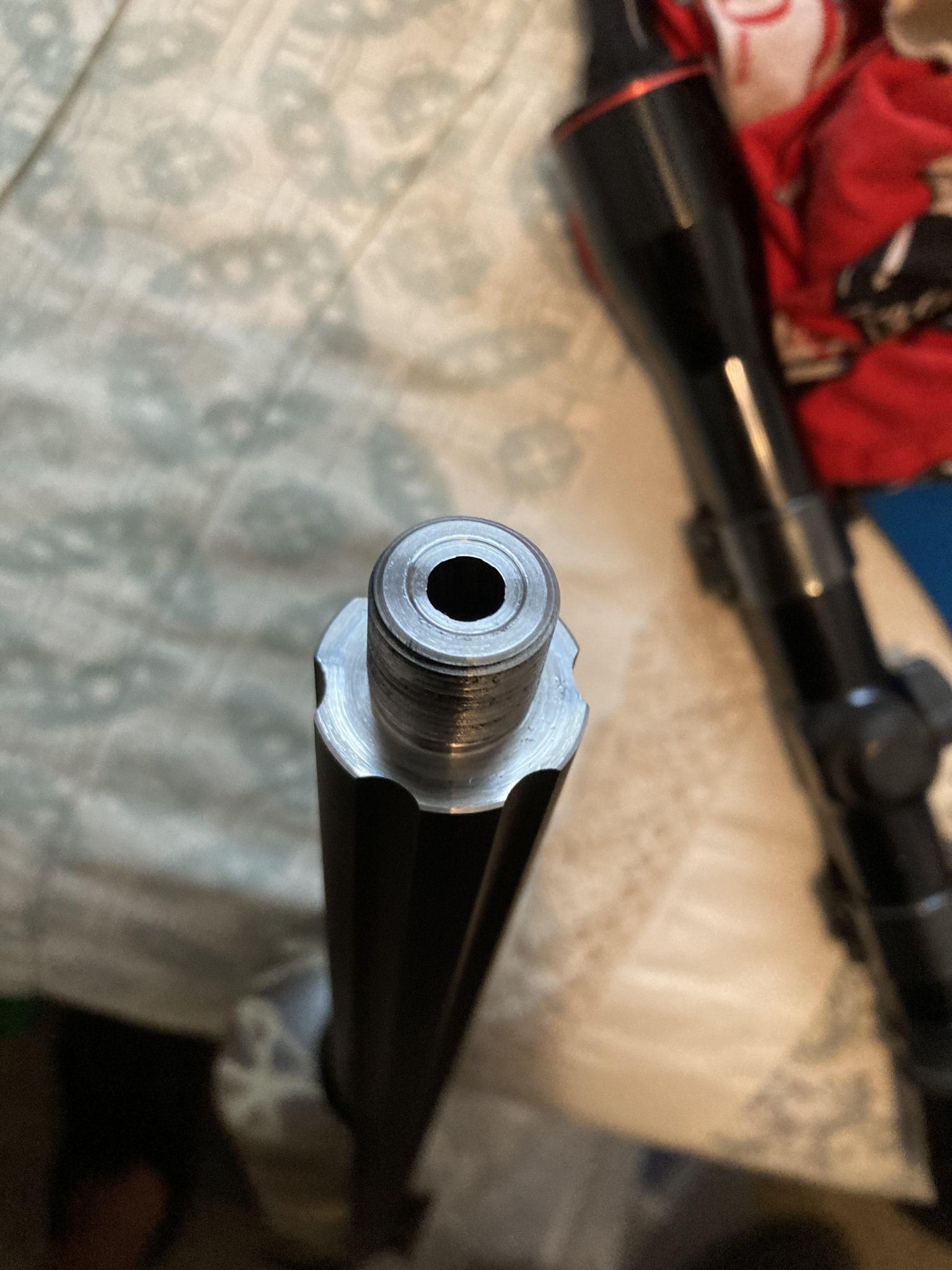

I chopped and rethreaded a Bergara BMP 6.5 from 24” to 19” specifically to improve the handling/weight with a can. The accuracy was unchanged and it’s actually nice to carry and hunt with now.
I’m shooting the 123s so bumping my velocity back up didn’t take much. I’m a believer in the lighter projectiles for easier velocity gains and better brass life.
LRI did the work. They had a solid turn around, as well as quality work.

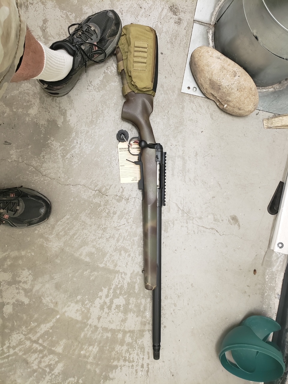

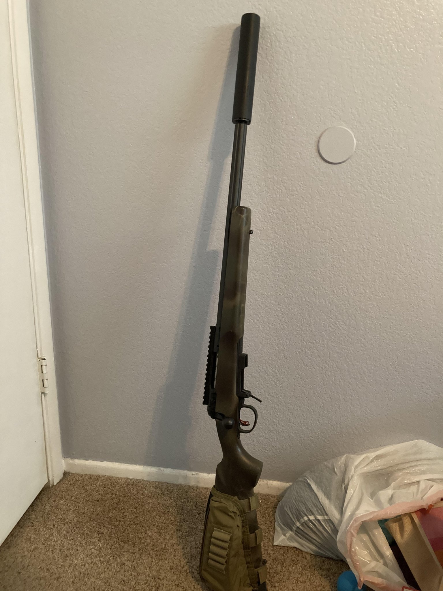

So Dave what did you decide to do?
Thanks for asking. I decided that even though it shoots wonderfully as is, I don't enjoy shooting it anymore because I just don't really want to shoot without a suppressor anymore. It was 26" with an unthreaded muzzle, so it didn't have a lot of utility other than being able to shoot wallet-worthy groups. So my gunsmith is cutting it down to 19" and threading it 5/8x24.
Reactions: Gtscotty and Mj1995
I think it came out good man. That would be a great rifle for where i usually go on my hike/ hunts. Be great with some sticks or a lightweight tripod to smoke some coyotes.
Reactions: Dave
Thanks, brother. She's still a little portly, but soooo much better if she still shoots like she did before I had her circumsized.
