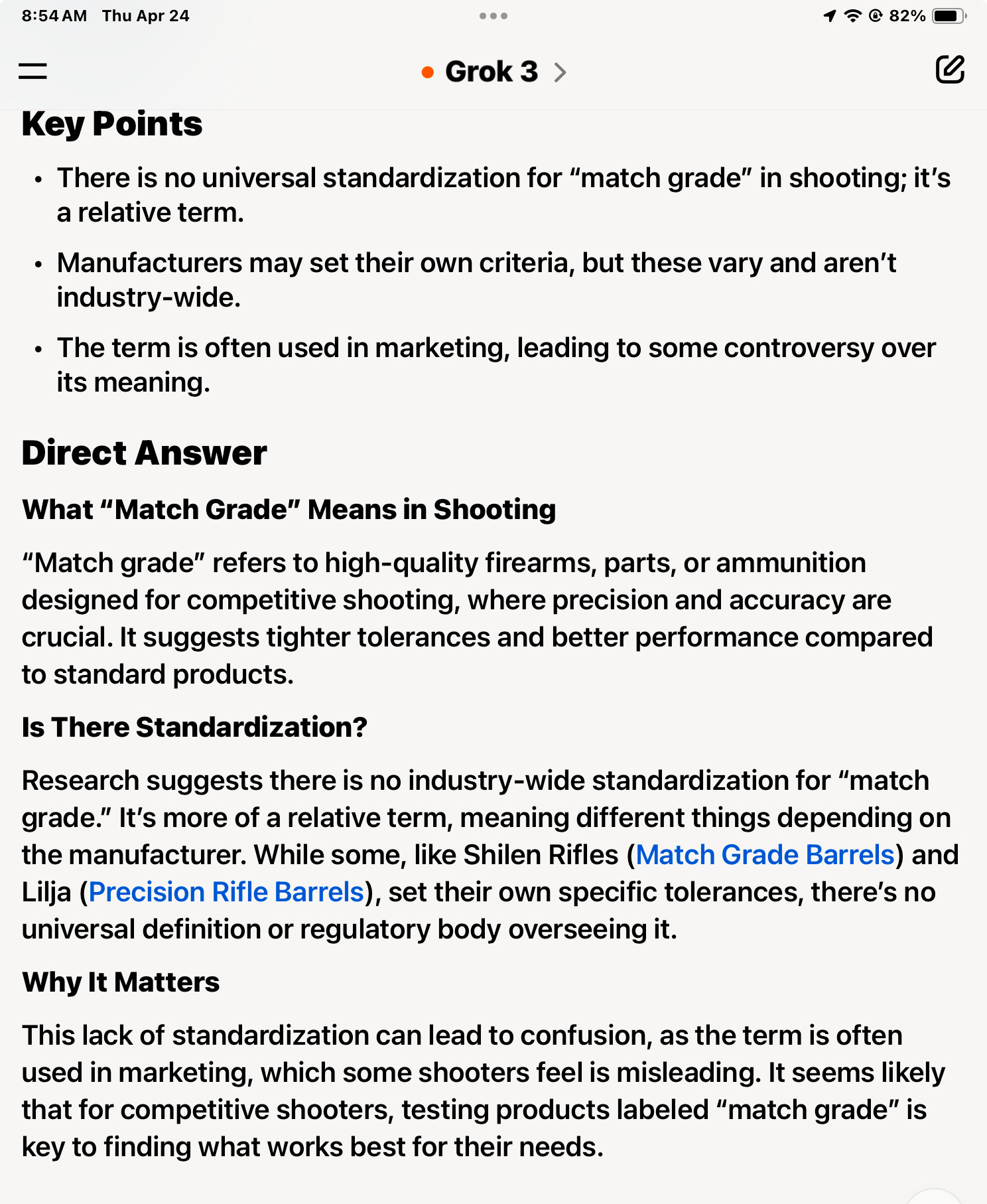

I guess we need to get the International Bureau of Weights and Measures (BIPM) involved, to define “Match Grade” in shooting.
As far as I am concerned, the Hornady bullet weight differential within a box of 100 and the FPF differential from lot to lot with Hornady ammo, is far from match grade. With no standard in place ,THAT is my OPINION.
If the standard for “Match Grade” was clearly defined, and they did in fact fall within that those parameters, I wouldn’t have a leg to stand on.
