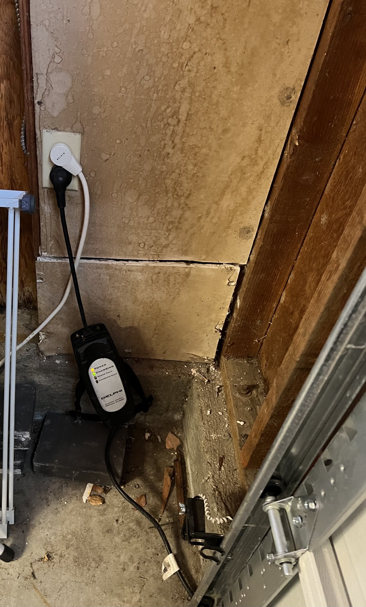

Beats me - I’m not an electrical engineer. 120v charges the car to max in about six hours, but when that happens overnight it just feels like magic. A 240v would be much quicker but totally unnecessary. These kinds of plug-in 120v chargers are pretty much the norm, from what I can tell, though I do know one person with a 240v, but he was a very early adopter back around 2010.
I'm a bit skeptical that you are getting any kind of decent charge in 6 hours over 120v
I would be very surprised if you are getting more than 8kwh in 6 hours, it's just like not possible from a standard 15amp plug at the average 100-120v range.
The simple solution if you have an electric dryer is just unplug the dryer and plug in your charger.

Yeah, beats me. All I know is my wife would drive to the office in the e-Golf and it would use most of the battery. While working it would be on a slow charger and then she’d drive home and it would charge overnight. She’s definitely not at the office for more than 7-8 hours and none of this would be sustainable if it didn’t charge to full overnight. The new car has almost three times the range, so it’s never fully drained.

Its not just the voltage its the amperage you lack to fast charge , 300Amps at 480V is a fucking machine shop level current.
6 hours of 120V will give you 10-12miles !
That's a more clear and logical explanation.
If she was charging for 7 to 8 hours at work and then you plugged in and charged all night you could be looking at more like 16+ hours of total charging time per day which makes sense for 120v charging.

I agree you are not an electrical engineer. You are off by a mere 34 hours on your guess.
However, we can give you an approximate charging time if you have a dead Tesla battery and need a full charge.
Here are the estimates of how long it takes to fully charge a tesla:
  • Level 1 (120 V): 20 to 40 hours
  • Level 2 (240 V): 8 to 12 hours
  • Level 3 (480 V): 15 to 25 minutes
