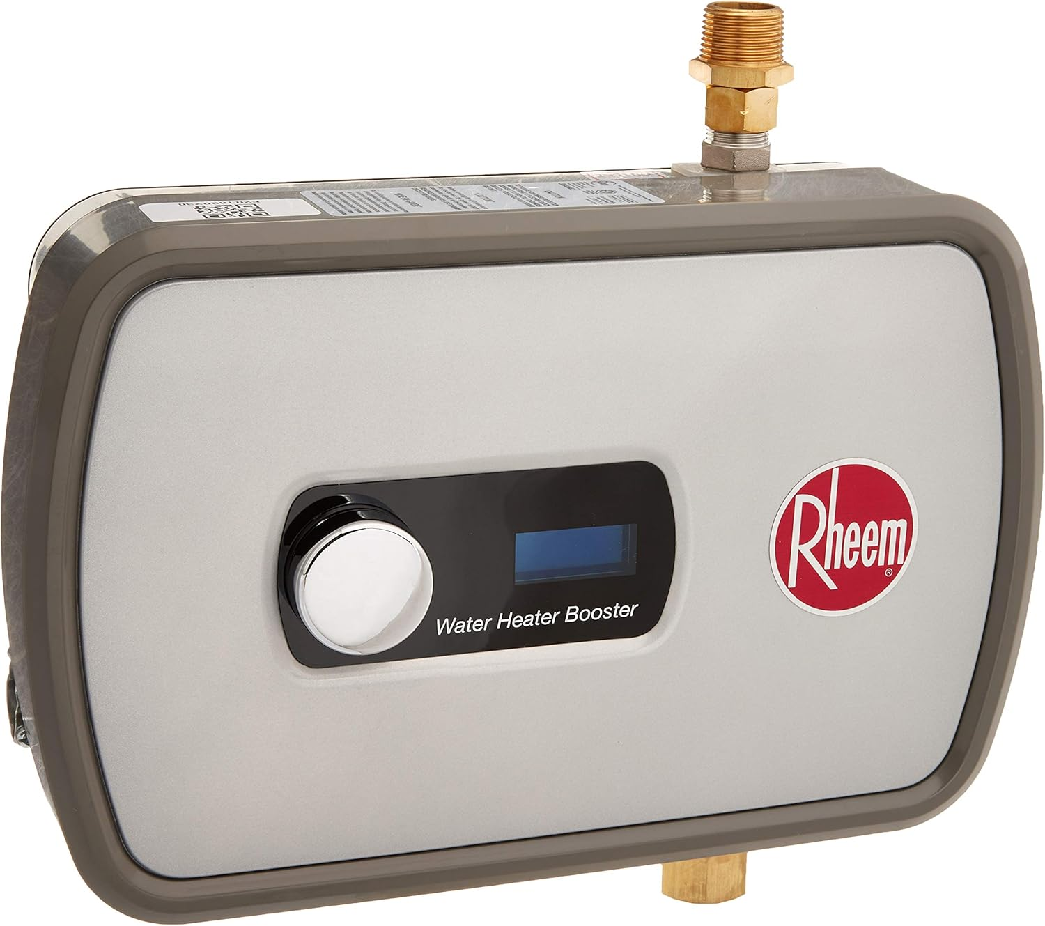

Anybody running one of these electric "hot water extenders"?
A 10-3 line to 30A breaker was already run to my utility room when I bought the house, which looks ideal for one of these.
small capacity tankless electric water heater dressed up.

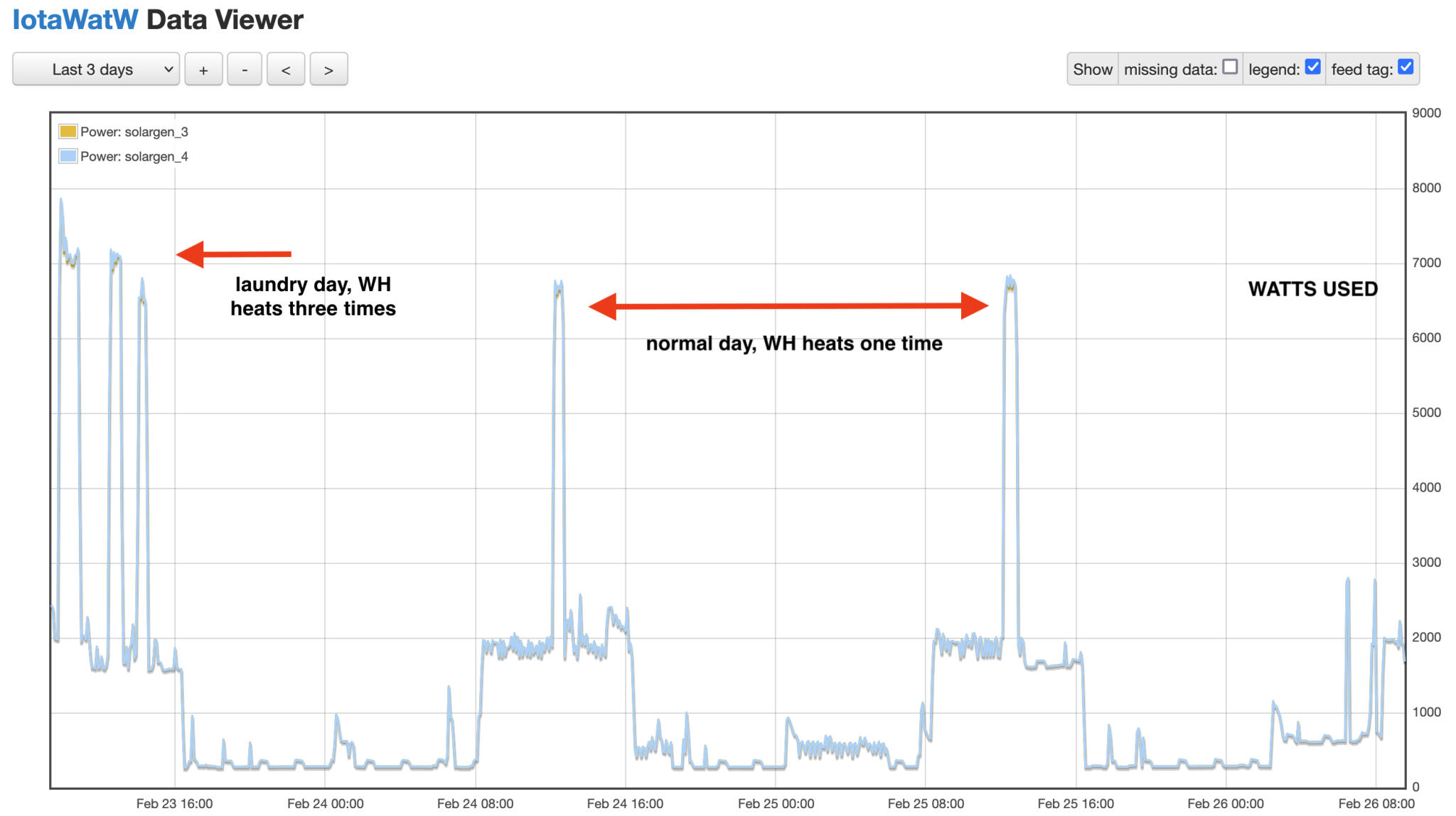

Our 80 gallon AO Smith electric was installed in 2006, still works.
I have had to replace elements once.
Was plenty for a family of 4.
Now that the kids have grown up and moved away, 80 gallons is more than we need.
Years ago, I connected the WH to solar power.
A timer runs it at the time of day w/ most Sun.
Wife over-rides timer on laundry day.
