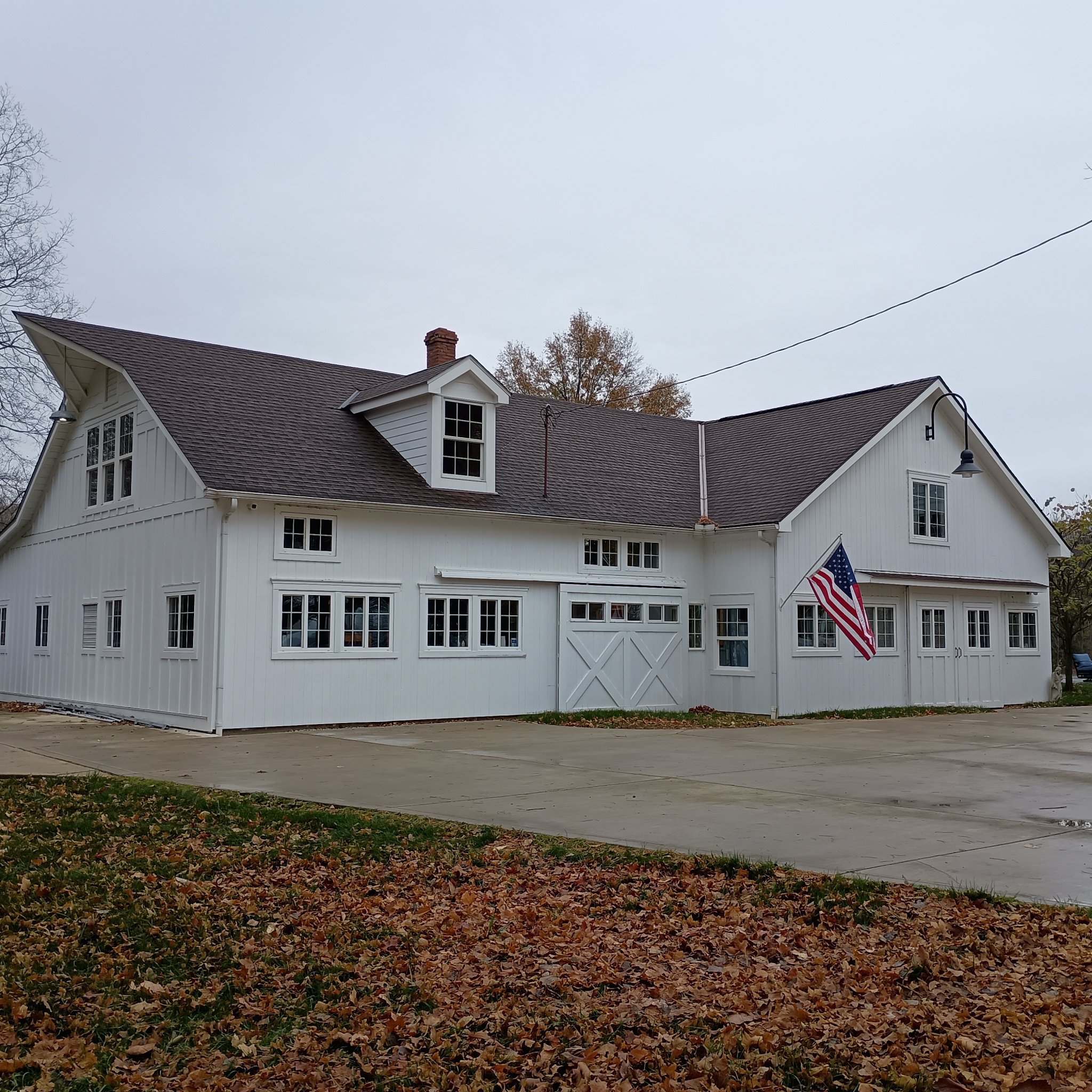

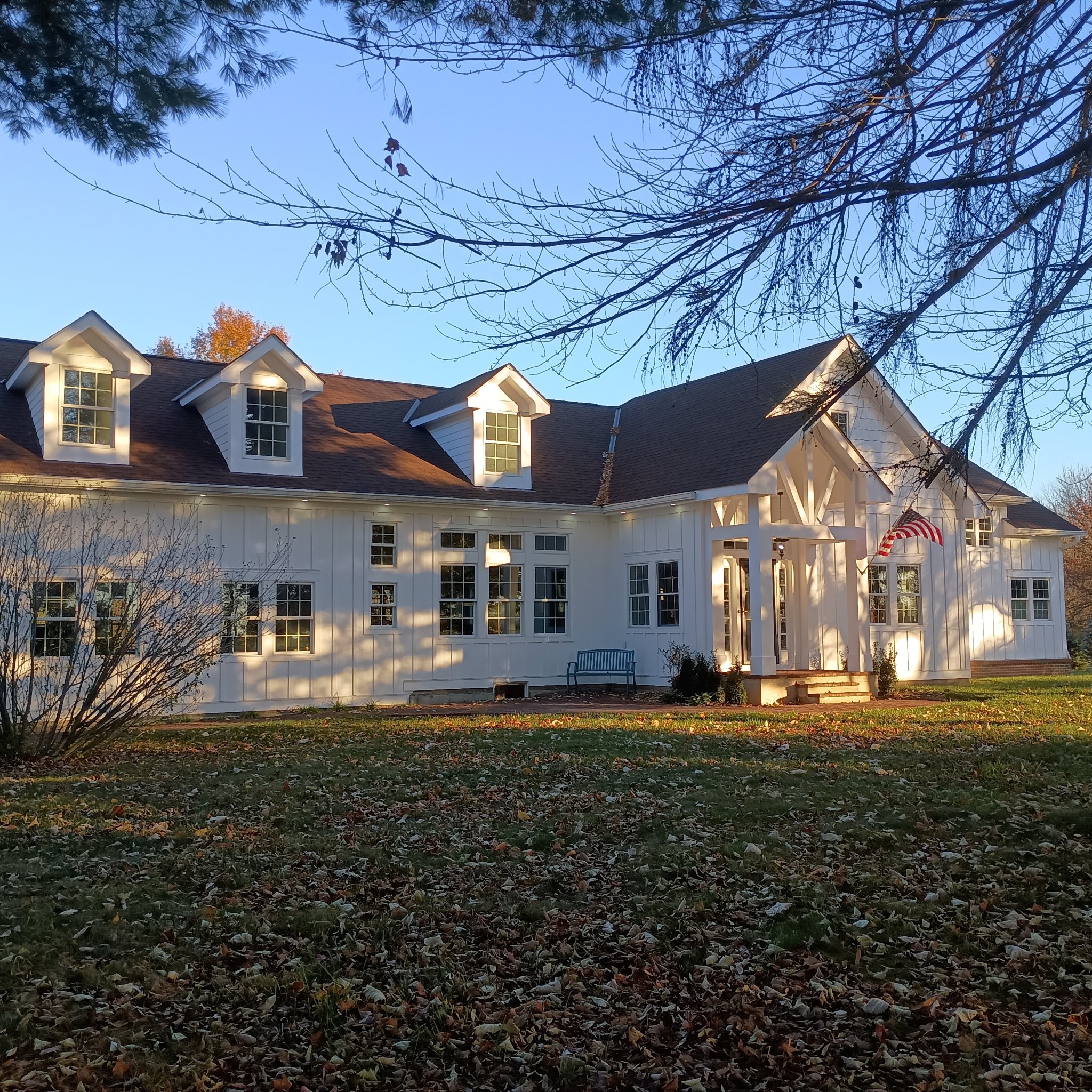

I have a pole by my property that feeds the house and barn (barn is a workshop). Both have a 200 amp service. The meter base has two 200 amp breakers so I can shut off power to one or the other (that's handy). Six years ago, they installed this for free.
I quit my IT job to build the house and barn.

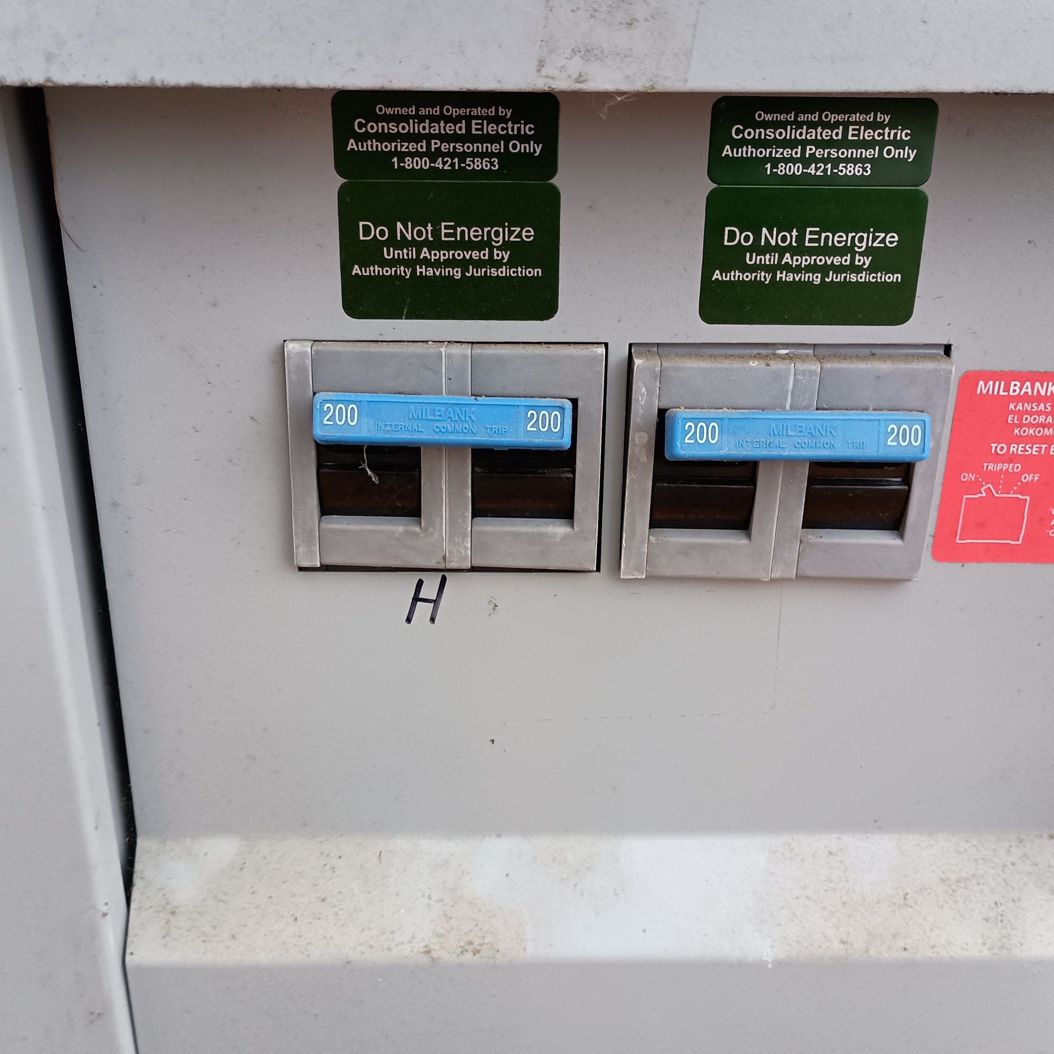

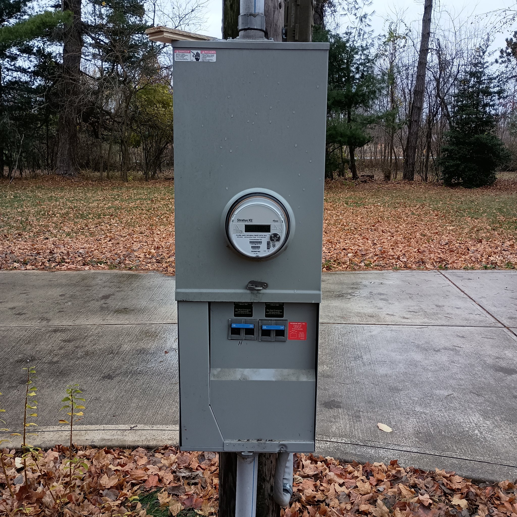

Like others have said, the 320a feeding a 200a panel in the shop and the 200a in the house.
Going to a 400a is a huge jump, I did one for a client about a year ago. They wouldn't listen and were insistent on the 400 over the 320. From the meter socket to the shop was over $10k and the utility company hit him for another $15k. Then on top of that considered it a commercial account and charge him demand even on a single phase service.
Milbank 320a meter can, with 2 200a disconnects, or a disconnect and feed through panel. one to the house one to the shop. This arrangement is half the price of buying a 320a with the two integrated disconnects. Which is about $2k for the Miilbank and the Square D is about the same price.
