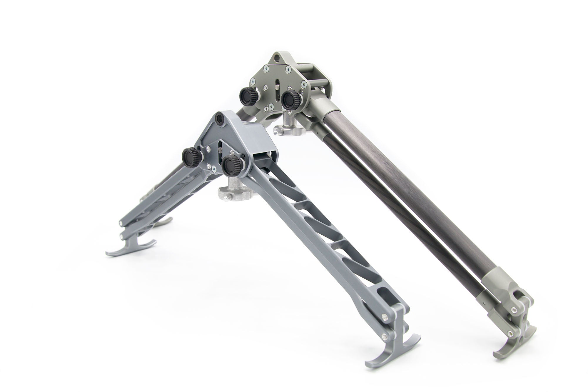

Might be a knock off, but I just got a LRA bipod off of eBay. It seems sturdy, but haven’t had a chance to use it yet.
I took a chance on the LRA knock off.
After running some lapping compound on the cant pieces and applying dri lube, I haven't been able to break it.
338 LM Imp. Really like it so far
Bought another. Looking at a JoyPod seriously though.
Thanks man, that's not bad! Worth keeping in mind. I just really, really love my LRA and was looking forward to them coming out with an Atlas sized version but made like the usual LRA... It never came out, now it seems it never will. What put 'em out of business? Not enough exposure? I don't get it. At least CADEX will keep the fire lit.
Talked to the maker of the LRA bipod about a year ago. Seems he had issues with local taxes and zoning regulations that wouldn't allow him to keep his shop open. He then looked to subcontract the major parts manufacturing to another individual/shop but for whatever reason that fell thru. Last I heard he was looking for someone to buy the business....
A real shame though. It was a very nicely engineered bipod.
The Cadex seems like a nice piece of kit. Wish they would come offer some decent ski feet for it with the ability to dial in some fine adjustments

My ELR rifle, a .300NM, has a LRA F-Class bipod with ski feet, I think it's a really good fit for the rifle.
I use the LRA F-Class on my Mirage ULR and really like it. A few months ago I one to order the light weight version like pictured above and was greatly disappointed to find they are not available.
