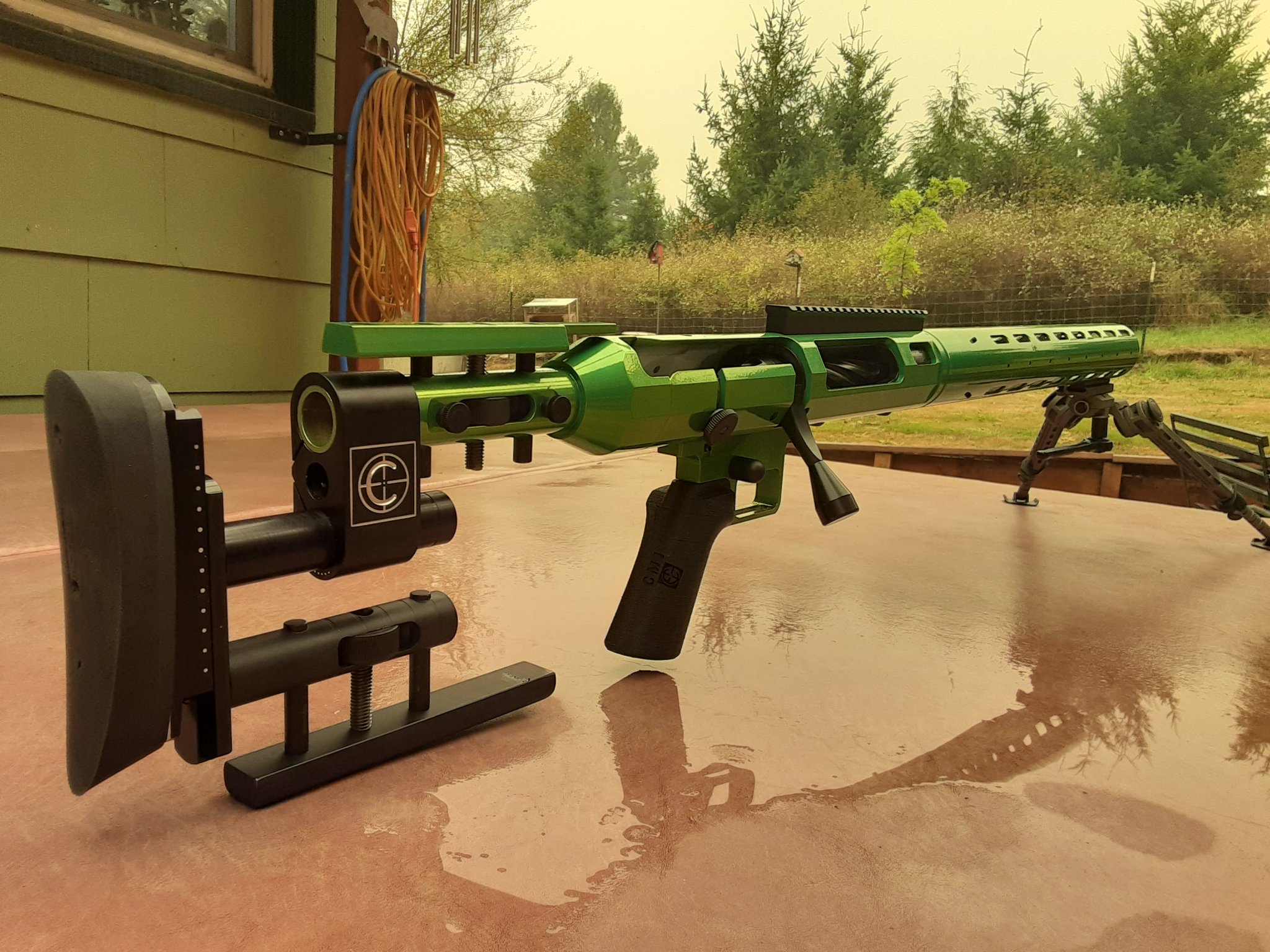

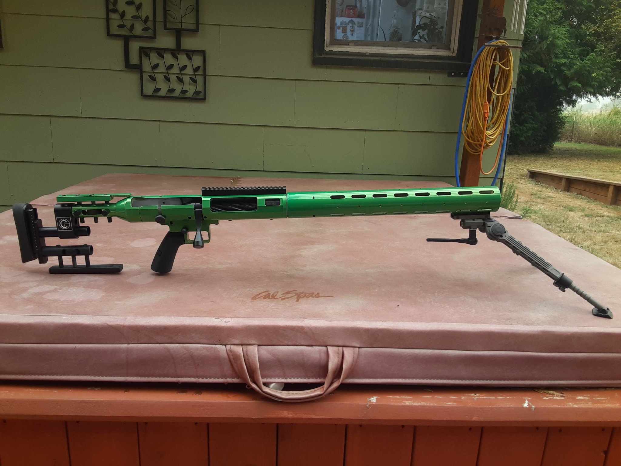

Chassis body and action less handguard barrel. To give idea of size

Looks like an oversized Competition Machine Chassis ..nice work
What is the weight of that chassis and action setup?
Beagle ?? As in jbrc??? Authorization would need to come from my self sence i am the owner and designer of the cartridge the chassis is built by gary elieso designed for my self and pierce engerneering for the 20x any one could order one threw pierce engerneering or beagle could order one in any saami cartridge. Weight is about 16 lbs

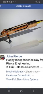

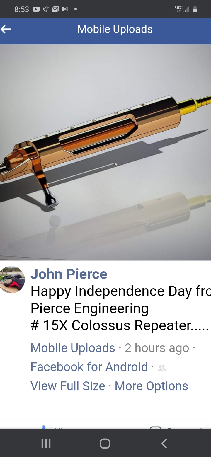

Our latest evolution for the Colossal series cases as a new action that is a repeater and currently designing and making the prototype detachable boxes to run all of the Colossus cases for all of the different calibers
I figured you’d want to keep the action as intact as possible for max strength and registry.

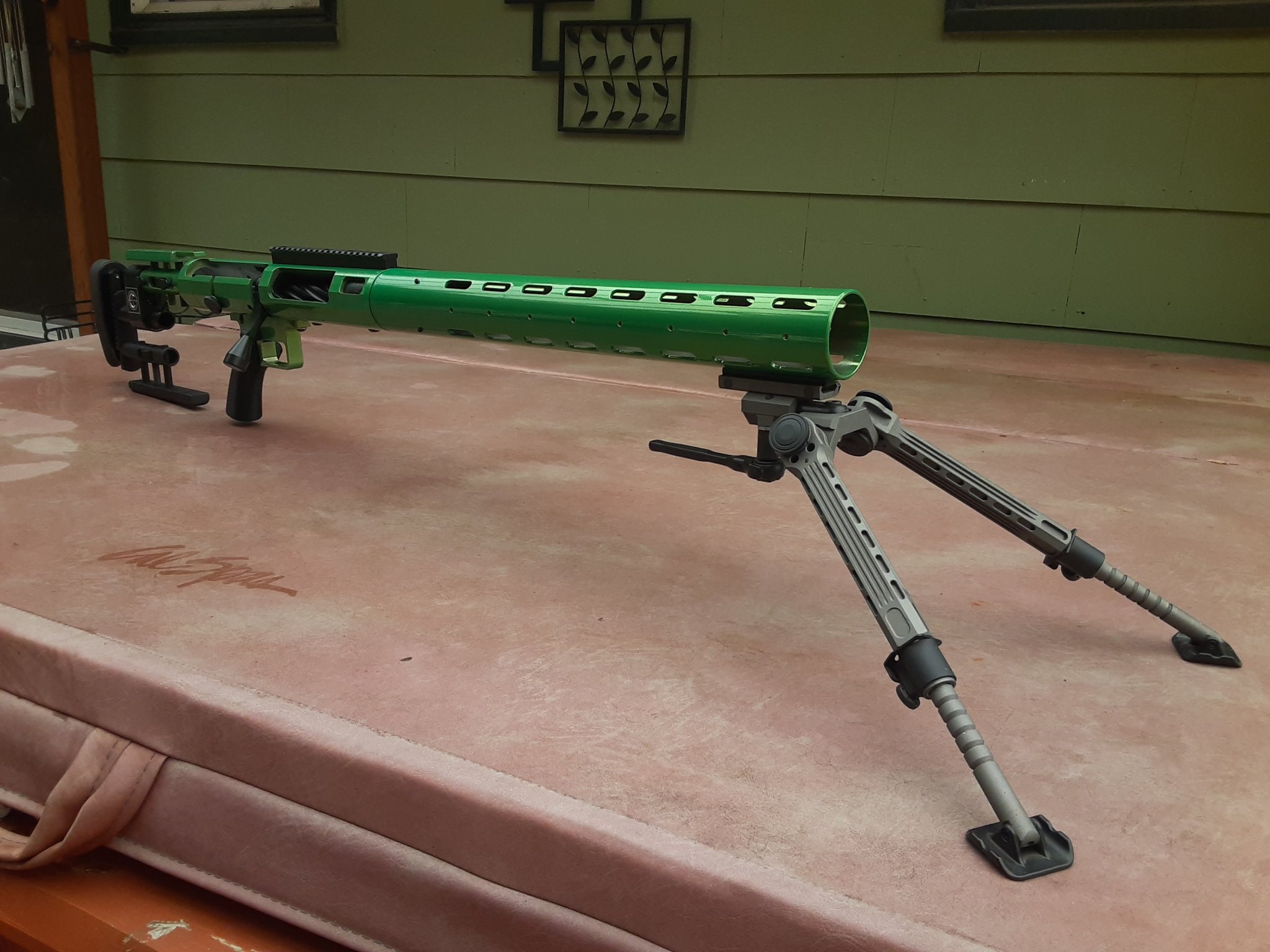

What kind of bipod is on the pics
The upper portion of the legs and pads are from utg pro the lower legs And bridge and joints i made. Its a Frankenstein bipod of my sick design. Very wide very stable in my openion the best folding bipod on the market. I will be building more in the future and marketing them. At its widest point feet are 22" apart
