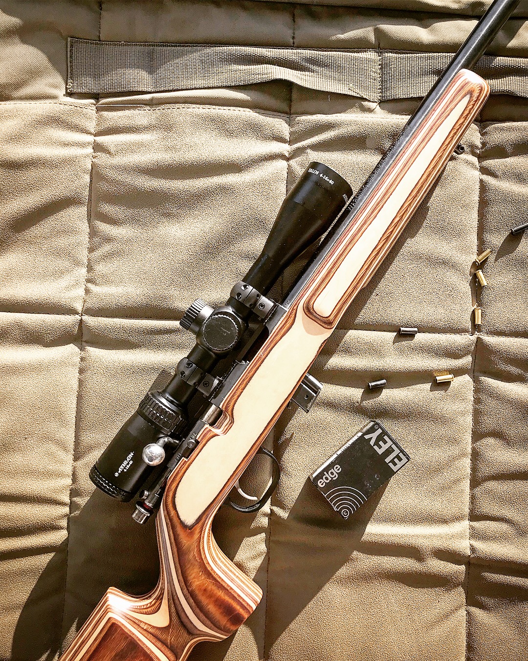

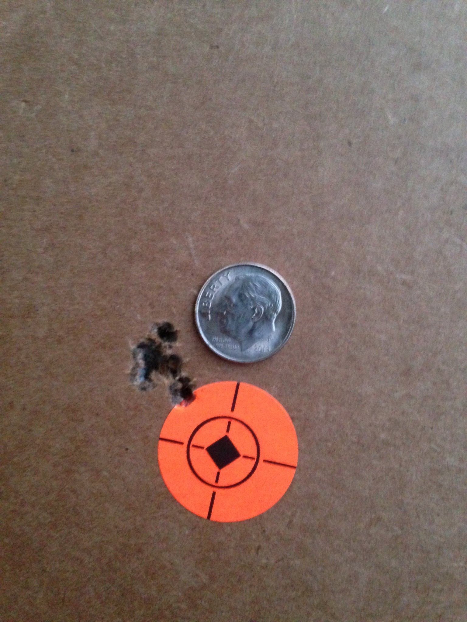

I too kind my savage fvsr out the other day and was shooting pretty good groups at 50 yds with CCI SV and a NFA RFK suppressor.

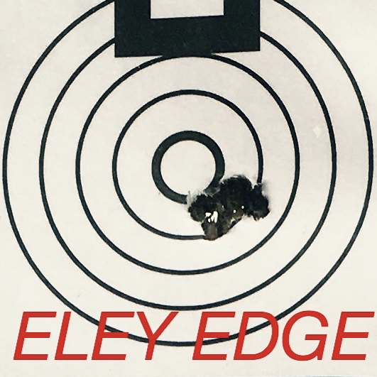

Savage mkii all day long. I have two, one stock and one in a boyds evolution stock. Both shoot one hole at 50 yards, but the stock stock is not very nice to use. Norma tac-22 is their favorite round and not too expensive. This is what i would have bought if it was available at the time: https://www.savagearms.com/firearms/rimfire/mark-ii/mark-ii-btv
^^This^^ I have a Savage Mark II BV. It also shoots one hole at 50 yards, using basic CCI SV. The stock is not optimal for NRL 22 matches though and I am considering another stock option. The rifle shoots way to well for me to trade it for something more expensive. I shot our LR 22 match using a stock pack as it was a last minute thing.

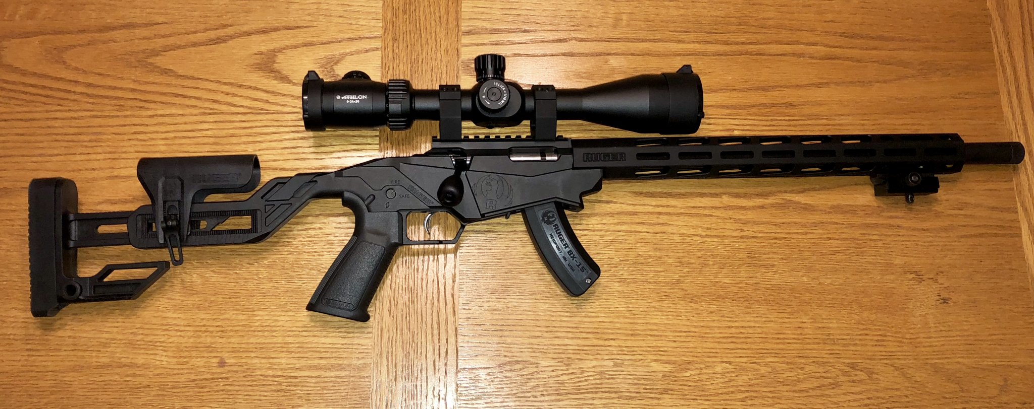

Build is complete and initial break-in started with about 125 rounds fired, all but 15 rounds of it CCI standard velocity.
  • Ruger Precision Rimfire rifle - $400
  • Athlon Argos BTR 6-24x50 FFP with sunshade - $368
  • Vortex PMR rings (used) -$40
  • Magpul pic rail for bipod - $8 (Harris adapter not included)
TOTAL $816
Some would say $800 is not necessarily "entry level" for a .22, but this rig is suitable for rimfire PRS competition out to or even past 300 yards as is, and the whole thing cost less than the Vortex Viper PST scope on my CZ-455.
Biggest surprise is the scope. Even at 24x, the scope is reasonably sharp, and the turrets decently crisp. I really lucked out to find the Vortex PMR rings used, in a nondescript plastic bag, at my LGS.
The bolt is very stiff, but is loosening up quickly. The trigger is reasonably crisp but heavy at a bit over 2.5 pounds at is lightest adjustment. Stock's LOP and comb adjustment is simple and reasonably easy to adjust.

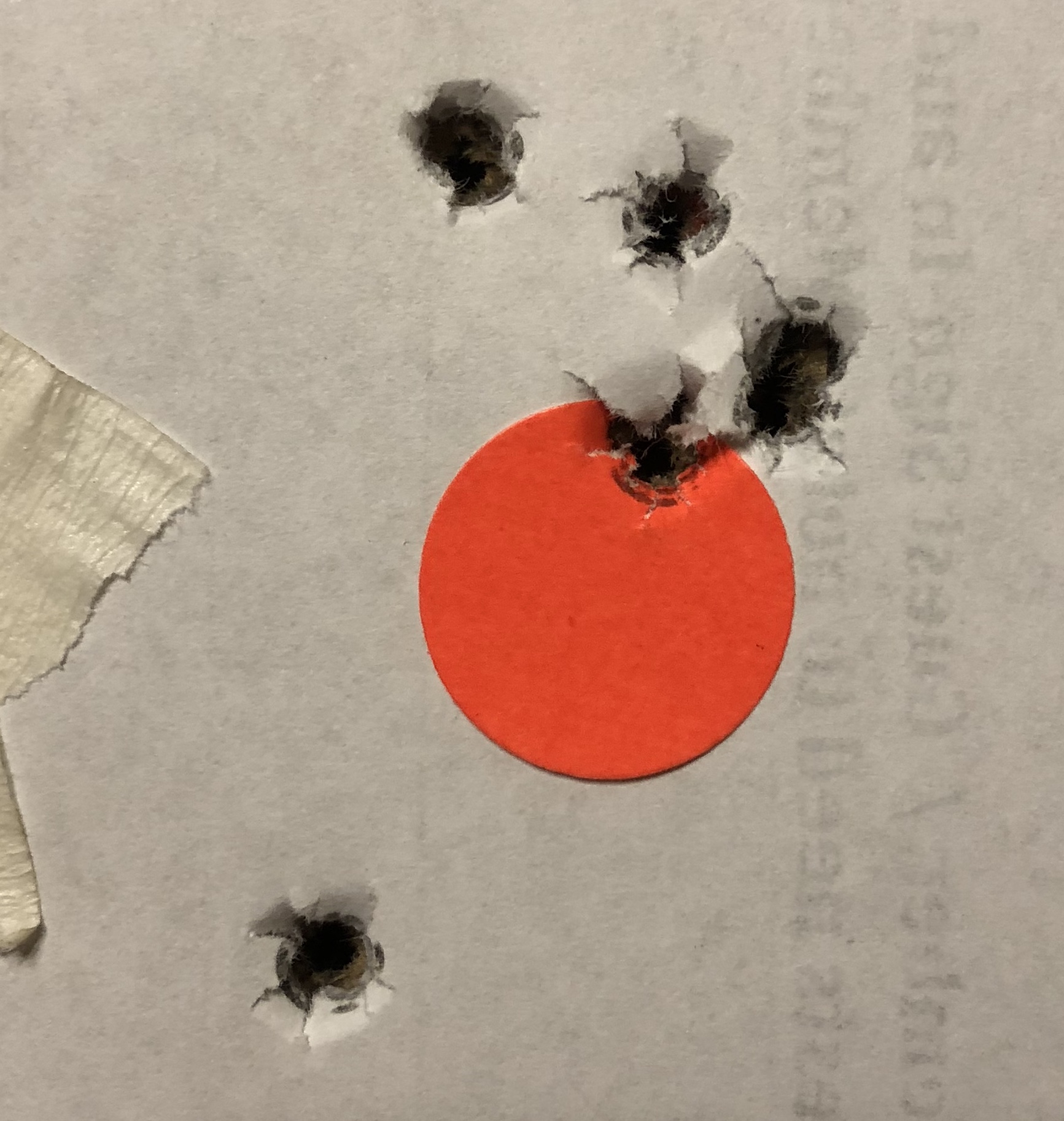

Accuracy is about what I'd expect at this price point. The image below is 6 shots of CCI SV at 100 yards after about 75 rounds total through the new barrel (the dot is 0.75"). The first two were touching each other, then the flyer, then the last three.
Your accuracy result is right around what we ended up with putting one of these together for a buddy to start playing along. His is currently stock trigger and barrel, Vortex Viper HST, Weaver rings, M lok harris adapter and a cheap bubble level. We ran Norma match, CCi SV, Wolf match, Sk Std +, Eley Target and Eley club xtra through it in testing and found the two Eley loads to be best in it and not enough difference from Target to Club xtra to justify the increased ammo cost. He's shooting Eley Target and averaging 1.2MOA or so. I don't think you can ask for much more out of a factory budget stick.

I also took the barreled action out of the chassis, removed the handguard and trigger from the barreled action, and cleaned everything up a little better. The preservative Ruger uses seems to be tar made from North Carolina (where these little rifles are made) pine trees. I'd like to put in a lighter trigger spring but, unlike Tikkas, the spring can't be removed without disassembling the trigger unit - removing the adjustment screw completely reveals that the spring is captive in the channel into which the screw fits.
I see you have all ready taken off the factory muzzle break, that is good as there are several reports of them having "baffle strikes" from the factory. Don't know it it is a threading problem or a bad batch of ruger muzzle breaks yet.
I used Honady One Shot Cleaner Lube on my trigger, well really all of my triggers. Take the lower halves apart and put the little red tube on the can and just spray the crap out of the trigger. It's amazing how much debris that gets left behind on factory triggers. After I did that I had a pretty decent trigger that was 1.5lbs without adjusting anything.
I flushed the trigger with charcoal lighter, blew it out with compressed air, and lubed/greased per the manual. The flushing did get a little debris out but not much. Pull weight remained reasonably crisp 2.5 pounds. After reading accounts such as yours, I had hoped for improved pull weight... didn't happen for me. Maybe my "budget solvent" wasn't effective enough.

You cannot expect "cheap" .22 ammo to be consistent, especially in terms of velocity. The cheaper the ammo, the more inconsistent it is likely to be. That goes for barrels and entire .22 firearms as well. There are numerous threads in the Hide forum collection and in other sites going into more specifics.
The flier in the photo was almost certainly ammo. I have worked with this rifle a bit more, trying lower-end match rounds and some other standard-velocity fare. The worst of these did 2-3 MOA (1 - 1.5") at 50 yards, with the groups spread out. Others would shoot two or three rounds into 1/4" and then fling a couple an inch away. CCI SV remains the best that I've used much in this rifle. This past weekend, it put 8 of 10 rounds into less than 1/2" but two fliers were 1/2" lower than the rest of the group and touching each other (50 yards) - which strongly suggests lower velocity. The rifle seems to be tightening its groups as more rounds are put through it.
It also showed some promise with Wolf Match Extra, but that's my personal stash - I bought half a case (2500 rounds) of the same lot because my CZ-455 really likes it. But the Ruger shoots CCI SV as well as my CZ.
The value proposition for the Ruger is just too good to ignore. You have to spend another $100 or so to bring a CZ-455 to where the Ruger is out of the box, as described earlier in this thread. Is the CZ more accurate? Maybe... Depends on the luck of the draw. But its for sure there will be aftermarket barrels in plenty for the little Ruger, so that's an option. Or, if it just doesn't float your boat, it will be really easy to sell. Every one that appears in the two places I pay attention to locally is sold immediately.
