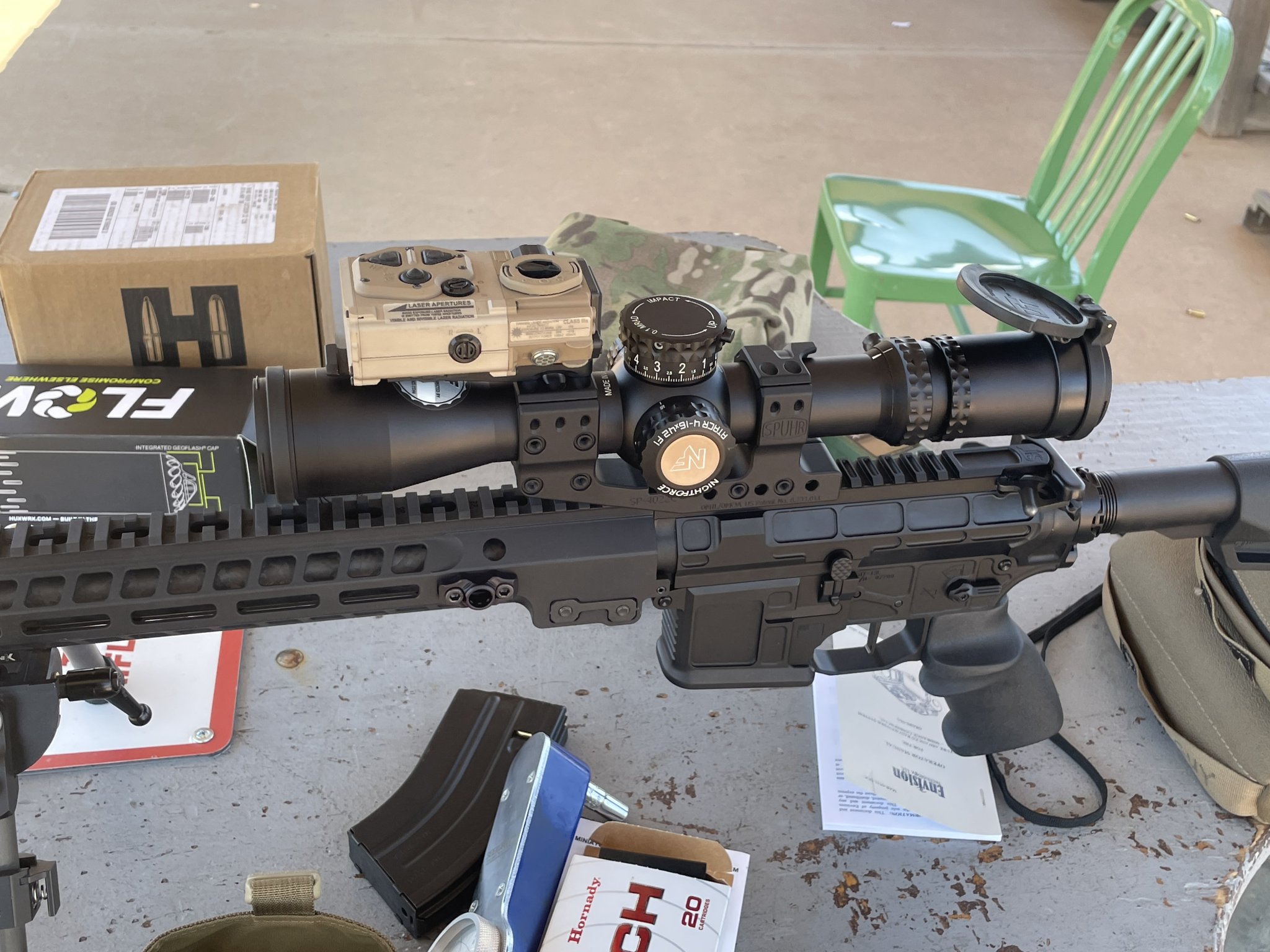

I just did a preliminary test with a Mars-mc head to head with Mars-c. Performance out to 1225 yards was nearly identical on steel. I also tried lasing a grassy hill at 1843 yards - Mars-c was slightly more successful. Again, just preliminary, but in the coming weeks I’ll do more practical testing.

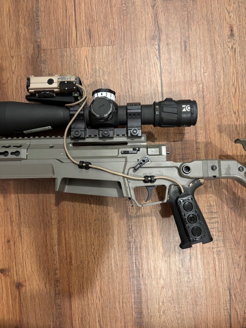

I cut the rubber coating on a magpul grip I had laying around to see if I could recess the remote into the grip. It worked pretty well, not perfect. Easy to operate without breaking grip and doesn’t interfere.
