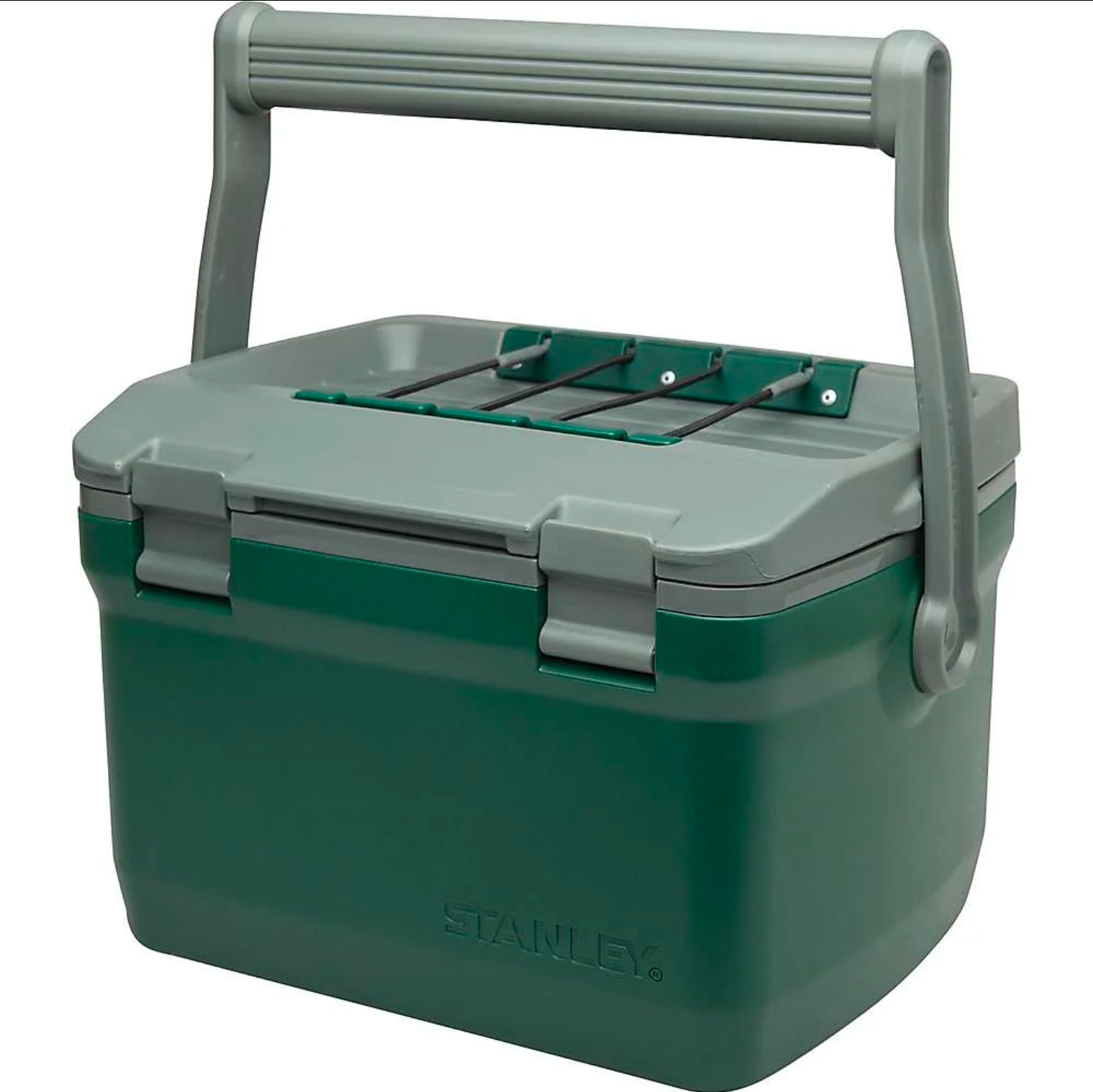

    What I do when it is cold is keep my test ammo and a small hard cooler soaking over night at 68-70°F . Then right before I head to the range I fill a flexible water 1 liter bottle w/ 85°f water.
    When I head to the range I put the water bottle and the mtm box of handloads in the cooler. The handloads maintain 65-70° while I open and pull each round in the frigid cold.
