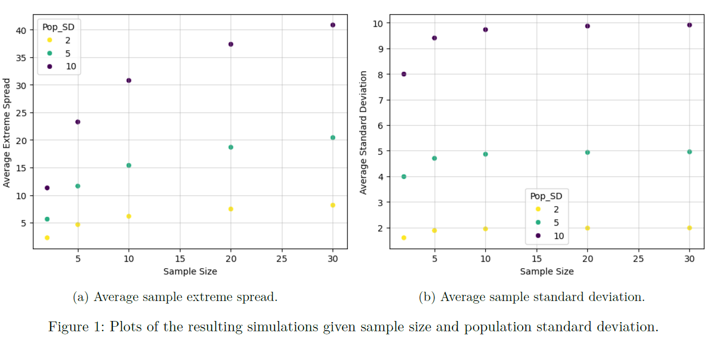

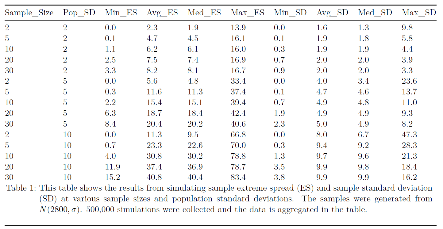

Something always keep in mind is exactly how SD and ES work statistically. Most aren't aware what the actual SD numbers their chrono spits out actually mean.
To get the correct data, you'll need to extrapolate the SD using confidence intervals and the amount of shots fired. 95% is the most common interval used.
So, for example, if you fire a 10 shot string, and have an SD of 8......using a 95% confidence interval, your true SD is somewhere between 5.5 and 14.5fps. Meaning if you were to shoot enough rounds to be very sure your SD is the true SD of the ammo, it would be somewhere between those two, 95% of the time.
Now, SD itself is a distribution. Meaning 68% of your shots will be within one standard deviation. If you have an 8sd, 68% of your shots will have an ES of 16 (8 each way).
95% of your shots will be within two standard deviations. Which means if you shot 100 rounds, 95 of them would be inside an ES of 32fps (two SD of 8 each way.
99.7% of your shots will be within three standard deviations. We'll just round up to 100%.
Which means, if you have a true sd of 8, if you shoot 100 shots, you will have an extreme spread of 48fps.
If you only shoot a 10 shot group and get an SD of 8, with the confidence interval calculated, you could actually have an ES of up to 87fps.
If you have a true to life SD of 5, your ES is 30.
That should put a lot of this in perspective.

I wanted to comment on the behavior of sample ES at small sample sizes. It suffers the same consequence as sample SD. As can be seen below, sample ES can be underestimated much like sample SD when the sample size is small. Depending on the population SD, convergence onto the population value can be as small as 10 observations or as high as 30 observations. Since you do not know the population standard deviation, you have no idea how underestimated the statistic might be. Worse, the plots below show “on-average” results. No one is testing their rifle 500k times just to estimate a statistic. The minimums and maximums in the table illustrate how disperse any one test could be. As one would expect, more observations shrink the range between the minimum and maximum.
TLDR:
ES at small sample sizes are unreliable.
