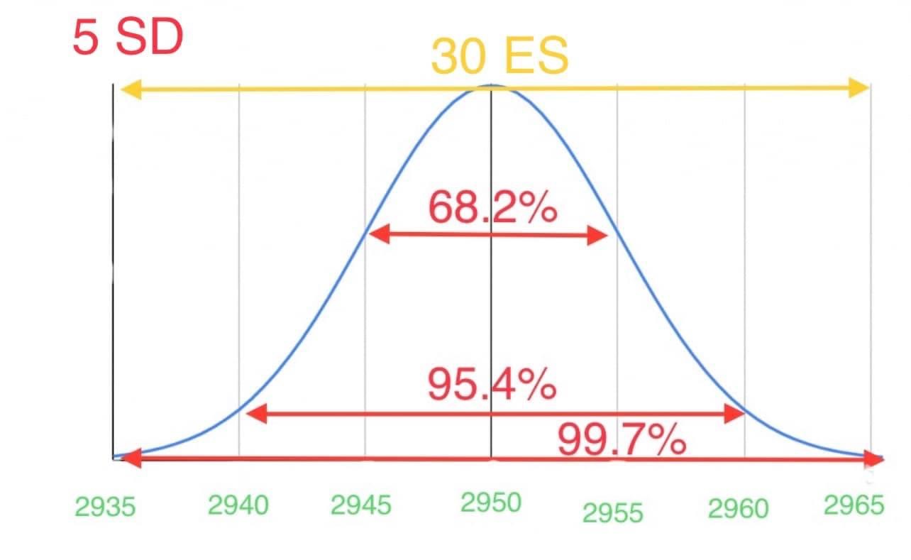

I just made a post about this on social media a few days ago.
Here’s a copy/past:
For anyone who doesn’t know exactly what your Standard Deviation really means, here’s a simple break down with visual aid.
The example:
Avg Muzzle Velocity: 2950 fps
SD: 5 fps
So, if we took 100 shots the breakdown would look like this rounding down/up)
68 shots = 2945 - 2955 fps
27 shots = 2940 - 2960 fps
5 shots = 2935 - 2965 fps
There is still always a chance (0.3%) of having a MV outside of this range. As well as you need enough rounds tested to have a confident avg velocity as well as SD.
What this also means is if you have a 10sd, you will have about a 60es. If you’re shooting practical/prs stuff, it won’t matter unless the targets are very small and very far away, which is usually rare.
To have a sub 20 extreme spread, you’ll need a ~ 3sd. Which is world class ammo (despite what your 5 shot string chrono told you.
This is also why you have to be careful when just looking at your Extreme Spread. It may or may not be telling you the whole story. Standard Deviation will give you a much better idea of what your ammo is going to do in the long run.
Explaining this to shooters who are having issues with their loading usually helps to lessen the stress and expectations they impose on themselves.

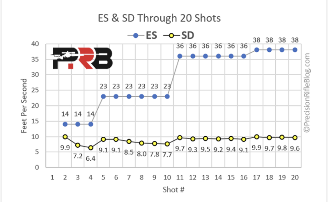

I’m going to point out again, because it’s that important:
Your ES will always be ~6 times your SD. 99.7% of the time to be exact. With 95% of the time your ES is 4 times your SD.
So, even those times when you shoot a string and it’s 20es with an 8sd……your ES isn’t actually 20.
Put another way, the TWO values that make up ES have the following effect in terms of effect on SD
3 shots 67% of the SD data
5 shots 40% of the SD data
10 shots 20% of the SD data
20 shots 10% of the SD data
50 shots 4% of the SD data
100 shots 2% of the SD data
Statistically speaking ES has no meaning other than the max/min values of a test data set. As test sample size grows ES will grow because the likely hood of testing a single extreme value increases. At the same time the actual tested sample SD will approach the true SD of a large population and the ES values represent extreme values unlikely to occur with any frequency.

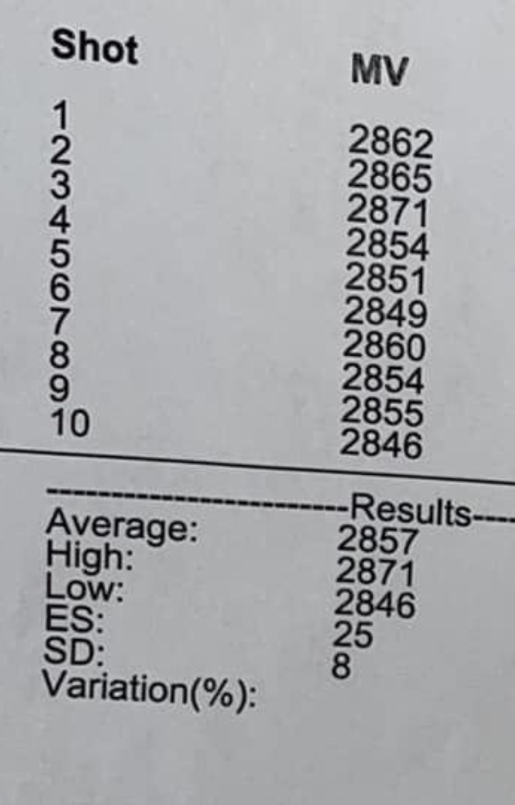

Here’s a very good example. Snagged this off a FB post. 10 shots over AB doppler.
Avg: 2857
SD: 8
ES: 25
Let’s assume the 8 sd is the actual long term SD.
If they were to shoot 100 shots, the ES would be ~48fps.
You could take another load and do the same thing and get an 8sd and a 48es.
And people would want to pick the 25es.
When in reality, they are both the exact same.
Remember, for this shooter:
68%: 16es (68 shots)
95%: 32es (27 shots)
99.7%: 48es (5 shots)
His ES of 25 was 1.5 standard deviations (12.5 each way). It was 14 up and 11 down. So, pretty close.
Which considering 68% is 16es…..you can now see how easy it was for his ES to say 25 when the SD is 8.
This is why SD tells the whole picture. It’s counter intuitive for many because people say “every shot falls inside of the ES”. Which is technically true. But your ES is usually much less statistically confident than your SD.

Common example of what happens to SD and ES in the long term. SD is more stable once you have a few shots. ES can always be affected by a single shot. Making it far less important in the long run.
ES directly affects the SD, and vice versa if you look at it from that aspect. 1 high/low fps shot will change the dynamics of the SD, no?

No. Once you have enough data to have a solid SD, a high or low velocity shot will not change it much at all. As shown in the graph above.
Hence having a 5sd will have a 20es 95% of the time. And 5% of the time it will be 30es. That 5% doesn’t change the sd.
And the comparison to OAL isn’t really applicable. Completely different. Also, you can make any load shoot small or large via seating depth. Completely different part of the puzzle.
Again, SD is theoretical as in it predicts what will happen. And with enough data, it’s extremely accurate at predicting what will happen.
ES is just an absolute measurement of the high and low. And it’s only valid if you happen to have stumbled upon the actual high and low shots in your string.
70% of the time, that won’t be the case (it’s probably a bit different than 68%, but that’s the easiest way to think about it).
