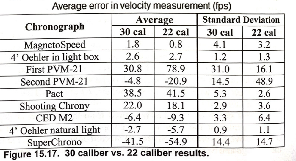

so first thing is to get the best chrono you can afford. but at least magnetospeed or labradar.
Magnetospeed website says 99.5-99.9 accuracy, Oehler says .25% error, Caldwell says 99.7%.....
2,800 fps with a .25% error is 7 fps. Kind of the "single digit SD" number that guys like to brag about. So, is that SD really what we think it is? Just bringing up the limits to accurately judging our numbers.
I realize I am the minority report, but I never gave much credence to "single digit" SD's.
Along the same lines, most don’t have sub 7-8sd. Even if their chrono is dead nuts.
5sd is basically world class ammo and rare to see over the course of 20-30 shots.
old new but...
Chorongraph-Accuracy-and-Precision-from-Bryan-Litz-Modern-Avancements-In-Long-Range-Shooting.jpg

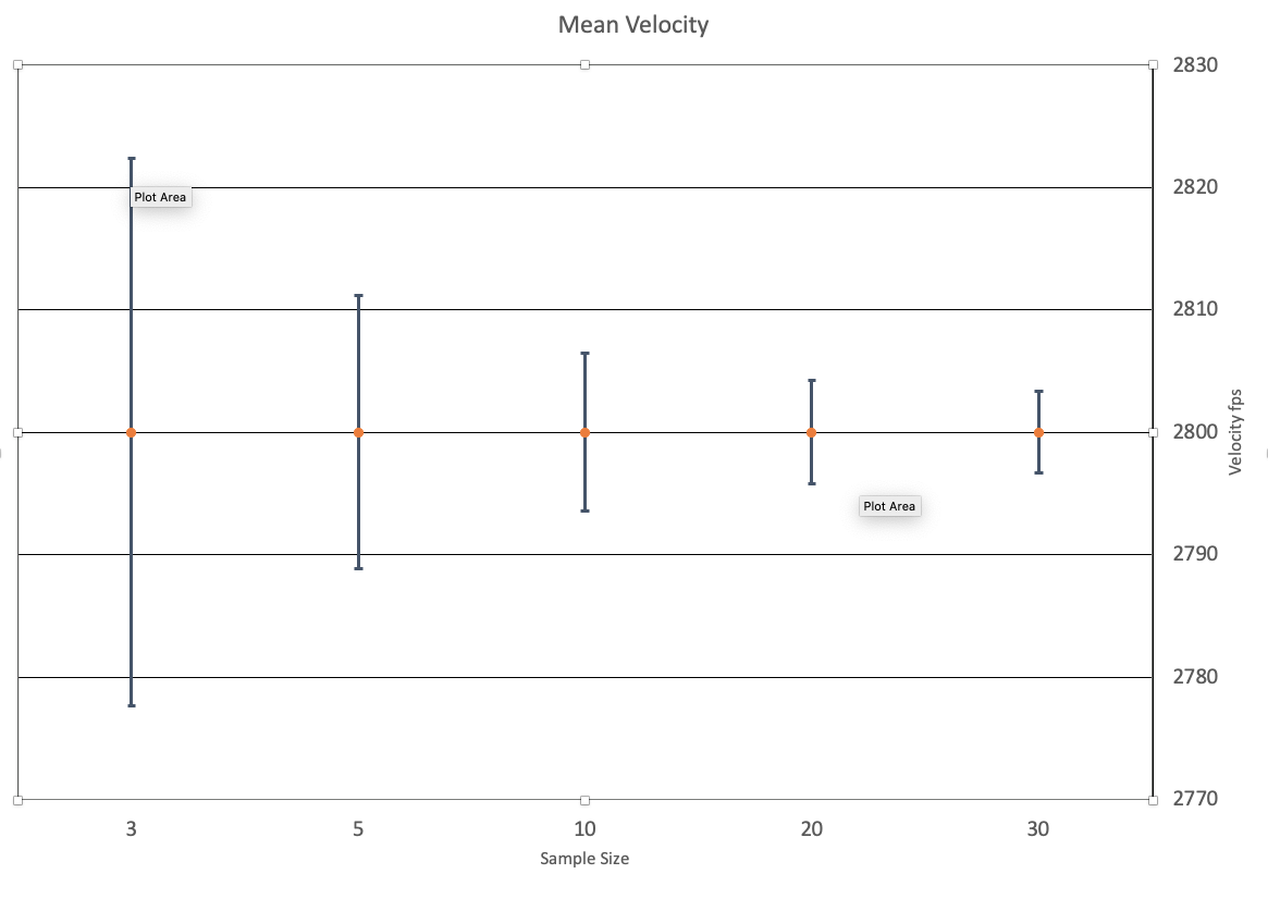

The likelihood of getting that SD or predicting an SD with 20-30 shots is remote in a statistical sample. You would need to to fire upwards of 250 to 275 shots to even arrive a 95% confidence interval assuming a margin of error of 5% FPS. Maybe you as a ammo manufacturer, have fired this many shots through a test barrel and have the data to support it, but I doubt many non commercial folks are going to be willing to fire that many shots.
That’s easily solved via ranges.
With 20 shots and assuming 95% confidence you’d be within 3fps of true SD. The reason I don’t get into that is because it will make more heads explode than already do.

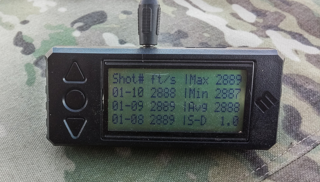

Honestly I don't really get caught up in the esoteric analysis of ES vs SD. I come up with a load using OCW, fine tune seating depth, and then measure it w/ a Magnetospeed to get a starting point for the kestrel. I obviously look at the ES/SD/Avg speed, and usually more often than not the numbers are low enough that I'm satisfied.
However there was a time many years ago that I was playing around with 180gr Warner Flatlines and CFE 223 with my .308. I was trying to keep it relative vs the 6.5s. I picked out 10 pieces of Lapua brass that were identical in water weight capacity, and bench rest prepped them in every way I could (trim length, annealing with an AMP, flash hole uniforming, etc) I used both OCW and a ladder test to ensure I had the optimal load. When all was said and done I loaded up 10 rounds and fired them over my Magspeed and got this:
ES 2, SD 1.0. I was blown away. Now it might have been a fluke and if I did it again may not have gotten the same results, but it was pretty awesome to witness. My lifetime best and where else can I brag about it except in a ES vs SD thread? :)

We have really gotten into the weeds so here is a little more to look at. When using a chronograph there is a point where the chronograph accuracy begins to effect the reading. If we consider a set of measurement with a LabRadar with an accuracy of 0.1% of reading and measure a mean (average) velocity of 2800 fps and a standard deviation of 9 fps the error due to the LabRadar accuracy is 2.8 fps. With getting deeper into the weeds the LabRadar accuracy begins to become a significant source of error when the error approaches 4x the error. As the SD begins to approach the accuracy of the instrument the Instrument becomes the controlling source of the standard deviation. When we measure in the range above 11.2 fps the instrument accuracy can be ignored but by 2.8 fps it is significant and comparing sampled values between those two points based on measurement alone is in error.
When we take data for a given number of points our goal is to hopefully use that data to predict how other rounds will perform and to do that we are faced with the application of probability. This is what the Precision Rifle Blog discusses. This means that we have to establish confidence intervals. It is often taken that the the confidence interval to be used is 95%. At a 95% confidence interval applied to the mean we would expect that 95% of a large number of rounds tested would fall within a range of both the mean and the standard deviation. The standard deviation confidence however is not a normal distribution since it is bounded by zero, there is no chance at all that the standard deviation can be less than zero. The range of the confidence interval is a strong function of the number of rounds tested or sampled. The two graphs below show what happens to the 95% confidence intervals as the number of points tested increases from 3 to 30 points for a mean sampled velocity of 2800 fps and a measured sample deviation of 9 fps. This is what your test data says about what you can expect from the larger population of rounds. Note that tests of more than twenty rounds does decrease the confidence interval but only slightly and sampling beyond 30 yields even smaller improvement.

Your post has great timing in that it illustrates what happens with small SD. If we assume a 0.1% accuracy for the Magnetospeed (I've seen both 0.15% and 0.1%) the accuracy of the instrument is +/-2.9 fps. That accuracy is based on a 95% confidence interval so the SD of the instrument is +/- 2.9/2 or +/-1.45 fps. Your tested SD is less than the instrument so the actual SD that can be assigned is 1.45 fps.
You have a 10 shot mean of 2888 fps with a standard deviation of 1.45 fps. In applying the confidence interval for ten shots says that you would expect 95% of the future rounds to fall between a mean of 2887 and 2889 fps! your SD range would be 1 to 2.6 fps.

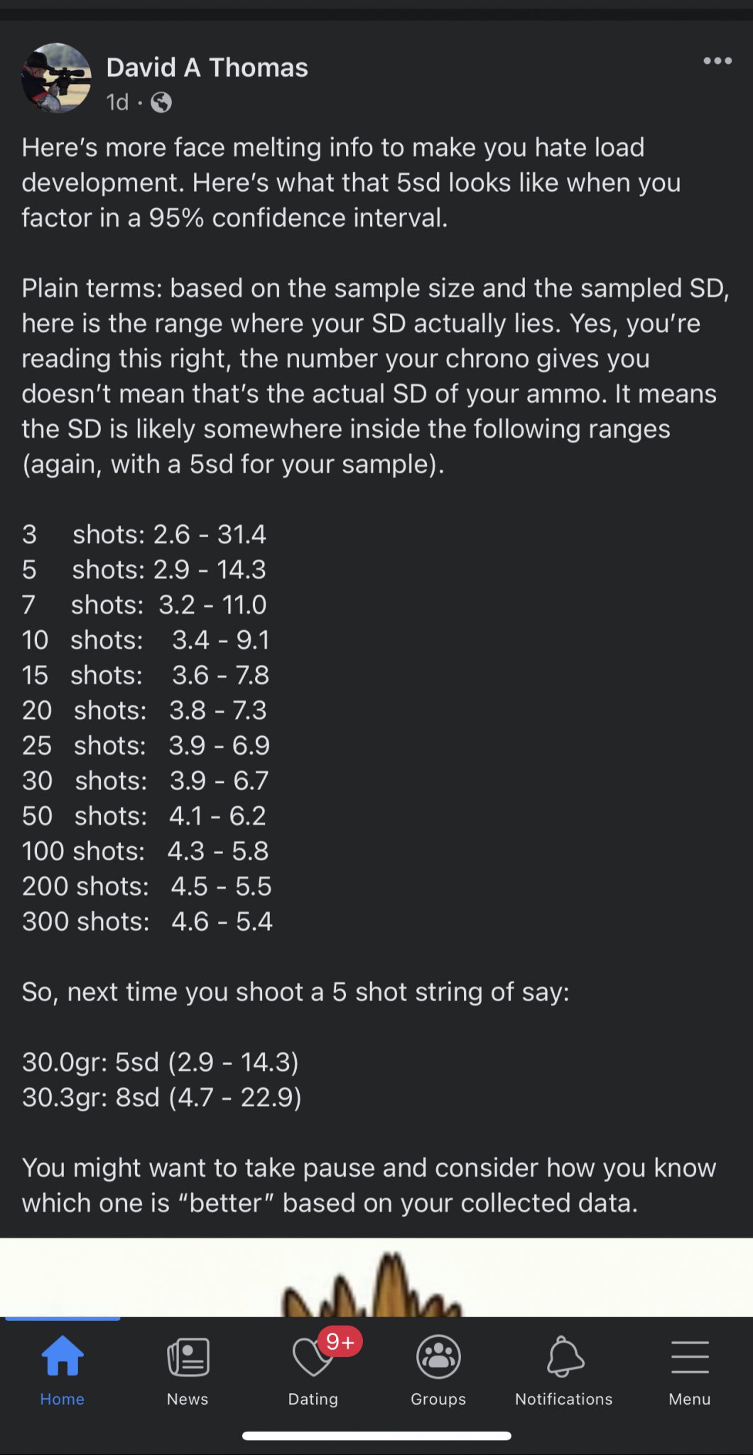

The real question should be something like this:
You shoot a 5 shot string of 30.0gr and a 5 shot string of 30.3gr.
You get:
30.0: 5sd
30.3: 8sd
When we look at a 95% confidence interval, we can be 95% certain the true SD lies within the following ranges:
30.0: 3.0 - 14.4fps
30.3: 4.8 - 23.0fps
Knowing that tidbit of info, how would you know that 30.0 is “better” than 30.3?
Because almost every shooter out there would immediately pick 30.0 as the “better” or more “stable” charge weight.
Reactions: kthomas
You get:
30.0: 5sd
30.3: 8sd
30.0: 3.0 - 14.4fps
30.3: 4.8 - 23.0fps
You get:
30.0: 5sd
30.3: 8sd
30.0: 3.0 - 14.4fps
30.3: 4.8 - 23.0fps
That is where ANOVA come into play and the comparison of two SDs to determine if they are statistically significant using F-Test or ChiSquared tests.

The good news is, you’re 95% likely between:
7.0 - 12.5sd
Which means for each, 95% of the time the es will be:
28 at best (if the sd is 7)
50 at worst (if the sd is 12.5)
And bippity boppity bacon you magically have a very good idea of what your ammo is really doing. Somewhere in that range.
Imagine telling people the 20 shot string with an 8sd and the 20 shot string with 11sd are too close to differentiate from one another?

So it is free to play with that web tool.
TL;DR you need roughly 30 samples. It is borderline silly to crank SD numbers or extrapolate six sigma from five shot samples.
For the same reason that a sample average can continue to update as more samples are poured into it, the probability of estimating the actual average, actual ES, and actual SD gets better and better with more samples. (Remember that the acceptable risk is set at CI of 95%, but you can raise that or lower it too).
But, before we loose the attention of the audience who is still asking a simple question... How many samples does it take to study an SD good enough to estimate an ES... to answer your question in the light of a 95% Confidence Interval, with a well behaved (normally distributed) muzzle velocity performance....
If the chrono, ammo, and gun are well behaved, we can start to see the estimate converge somewhere between N=15 to 30.
When it doesn't, it is because something is sloppy.
To watch this with the web site tool, just plug in a single digit SD of say 5, and using the 95% confidence level, watch the error band in the value change as you go from N=5, to 7, to 10, 12, 15, 20, 25, and finally N=30.
You will notice how the low sample numbers leave a lot of room for error, and how after 15 or more things start to look much better, and as you get to 30 the improvement slows considerably. Nobody is saying 30 is perfect, just that we get close enough by then when the data looks smooth.
Even at 30 samples, and SD of 5 is supposed to be good enough to estimate an ES of 30, isn't it?!? Well, in reality we are saying the answer is really 95% C.I. = [3.9820, 6.7216] So if we multiply those high low values by 6 the ES can range from 23.9 to 40.3 for 95%CI.
So, even after you took your 30 samples and got an SD of 5, your ES still runs a risk that it is really 40.3 instead of 30.....
The take away then, is not just that you need nearly 30 samples to have decent stats for your DOPE...
It is that N (the number of samples) and CI (the confidence interval) are still really two different things, and you need to understand them both. They tell you what you think you know about your dope when you set that risk level and budget your number of samples.
If you are taking samples, and see that your sample average, sample SD, and sample ES is not stable, then you keep taking more samples.
You also learn to accept load development risks and not stop and take that many samples till your method and process says you think you are in tune and have a good reason to want to know the average, SD and ES.
Taking large samples of half baked garbage makes as much sense as generating SD or ES values with three shots. YMMV

How would chronograph margin of error factor into your calculation?
When we do an analysis of calibration errors and their effects on calculations, we call that an uncertainty analysis.
We then start taking measurements, apply the stats, and then if we need to be formal, we then run things like WCS (Worst Case Sum), RMS (Root Mean Squared), etc. on those tolerances, and combine the effects.
In ballistics, we end up running a CEP (Circular Error Probability) analysis for where projectiles will land, and that folds it all in.
You can eventually also start to separate process variation and measurement variation. If you know your measurement is 1% you can can start to add that into the calculation. Thus once you establish the measurement SD, the total Variance (SD*SD) minus the measurement varirance (SD*SD) gives you your "process" variance (SD*SD).
Assuming your measurement variance is of course normal/guassian.
Of course when I was doing this I had multiple measurement tools and multiple process tools, which actually makes things easier as I have a TON of data. But we were also able to see tool to tool variance among other subdivisions. And we also had standards to measure and calibrate our measurement tools. That is a LOT harder in the shooting world.
