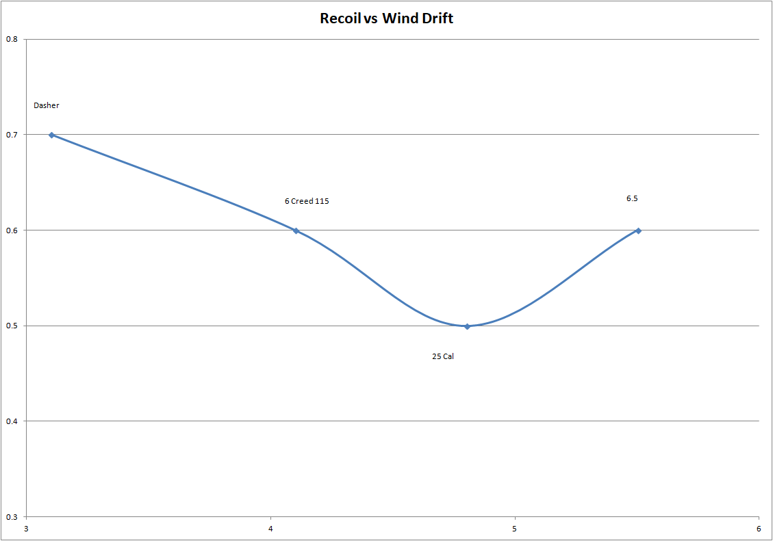

Here's some rough numbers comparing typical loads between Dasher, 6 Creed with a 115, 25 Creed, and 6.5 Creed.
Left axis is wind drift in mils at 1k yards, for a 3mph wind (ie how much you'll miss by if the wind switches or you called it wrong). Bottom axis is recoil energy in ft/lb.

Have you cross check all those numbers?
Wind drift for the 156gr looks to be 0.5 also
6 Dasher with 109gr ( let's use optimal bullet for all) would be 0.6
Then the plot positions is looking quite different.
They are all JBM numbers run with the same environmental conditions.
A Dasher with 109 hybrid at 2820 just barely breaks into the 0.6 mil wind drift range. It also is slightly more recoil, 3.2 vs 3.1. Probably would be easier to see the graph if it was inches of drift instead mils, but the net result is the same trend line.
As far as 25 Creed with 135 hybrids vs 6.5 Creed with a 135 Atip, the 6.5 creed will take a bit more powder to hit same speed, have a tiny bit more recoil and have worse BC, all with a more expensive bullet. Seems like 25 Creed would be the preferred choice between those two.
