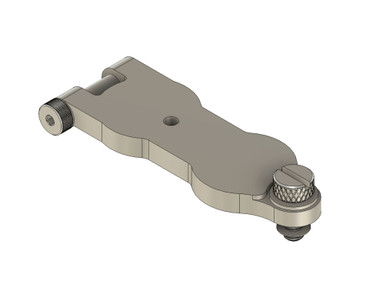

I make a replacement cover for it that's waterproof, but you can also see a little more detail about this behavior on the product description:

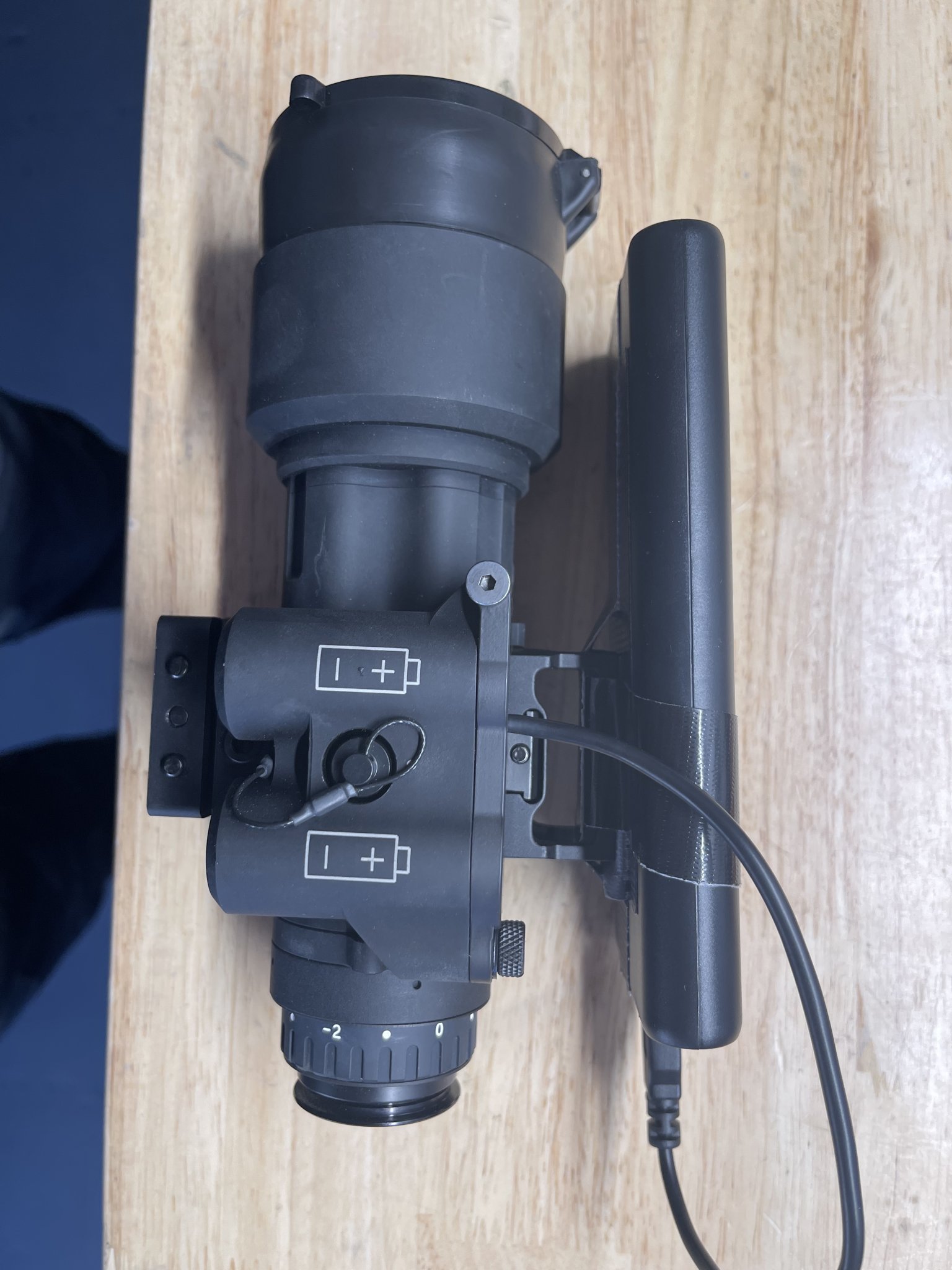

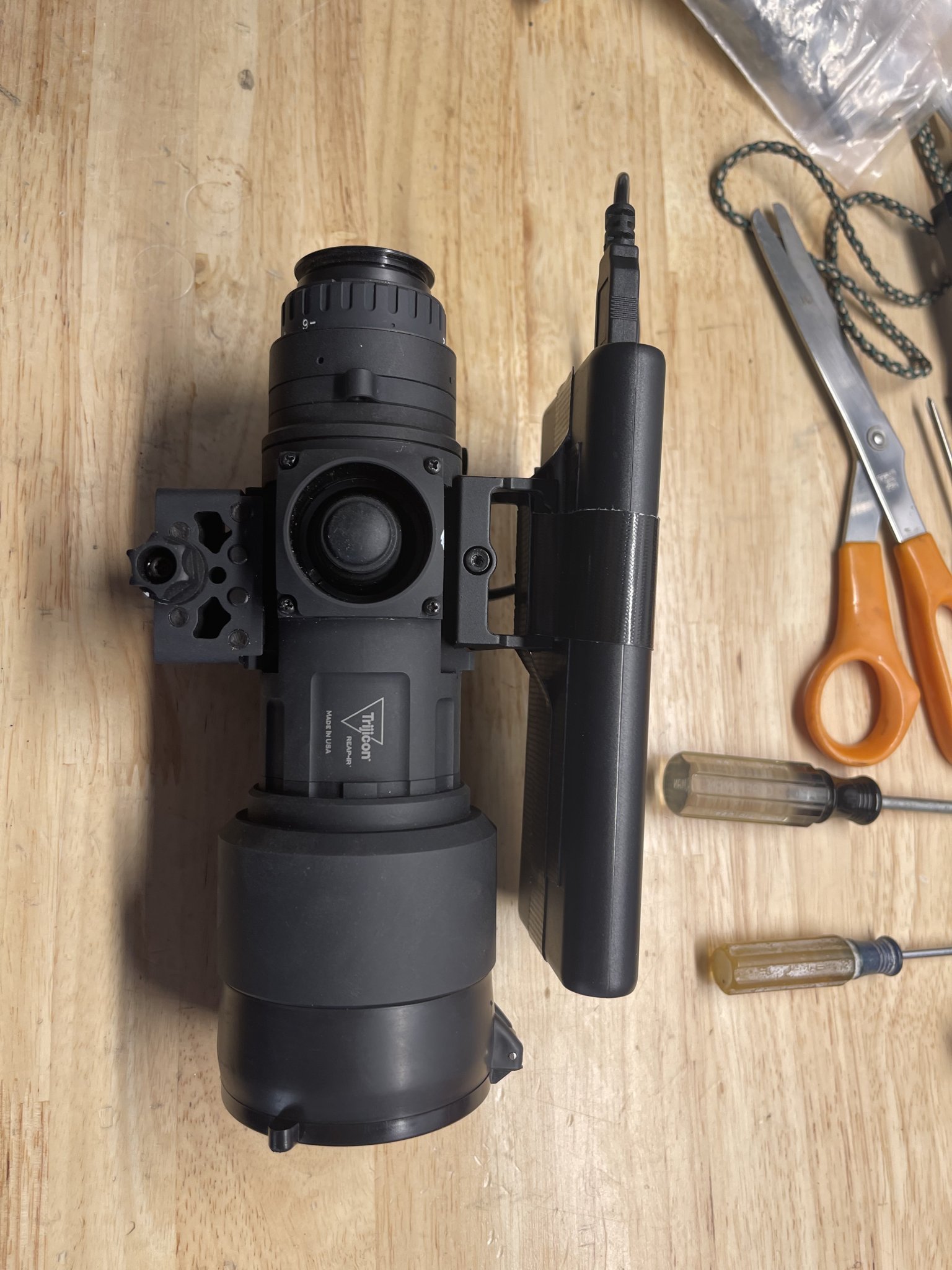

Here it is and hooked up to a 26,800 mAh battery. Plenty of juice. Also in the stand waiting on the evening hunt. Shot a pair of hogs that night. I will add a set of Velcro straps so I can swap batteries if needed in the field. Right now it‘s held on with Gorilla tape and I used a mount off an Sig Romeo red dot.
