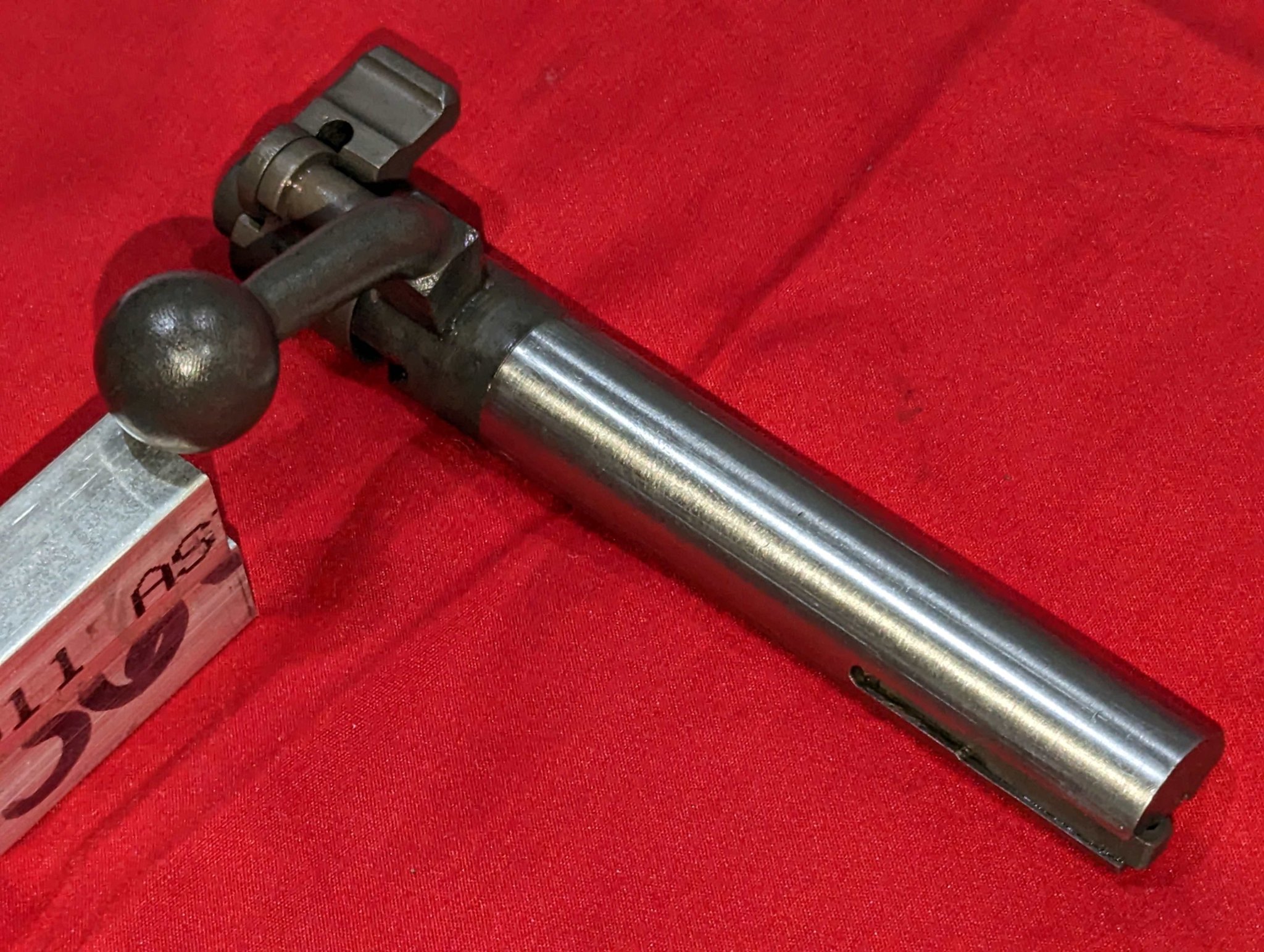

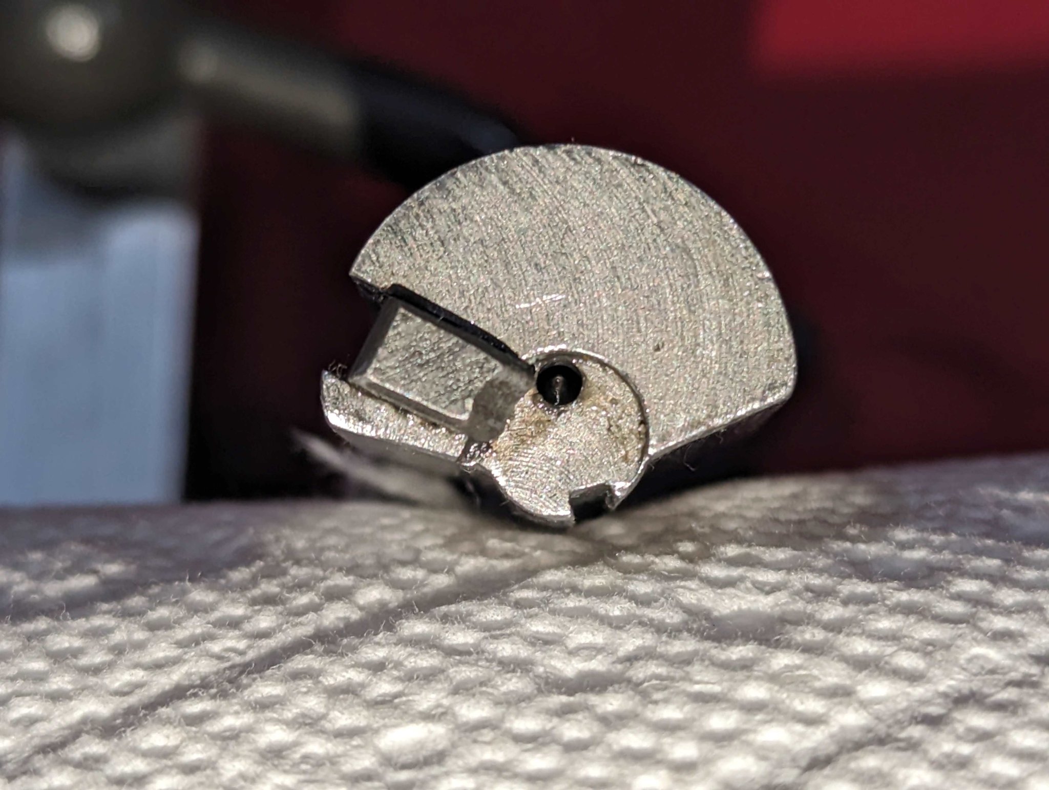

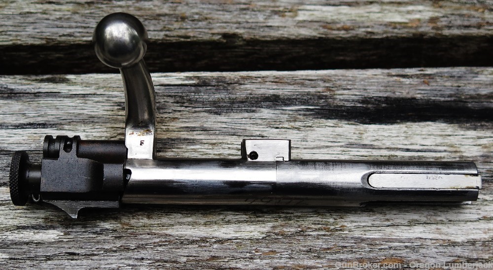

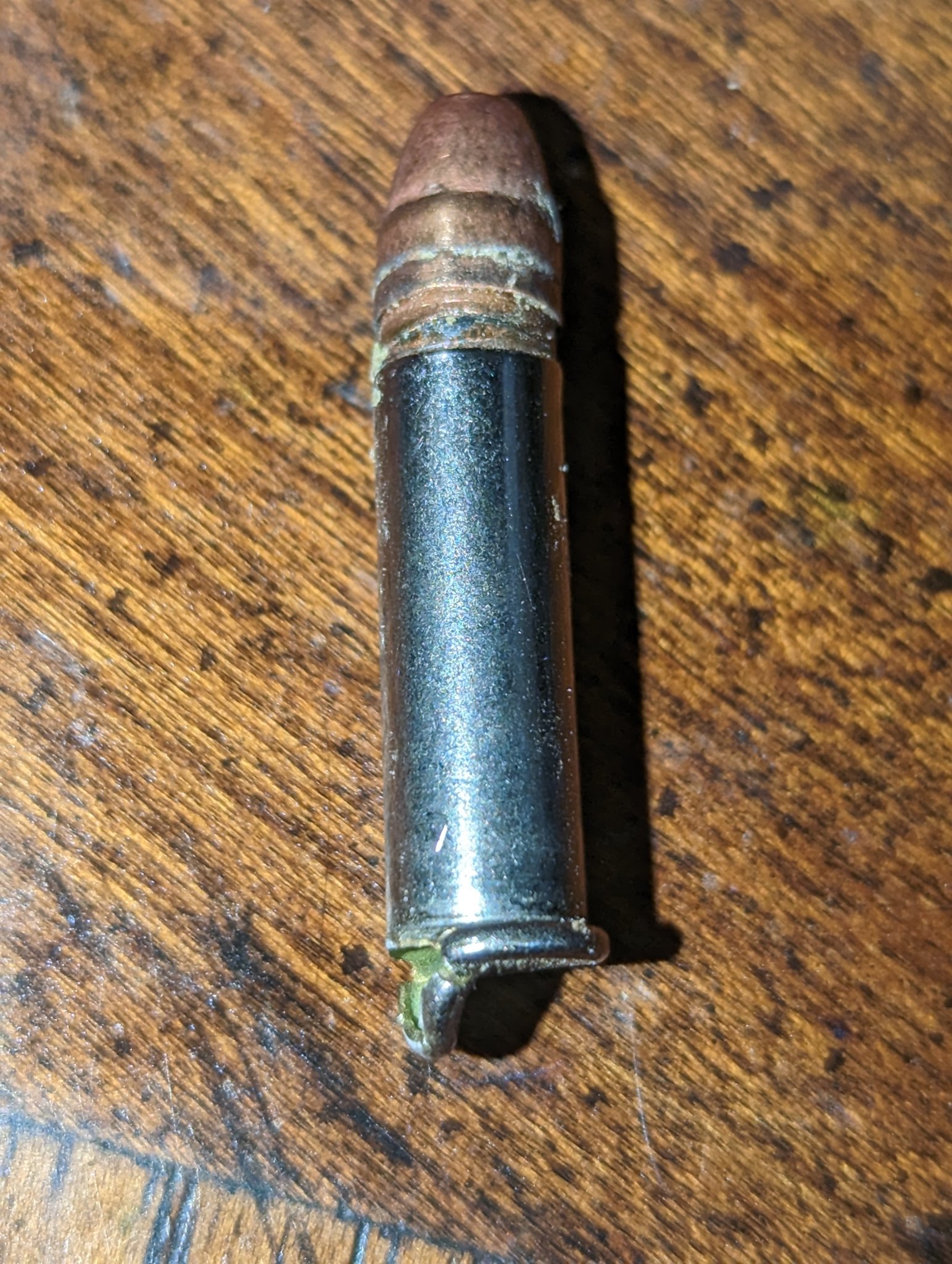

    I'm often surprised at some of the issues that still seem to exist. Below is a case from a 1957 Linehard / Anschutz conversion
    and you can see that the extractor isn't going to let go of any case rim. Its extractor has a profile that surrounds the case diameter and has a sharp edge. It is similar to the 1945 French MAS bolt attached in image #2 and #3 They put a little bit of thought into the finger shape to insure extraction. My Springfield 1922 has a very robust, side mounted leaf type extractor that is also bomb proof. See image #4. Most of the newer guns like my B14R or even my Vudoo have simple, thin extractors with no case profile at all. If they figured it out in 1922, 1945 and 1957, why are the manufactures having so many issues now? A typical design approach is to springboard from prior designs and make improvements upon them, not start over from scratch. Adding springs to overcome a poor design is just a band-aid. Also consider that making profiled extractor fingers in 1922 thru 1597 took a little more time and effort. With today's multi axis tools it should be a non-event. I just looked at a few of my rifles and many have fingers that have a similar design as image #2. They took great care when designing the finger. I looked at My B14R a year ago when people were complaining about FTE and noted that the finger was about .060" wide and the clearance area for it is over .187" wide at its narrowest point. So in theory, you could get an extra factory extractor, mill the slot in the bolt to .12" wide and have a double finger extractor system with very little work. A new .12 dia. spring could be installed too. My Bergara never had any FTE issue but I only shot good match ammo. I normally get a few spare parts for all of my guns....My Vudoo extractors and springs have to be described as "SNEAKY" to remove. LoL They don't have any pivot pins or obvious modes of retention.
