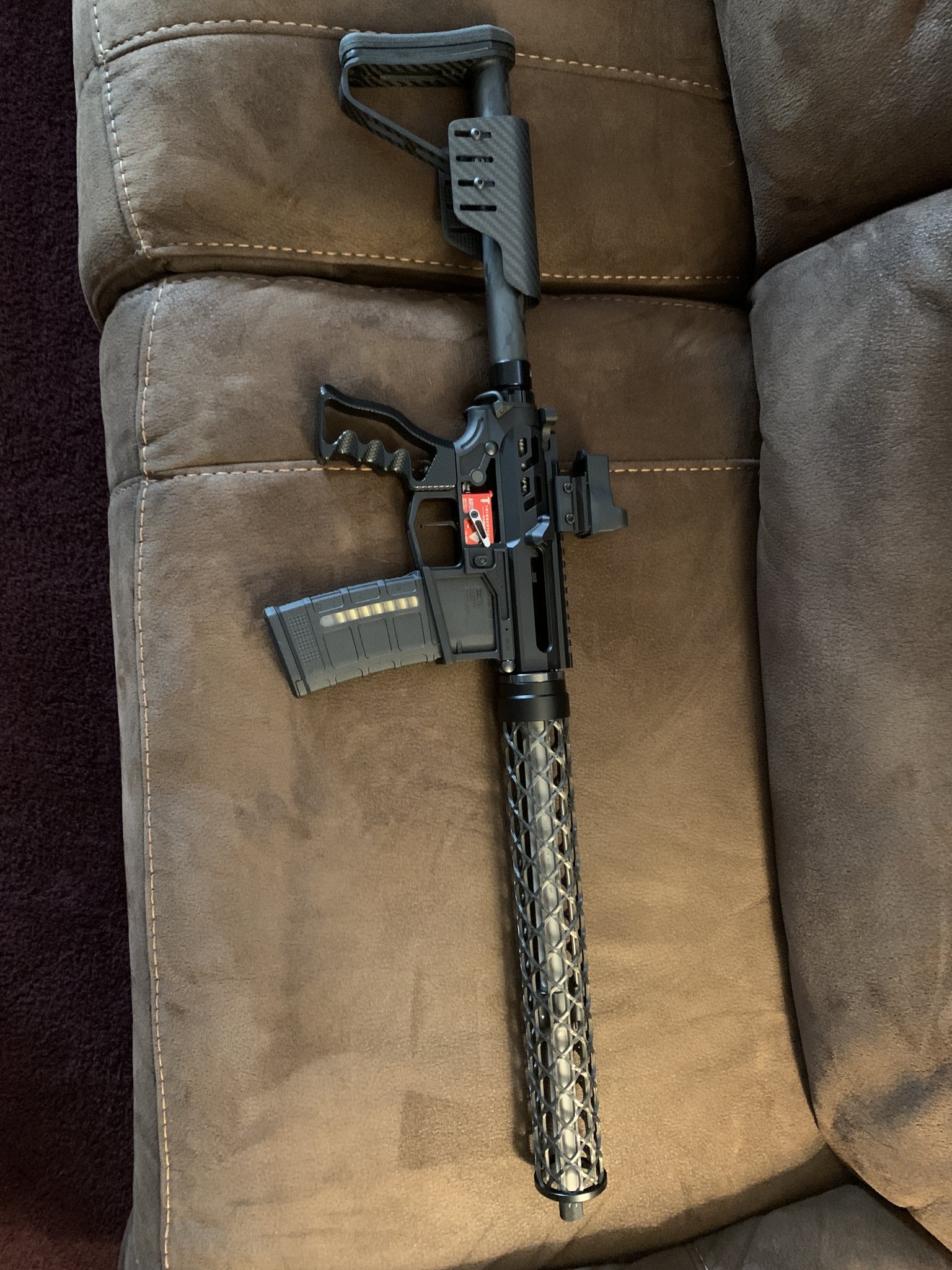

What handguard is this one?
Thank You

Another company is Smoke Composites.
Edit to add, that is why I'm selling the Faxon, is I went with the 10" Smoke as I have one of their buttstocks.
