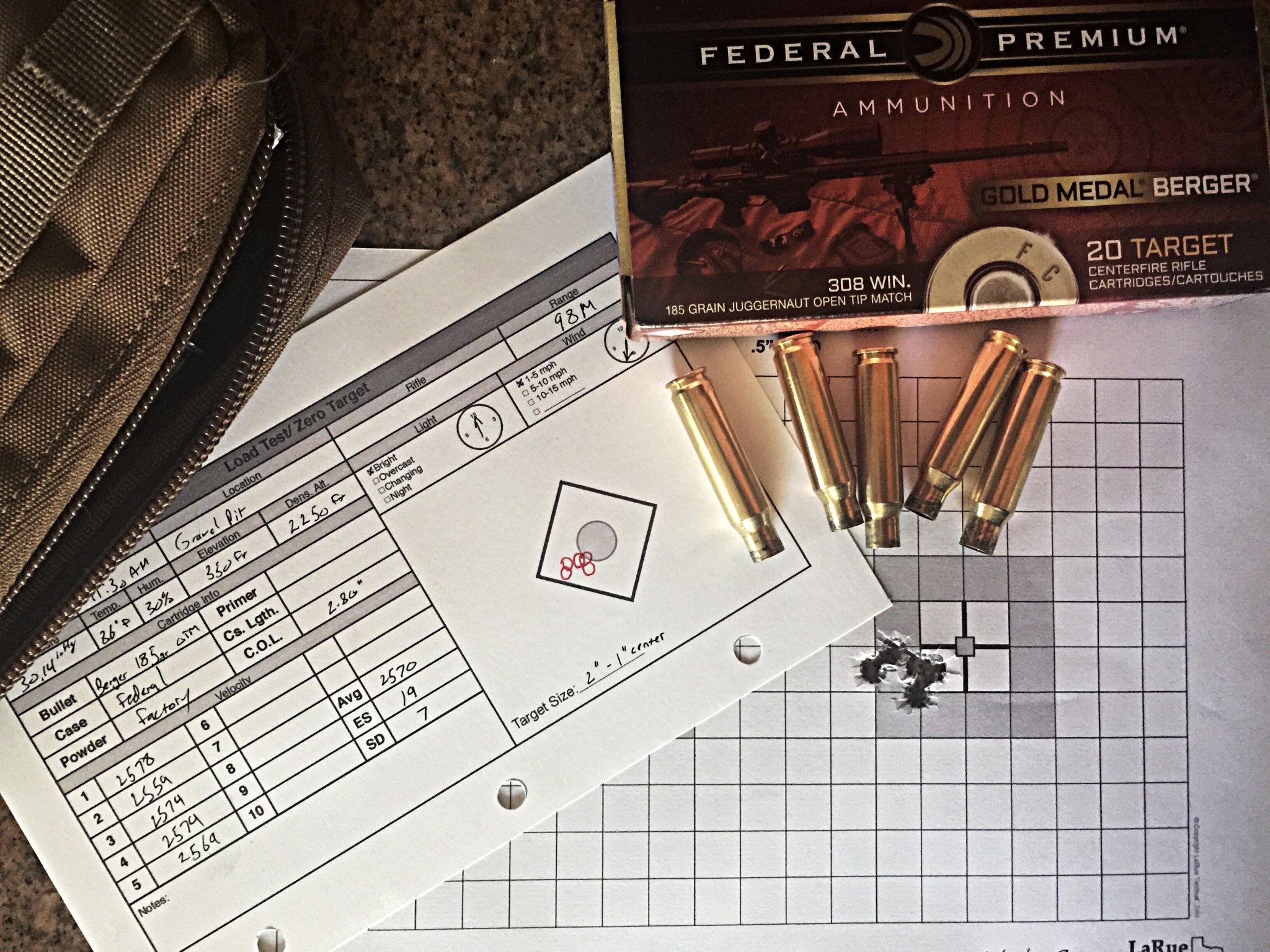

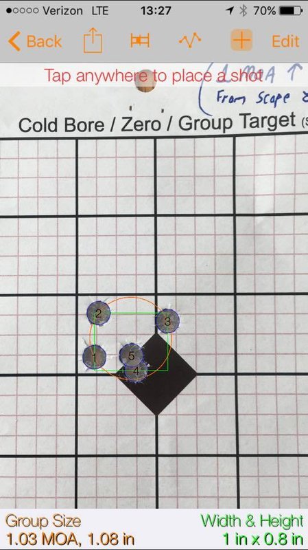

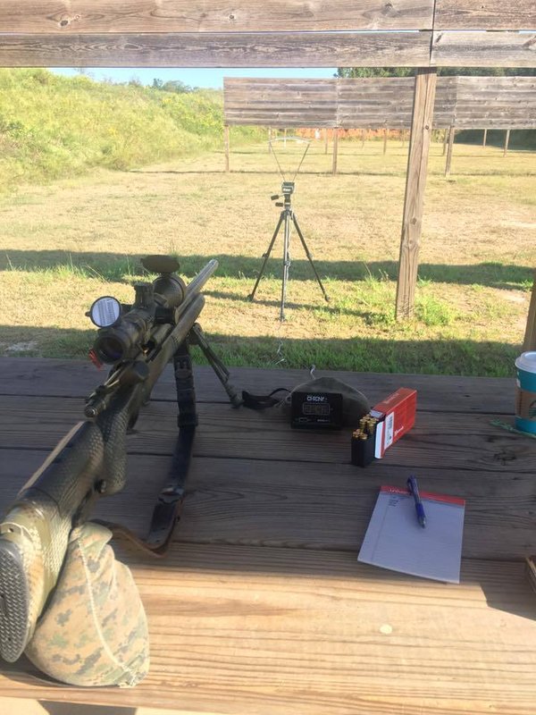

I bought a box at my local store.....took it to the range for a little testing.
Rifle: GA Precision Rem 700 with 22" barrel. 1:11.25 twist rate
Chrono: set 15 ft from the muzzle
Average velocity was 2567 fps.
I shot the rifle on a bipod with rear bag off the top of a picnic table. In hindsight, I should've shot from the prone position, but didn't. Not happy with the group, so will go out another time & try again...

Give 'er another try from prone. But, remember every rifle is different and may just be a load that your stick isn't fond of.
Yeah, it shot the Hornady 178 ELD-X ammo much better.....the table wasn't built the best & had a slight wobble I had to deal with.....I'll definitely go prone next time....

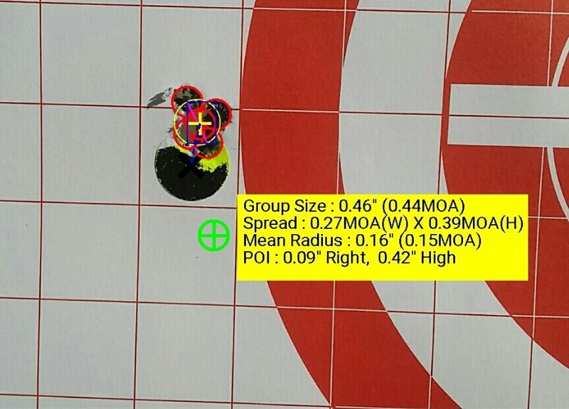

So I just got a couple boxes to try. Basically, if this stuff came out about 5 years ago I wouldn't have had a reason to handload for this particular rifle. I was adamant about using the 185gr Berger bullet. This ammo shoots damn near identically to my load. 2570ps out of a 20" Shilen barrel, 7fps SD, and even to the same point of impact.

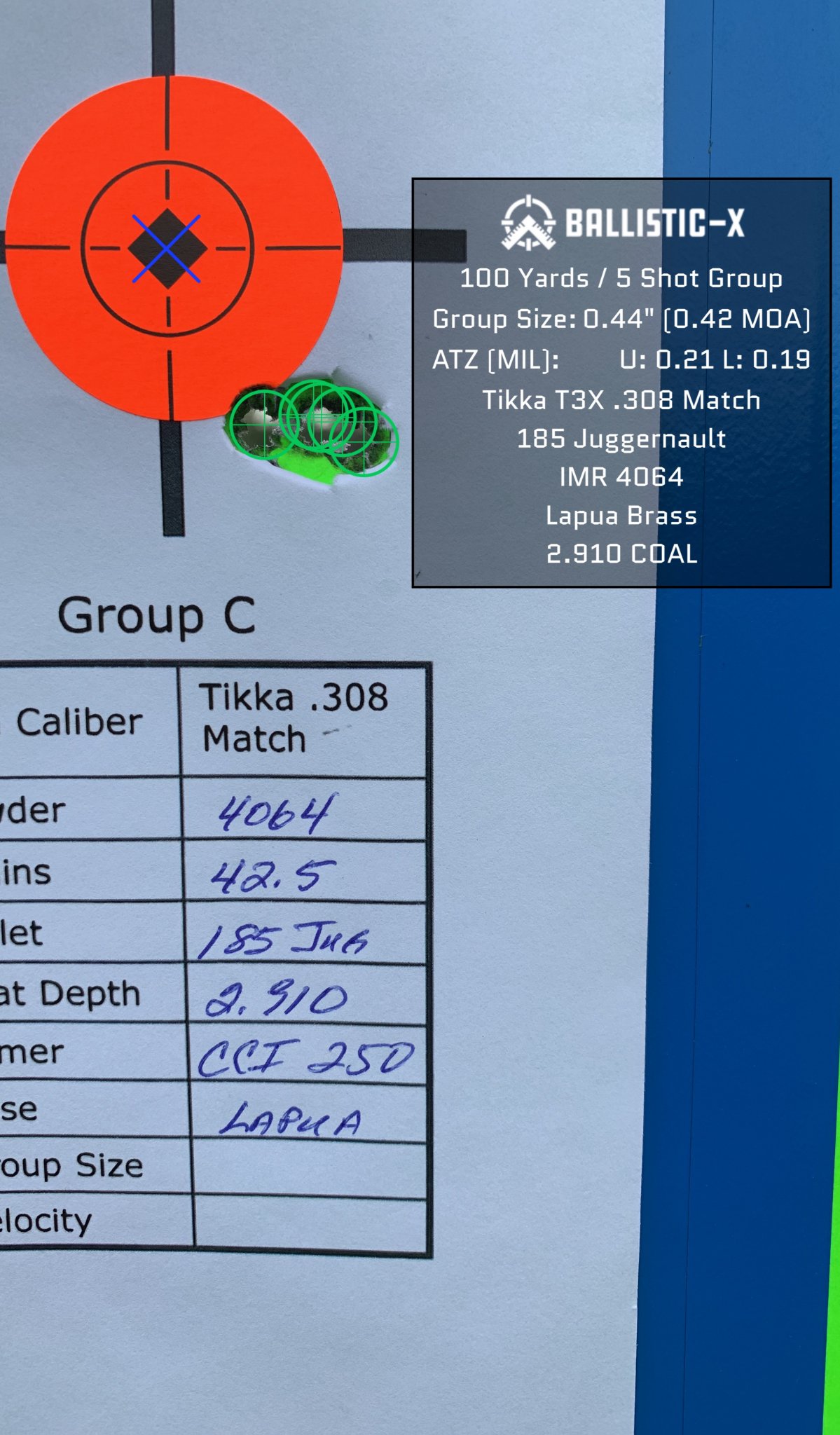

I've shot both the Berger Load and Federal Load - 26" Medium Palma Barrel in a Tikka Action
Difference: Federal - published FPS: 2600; Thru my rifle: 2707 FPS With 13.3 SD; COAL: 2.800
Berger - Published FPS: 2628; Thru my rifle: 2645 FPS with 8.1 SD; COAL: 2.910
ATTACHED is my load:
