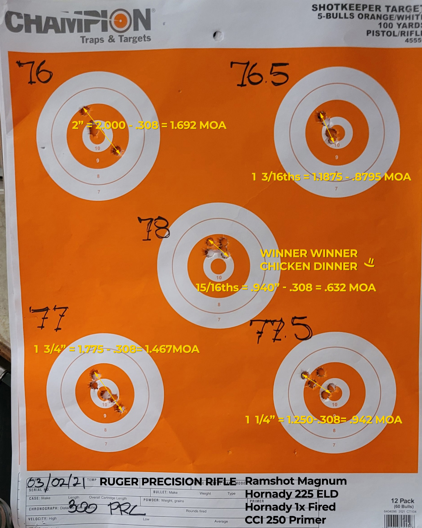

    Being a redneck at heart --I don't care much for numbers ("Math?? -- What's math? LOL) but a friend says I need to up my game here if I want to get good. Instead of "Just try'n a'make those little small holes closer to each other" like I do... He says "I gotta figure shit out."
    Is my math right here in doing MOA calculations for my work up load?

    So what is the formula to convert inches to MOA
    So I shoot a group with my 308. It measures .68 Center to center.
    What is that in MOA.
    If you are being that precise multiply group in inches ×.955 then divide by range in hundreds to get MOA.
    At 100 yards:
    1.047" x .955 = .999885 ÷ 1 = .999885 MOA
    At 600 yards:
    5" × .955 = 4.775 ÷ 6 = .795 MOA
    12" x .955 = 11.46 ÷ 6 = 1.91 MOA
    If shot at 100 yards .68" x .955 = .6766 MOA
