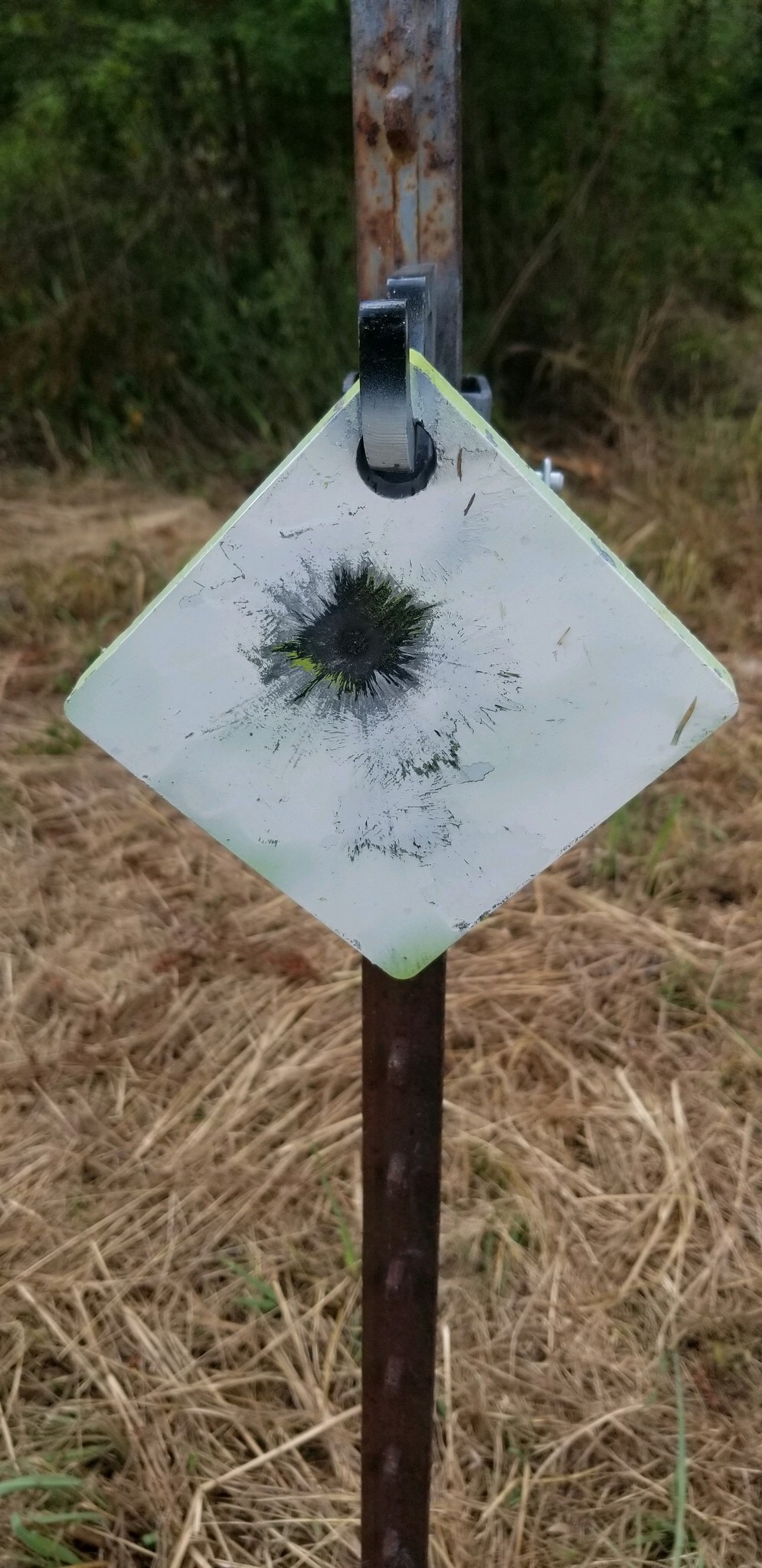

    After getting qualified for the 1000 yard range a few weeks back, I finally made it out there.
    I've been working up a load for my JHR for a while now, and have been very pleased with the results so far.
    Two weeks ago, I took my first shot on the the 500 yard range. (The 1000 yard range was closed that day.) After checking my velocity, I entered the data into my ballistics calculator, set my scope and made my shot on a 4" diamond.
    To say the least, I almost fell off the bench. I couldn't believe it.
    I thought it must be a fluke, but I put 10 more on the head of a IPSC target also at 1000 yards.
    So that was a darn good day for me.
    The next weekend, last Sunday, I finally made it to the 1000 yard range. I just skipped over the 6, 7, 8, and 900 yard ranges and went for it all, jsut to see how how I do.

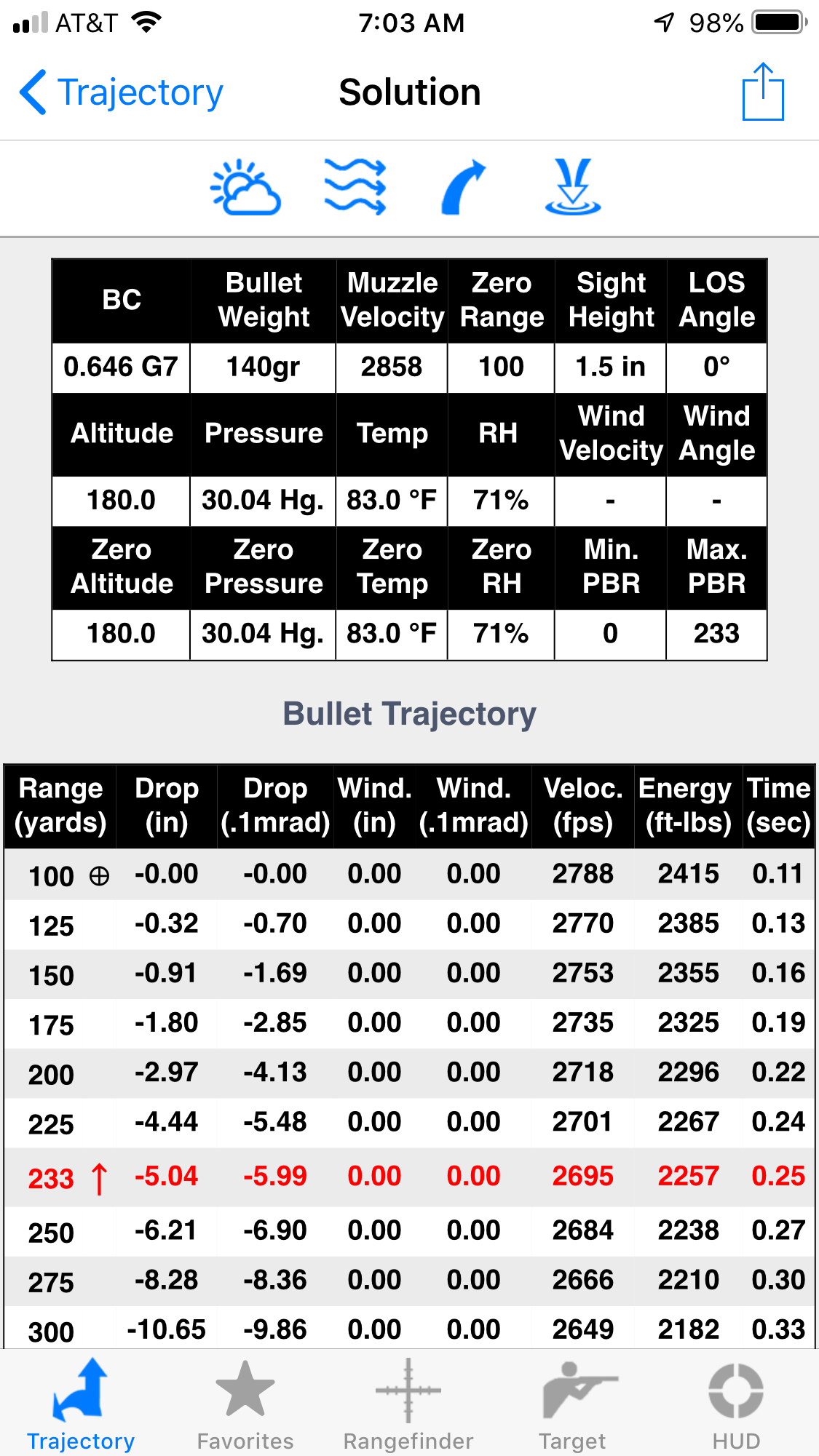

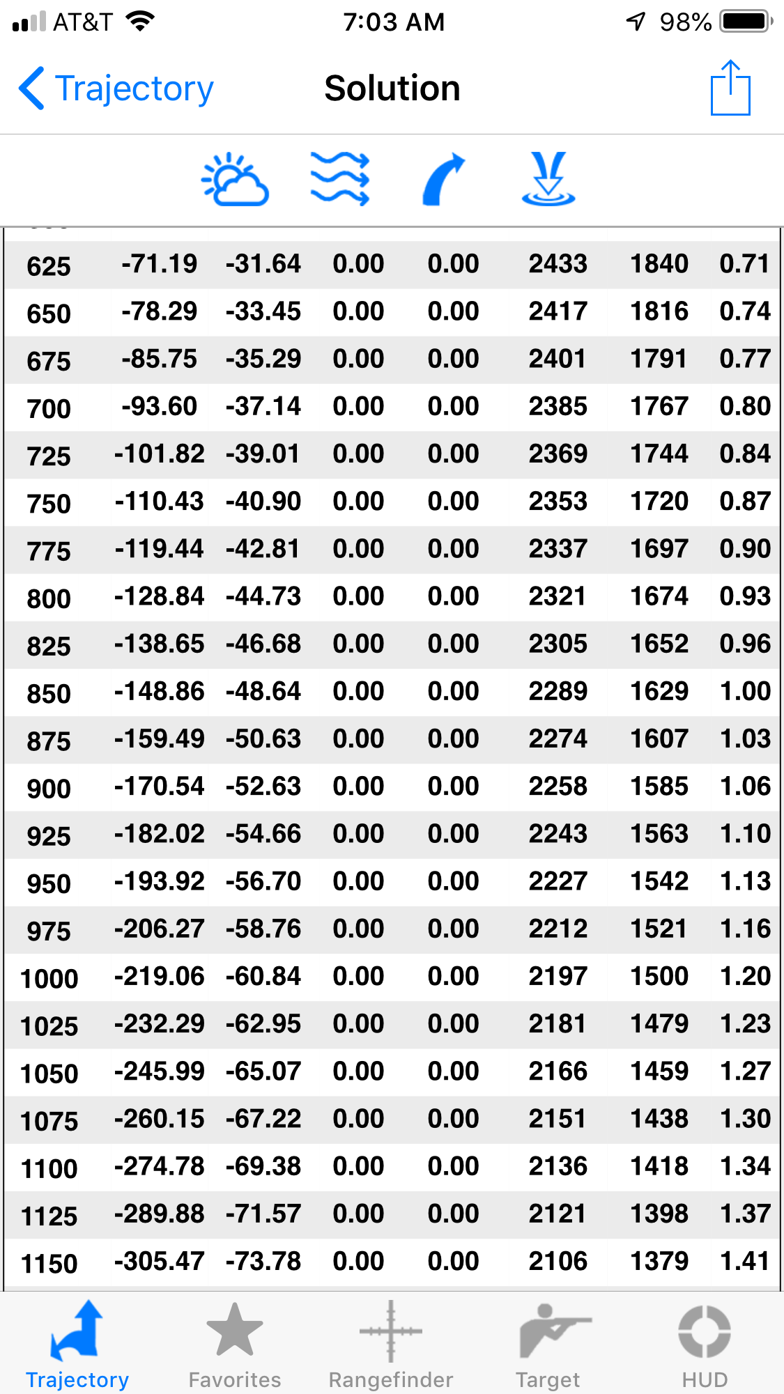

    I checked my velocity, entered it into the ballistics calculator and took my shot. It hit about 5' low. I stopped, checked all my data, and everything looked correct. Took two more shots to get on target. I ended up 1.7 mils higher than my BC said. I haven't figured out why yet.

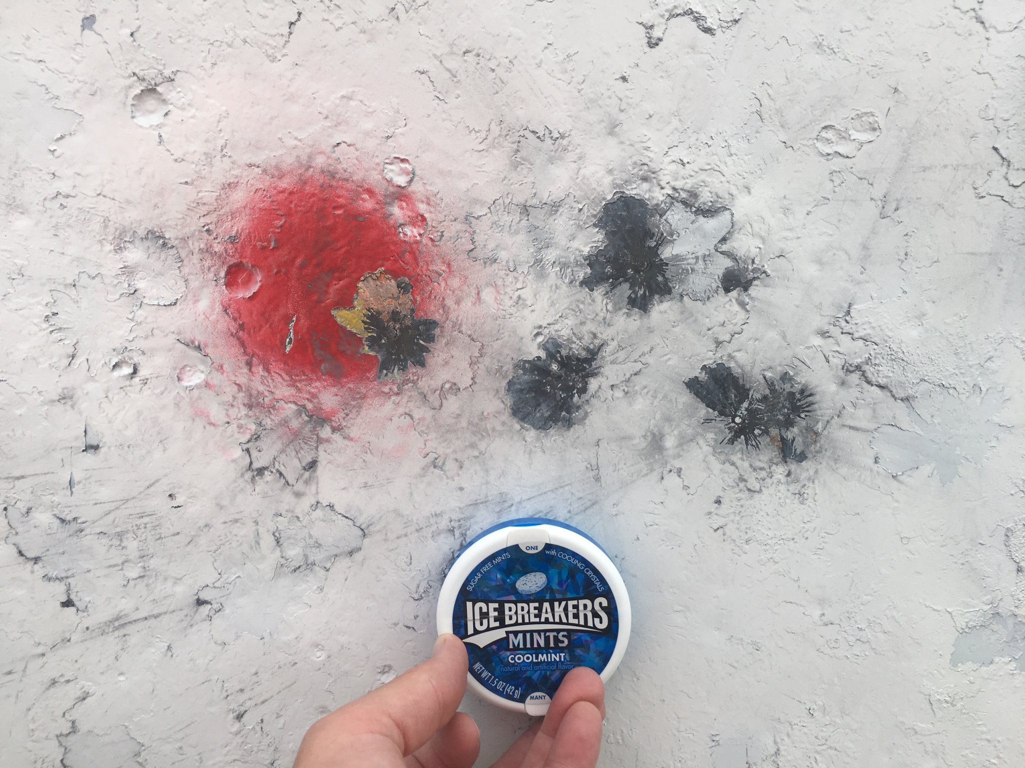

    Drove down and painted the target, came back and shot my first 5-shot group at 1000 yards. There was a little wind, maybe 5 mph, left to right.
    Again, I was very pleased with my rifle and my reloads.
    I forgot to bring anything to measure my groups with, and all I had in the truck was this Ice Breakers cup. It measures 2 1/2" in diameter.
    When I got home, I scaled it off the cup, and got a measurement of just over 5", or just under .5 MOA. Now, I am really happy with my rifle and my ammo.
    Now I need to find out why the BC was so far off, when it was dead nuts on at 500 yards just a week earlier.
    I know I still have a long way to go, and a LOT to learn, but I feel I have broken a barrier that for so long seemed so hard for me to achieve.
    I want to thank everybody here at Snipershide that have helped me, directly or indirectly, with load development, and everything else, to get to this point.
    Now...I get to start figuring out the wind. :D
    Thanks again,
    SH
    cant see the group but sounds like good work

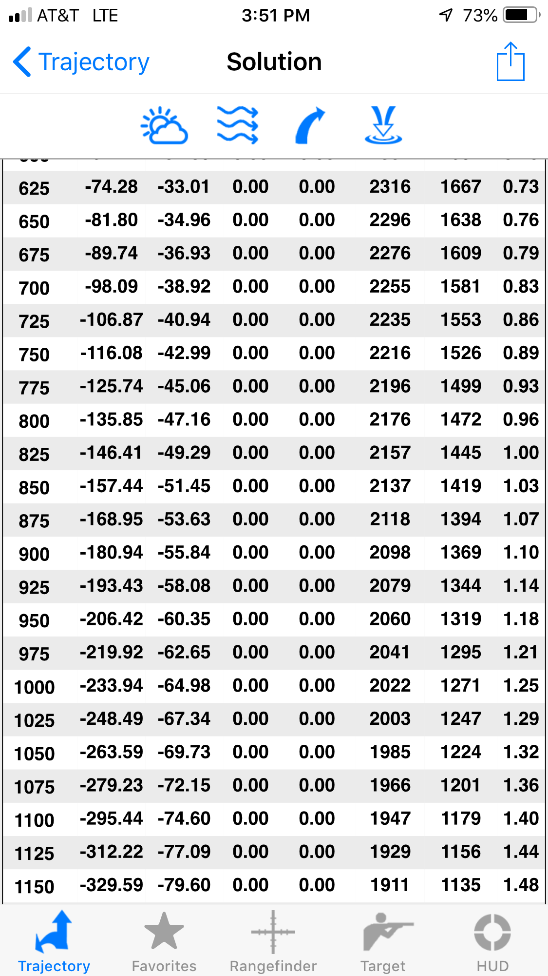

    I’ve looked at the BC, and haven’t found it. All the data was the same, except 2 FPS on velocity, and the weather. I’m using Ballistics AE, and it imports the weather, so I’m not sure what else to check.

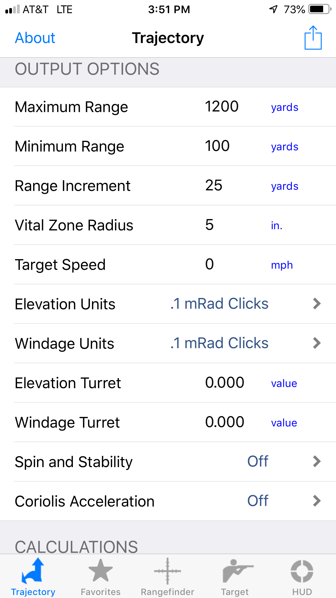

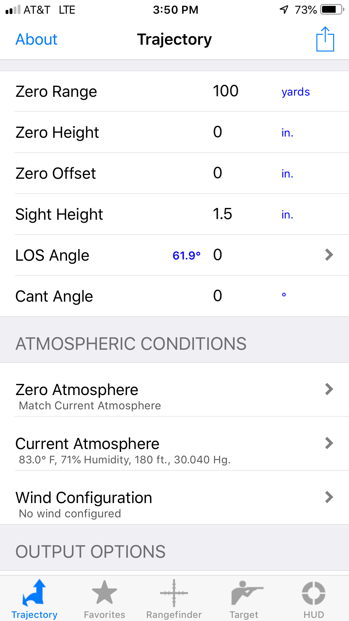

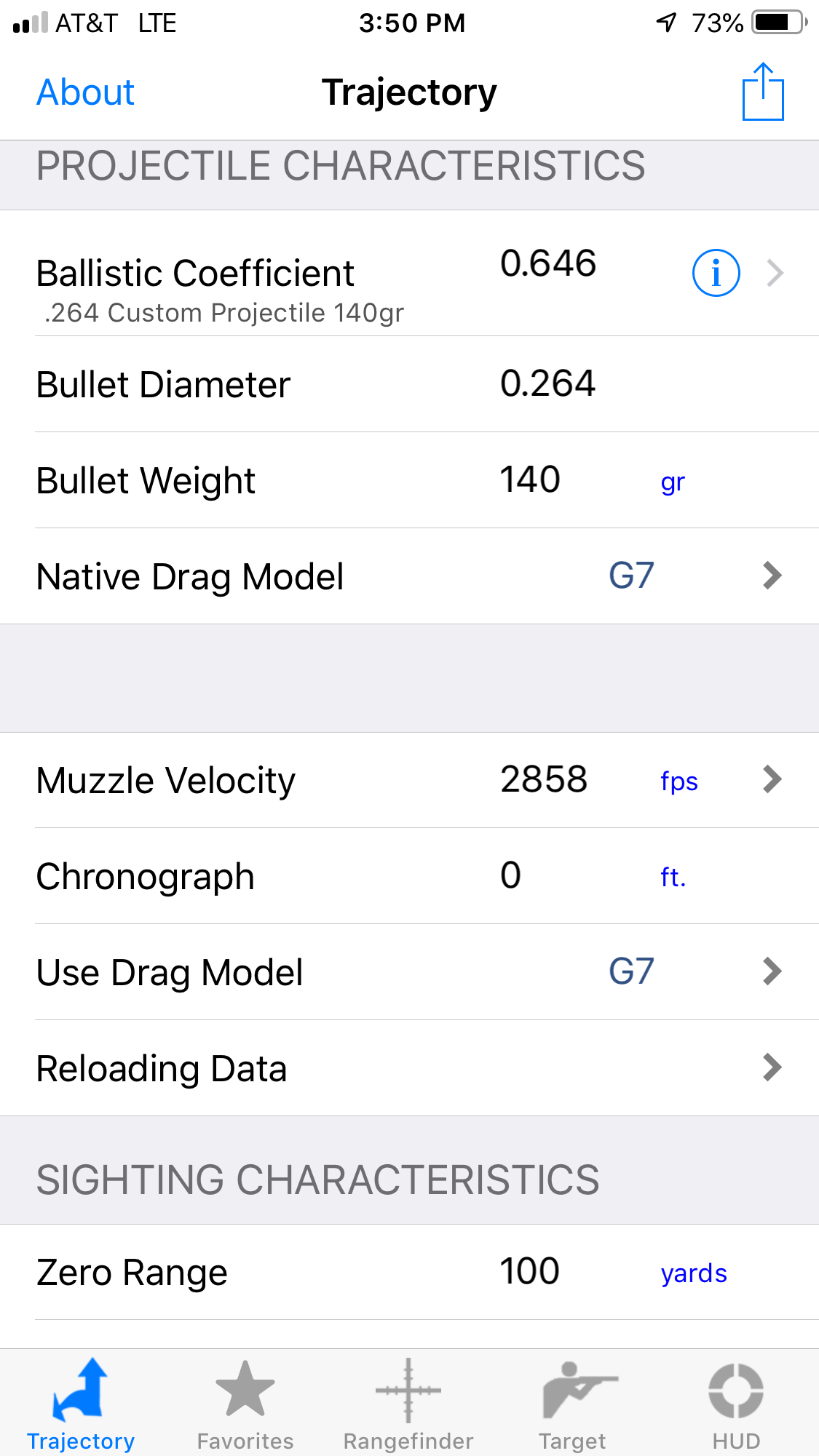

    Here is a screenshot of all my settings:
    I’m going to tinker with it next time at the range. Like Regionrat said, I’ll walk it out a 100 yards at a time.
    Well you had spin drift and coriolis turned off, at 1000yd hum?
    Also looks like a g1 bc is listed but set to use g7 ? Hum?
    Check those I may be reading it wrong.
    Yep, that was it. Changed it from the G7 to the G1, and it put it about 0.1 mil off.
    I’m going to have to play with that, because I had G7 chosen at 500 yards.
    Lots to learn still.
    Thanks Snuby.
    Reactions: 260284 and Snuby642

    Yup, looks good...and like g1/g7 mix up was the cause of error...should be good to go now
    With it corrected, shoot at 500 and adjust velocity until it matches real dope, then shoot back to 1k and adjust BC til it matches
    Small BC changes at 500 won’t matter much but they’ll show at 1k
    646 g1 seems pretty high for anything 140 gain (guessing 6.5) so it’ll prolly have to come down some...most 140 6.5s avg out in the 610-620 range
    That drag coefficient would cause it (although I'd actually expect it to cause more of an issue). You also need to keep in mind that conditions will change hourly/daily, and can have significant impact on your come-ups at 1,000; much more so than say the 500 yards you've been shooting.
    As a recent example, I shot a 1,000 yard F-Class match last week where I had a 1.5 MOA elevation difference between my first and third relay (from ~8:30AM to ~11:30AM). All due to rising temps, changes in air density, and light conditions.
    Unless you're shooting at big (2 MOA) plates, you're probably not going to consistently first round hit a half MOA or even MOA target daily. Even the guys who are in contention for state and national titles drop 8s and 9s on their first couple of sighters. :)
    Kestrels help though.
    The .646 bc came from the bullet in the library.
    Ok...I’m a dumbass. I let the ballistics calculator set the numbers for me, where all I needed to do was pay closer attention to the box that the bullets came in. The bc for a 140gr ELD-M with a G1 BC is .646. The G7 BC is .326. I plug that number into my calculator, and it’s less than a tenth from my scope setting.
    No need for either at 1000. You’re talking .2 or less for each.
    Problem would definitely be the .6+ set at g7.
    Reactions: Srgt. Hulka

    Glad that is clearing up. Just curious, what is the LOS Angle that shows 61.9 degrees?
    I haven't looked into it yet, but I think that's the line of sight to the target. You would enter an angle if the target is up or down hill. The 61.9 just happened to be the angle I was holding my phone at the the time I took the screen shot.

    the LOS angle is 0. lol 61.9 must be your local temp because you would nearly be shooting into the sky at that angle lol. if 61.9 is your temp then i'm jealous. good shooting.
    I will play with bc next trip and try to fine tune it, now that I know what to look at and look for.
    yes the 646 is for the highest possible velocity band, not averaged over the entire curve or scaled in the program...BC isnt a set in stone number...link below explains it
    using the g1 bc in a g7 profile, your dope at 500 should have been off a good .2-.4, but if you hit dead center that means something else is off there and the 646 bc is correcting it as you go out further...something to look into next trip so your curve matches for the entire trajectory
    In that app the LOS angle shown in blue is a live readout of how the phone is being held. He was holding the phone at a 61.9 degree angle when he took the screenshot. The LOS was set to zero so it didn’t affect his dope.

    Try a G7 BC between .312-.318.
    That value always worked well for me and my shooting partners with a few barrels and that bullet out it 1300ish.
    Further than that and you’ll have monkey with it to get a good true.
