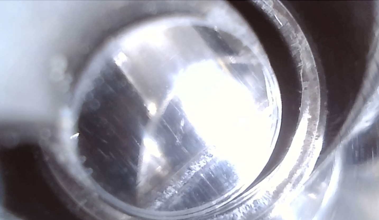

My regime is this:
1. few patches with boretech eliminator
2. few strokes of a Swab-its bore tip with Thorroflush. Let it sit overnight
3. 20 - 30 strokes of thorroclean over a couple of felt cleaners ( I use abrasives always with a strict "hard-on-soft" approach )
4. If it's not squeaky clean ( and usually is at this point) just another twenty strokes of a soft nylon brush with thorroclean
5. Few patches with thorroflush et voila.
This worked 100% of the times cleaning every 300-350 shots ( a full two days match plus fouling session before the match and a 'post-mortem' final test from the bench or a positional training session after)
The only issue I have is still with chamber neck edge. Sometimes it's not squeaky clean as I would like to see and I still haven't find the right tool for the job. I am trying with slightly oversized VFG super intensives but that shit is still too stubborn for those.
Comments and suggestions always more than welcome.

If it’s carbon you’re seeing at the chamber neck edge, I’ve had great success soaking a patch with CLR, putting it over the end of a brush sized for the caliber, and wedging it into the lands. Wait 10-15 minutes, spin the brush in the lands, then pull it back. Clean out the bore and chamber with patches / chamber mop soaked in 99% isopropyl alcohol, then dry patches.
But! That was before I started using Chad Heckler’s cleaning method: soak an oversized bronze brush (e.g., 7mm brush for a 6.5 bore) with Patch-Out plus Accelerator, 20 strokes end to end. Let it sit, hours to overnight, then patch it out. Repeat once more, only 10 strokes or so this time, then verify that the chamber and lands are clean (they have been every time). That’s it. It’s super easy, and I don’t have to spend more than a few rounds fouling. Of course you gotta clean out the action and the muzzle periodically; for me the action is before and after every match, and the muzzle is whenever I feel like it. Every 500 rds probably.
Btw OP, I recently ruined a $1300 barrel with Iosso abrasive paste. It’s clear that people use abrasives with success, but they absolutely can wreck a barrel, as Frank Green has made clear. This mistake is why I switched methods. Good luck!

I didn’t pay much attention to round count, call it 1000-1500 on a ModBB 22BR barrel running a reasonable load. My round count was tracked by counting brass during reloading lol
Cleaning count was less than ten. I don’t count that, but it wouldn’t have been close to ten.
Method: This was under construction with this barrel. I started with
1) C4 wet patches to remove the bulk carbon, then an Iosso patch wrapped around an Iosso nylon brush for 20-30 strokes to remove hard carbon and copper. Would check with a borescope to ensure it was bare metal; started to see what I call a “watery” finish that most people I think call “mirror.” This is distinct from the visible axial striations you can see in a brand new high-quality blank (tiny lines running parallel to the bore, kind of a “brushed” looking finish).
Then I decided to try out the Hornady method:
2) Boretech solvents only, from their podcast not that long ago. Figured they’d know (and have the data to affirm) what worked. I didn’t have Eliminator at the time, so I used C4 followed by Cu2+. Can’t recall if I used bronze brushes during this process. Problem with this method was that it took forever and I never saw a clean Cu2+ patch. 40 patches later they were still blue, and I just can’t spend that much time cleaning.
Tried this method twice and bailed back to Iosso, maybe 1-2 more reps of that. Then as I prepped for a match, the groups were garbage. I tried multiple loads that should shoot and none would.
So now I await a replacement barrel and run my 6.5CM backup in the meantime.
