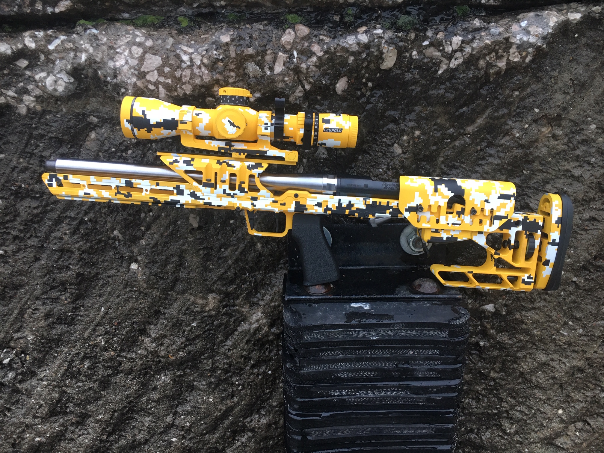

First field test was a success, no big bucks unfortunately. You'll note some black parts that were printed after finding some small changes to make. Below is a rendering of what should be the final form!
Reactions: 10ring1 and Bender
