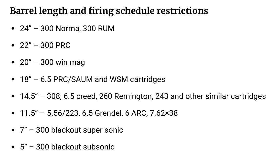

OCL is great but their .30 Hydrogen isn't 10.5" rated. Being Ti I wouldn't run it on a short barrel AR unless it was a low round count.
They are testing a new prototype solid inconel .30 cal HD can for super duty rated use, that they're calling the "Infinity". So far, his IG posts are showing positive results. I'm sure I'll end up getting him to send me one (paid for of course, I don't get free stuff 😂) when he gets ready to drop some pre-production for T&R, or early first-run production cans, out to the masses.
Don't discount the Hydrogen cans. There are pretty damn tough. They're rated for down to an 11.5" 5.56... So 10.5" as long as he times his shots and keeps it under 800ºF, he should be fine. I wouldn't do any mag-dumping though. But the Hydrogen-S is a solid can and would make a great lightweight multi-use can for him. It's a phenomenal hunting suppressor, and one of the best .300 BLK subsonic cans I've used.
@HansohnBrothers has 3 in stock...

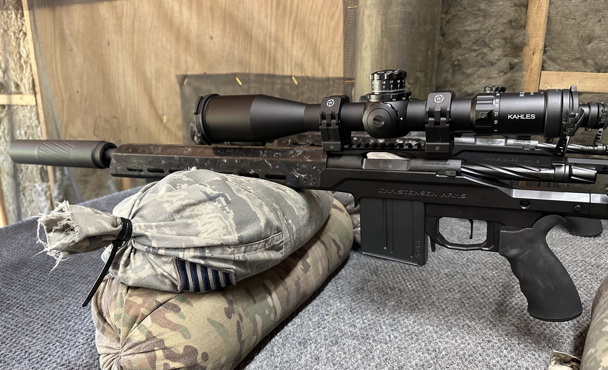

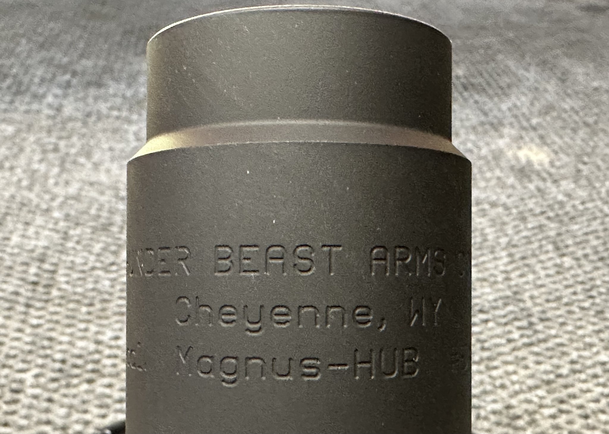

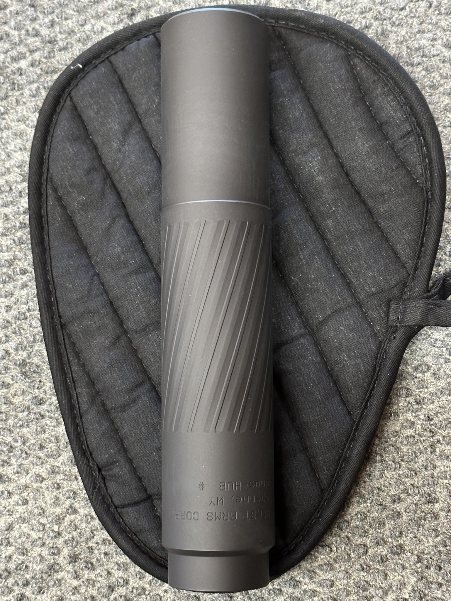

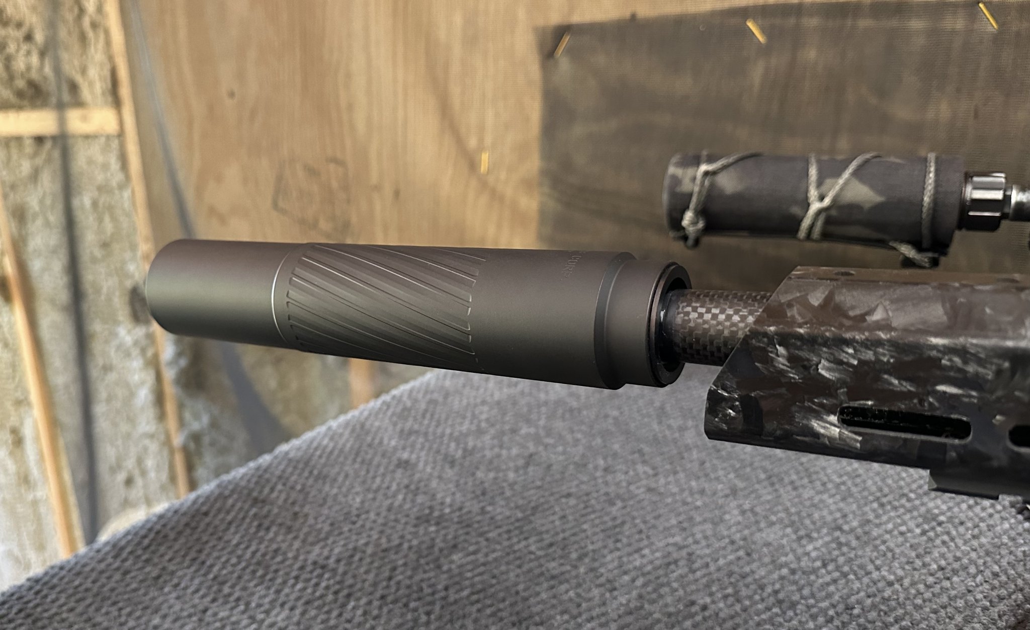

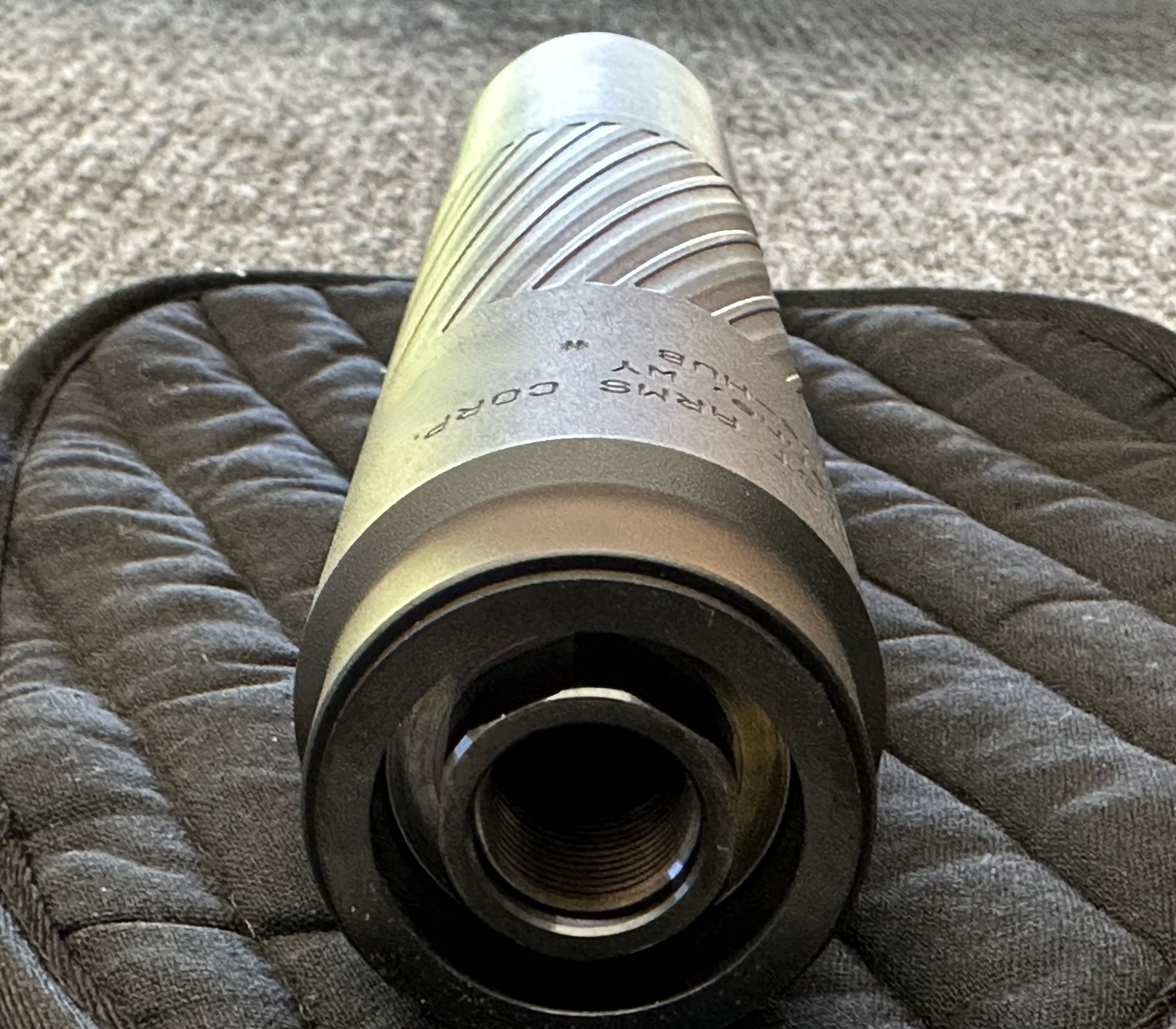

That's why I bought a HUB model Magnus. Plus, it allows me to run my solid titanium OCL ZR0-DTA mounts that only weigh 1.1 oz. and don't add more than 1/16" to the OAL of the can. 😉👍🏼

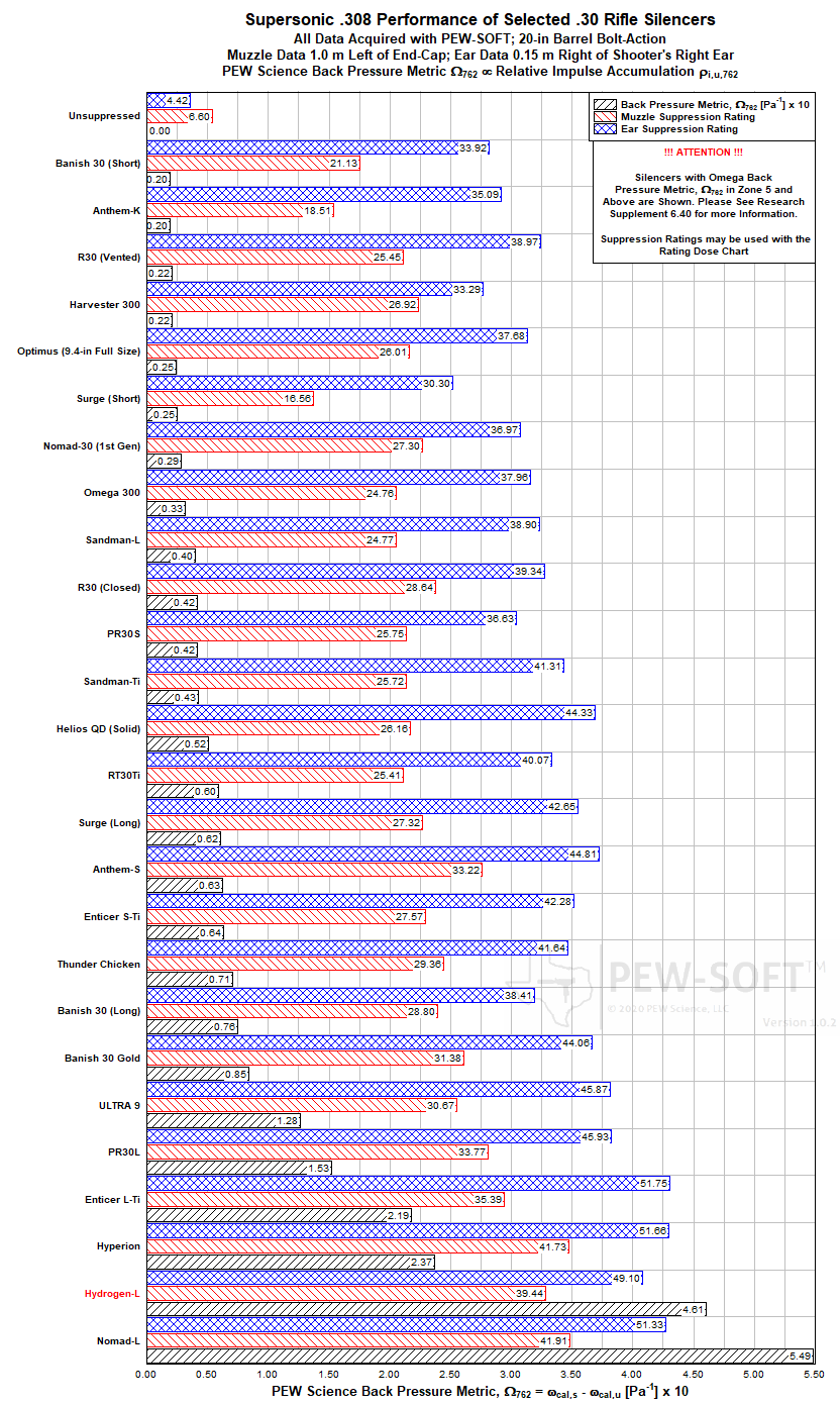

Compare the Nomad 30 to the Enticer line. It's either 30% heavier, doesn't meter as well, and is more expensive. I think the Nomad 30 looked a lot better two years ago. The only thing you're getting with the Nomad is a full auto rating which probably somewhere around 90% of the customer base that buys them as zero need for.
The Enticer line certainly looks appealing if you are looking at products like the Nomad 30. As you point out, on paper they seem to outperform the Nomad at a much better price.
Bonus is that they look like they manufacture their own suppressors, which should be a benefit to the customer for QA/QC and warranty claims.
I noticed you made sure not to post the graph with the Otter Creek Hydro-L in it... Yall joke on me about the OCL cans, but yall are trying to pimp these DD cans hard... 😉
Maybe because it perfectly suits the op's ask.
Hydrogen is a titanium can not rated for one of his hosts. The Hydrogen series is great, the enticer series is also great. Andrew, Diligent and Liberty dudes are all great friends. They all make good stuff.
OP wanted a great budget .30 can. I cannot think of a better option than the Enticer S. It has great suppression, it's only $500, 6.75", has removable end caps with 5.56, 6.5 and 7.62 options and hub mount. Enticer S, tax stamp and Rearden mount W/ muzzle device = the same price of just the Hydrogen S ($850).
